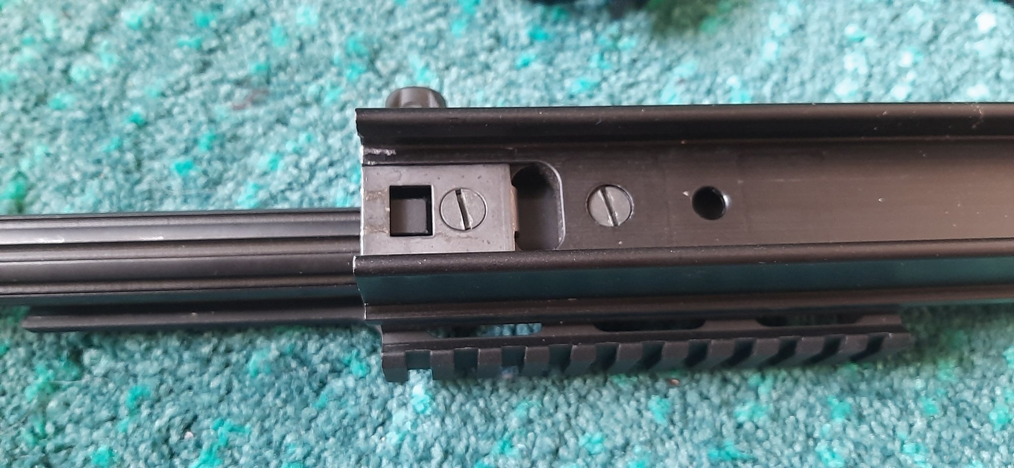

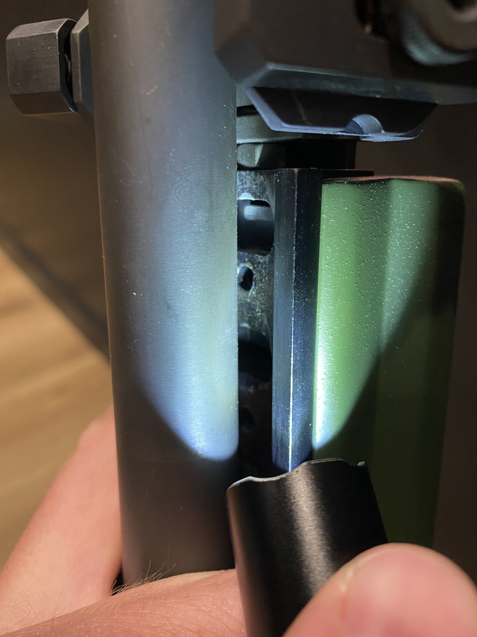

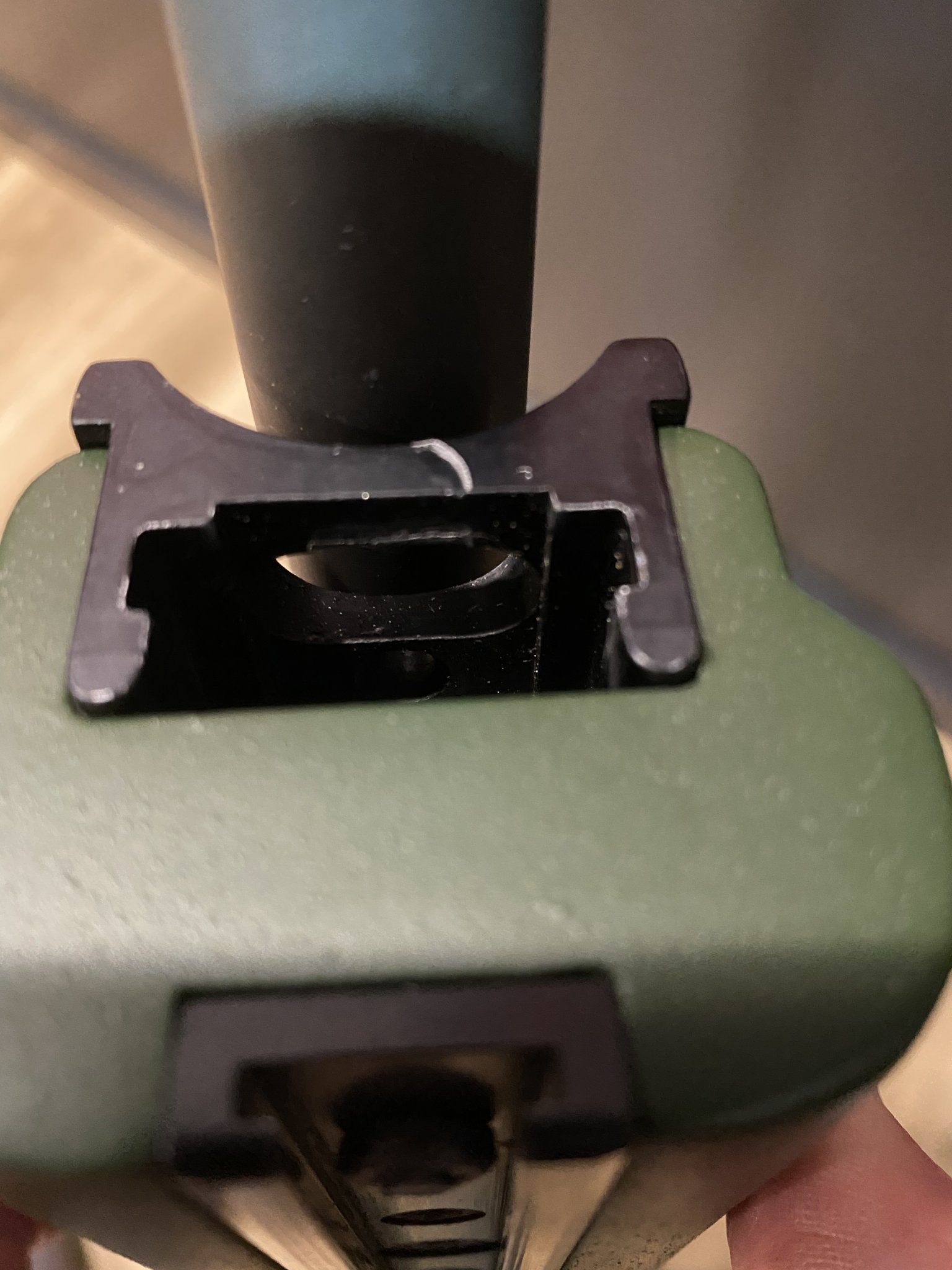

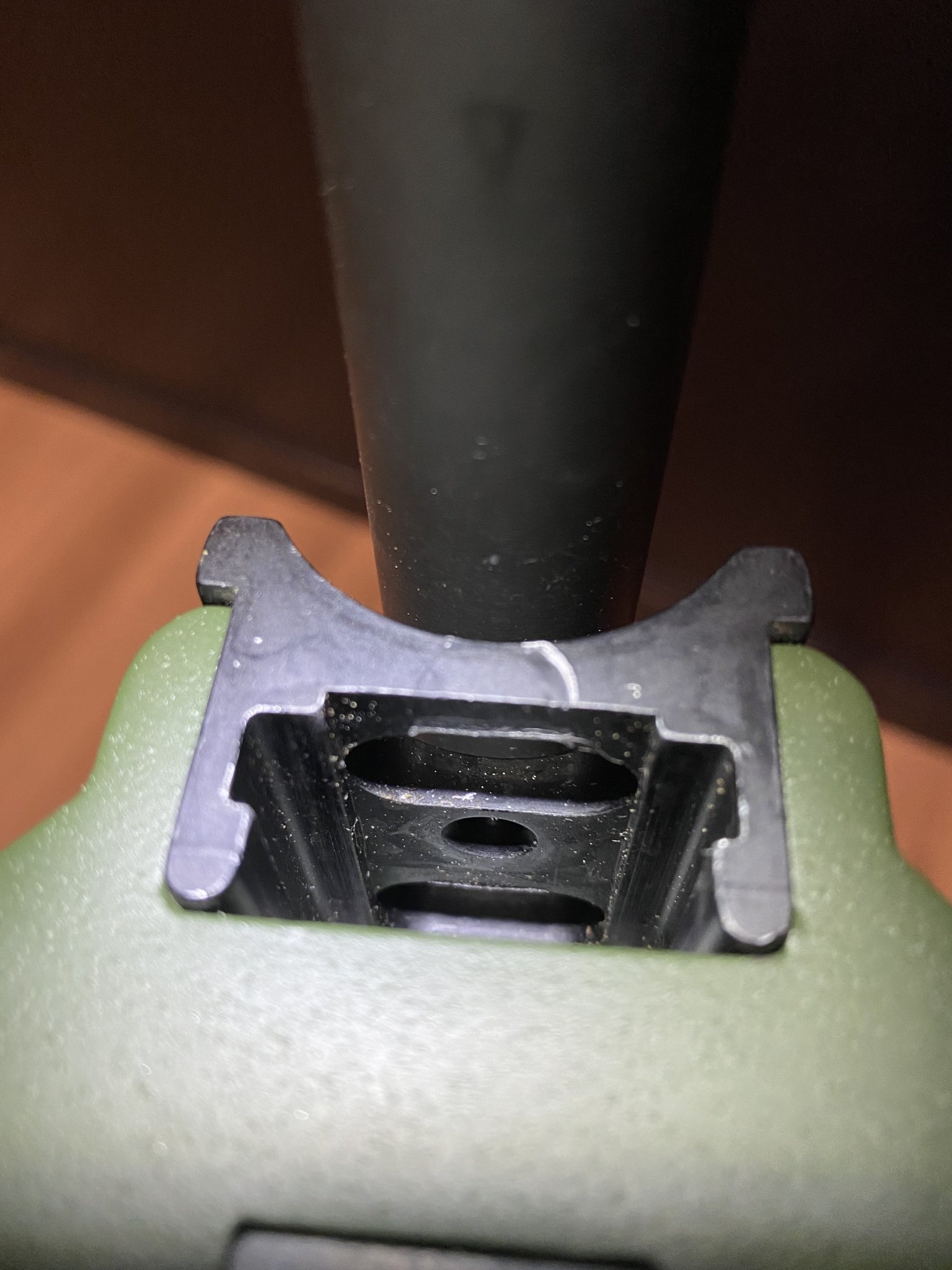

I bought the rifle second hand. It had a spigot attached which I removed because I wanted to use the factory bipod. The latch doesn’t seem to engage -at all- to secure the bipod to the rifle.
Am I missing anything glaringly obvious?

You are missing this little plate. Part # S57467936 base rail reinforcement plate. Should also be doable diy if sourcing the og part seems unfeasible.
Reactions: mr2143
You are missing a little metal plate that stops wear and locks the bipod in.

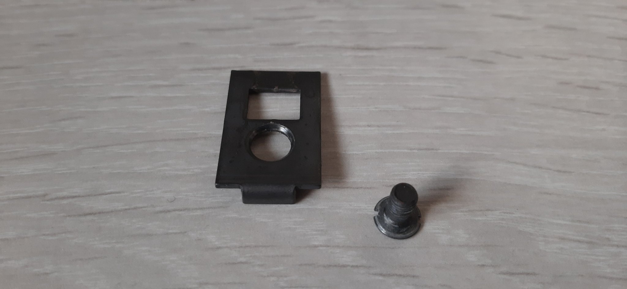

New Trg22 owner here. My rifle came with the picatinny bipod mount which I removed. Now I am in search of the little bolt that holds the reinforcement plate to the aluminum rail. I have the steel plate, but the original bolt is MIA. Do you happen to know the spec on that bolt? I am thinking it is an M7x1mm. I have reached out to Sako as well as scoured the exploded parts diagram. I see the plate listed, but no attaching bolt.
You might try a screw M5x.8 pitch as that is what they use to attach various tactical rails to the chassis front area.
Thanks for the reply. I went to my local Ace Hardware and bought a M6 and M8, both of which didn't work. The M7 is like a Unicornfor whatever reason. Maybe it's a machine screw, I don't know. I find it odd the reinforcement plate is on the exploded diagram but not the bolt. It'd be nice if I could drag in my gun to the store and start sorting through bolts. I'll post back here when I get it sorted.
The TRG-manual states it as a M5x10 and the screw I pulled off a backbone measures accordingly. Don't have a thread comb but I would guess that jet_lagged is correct with the 0,8 pitch.
