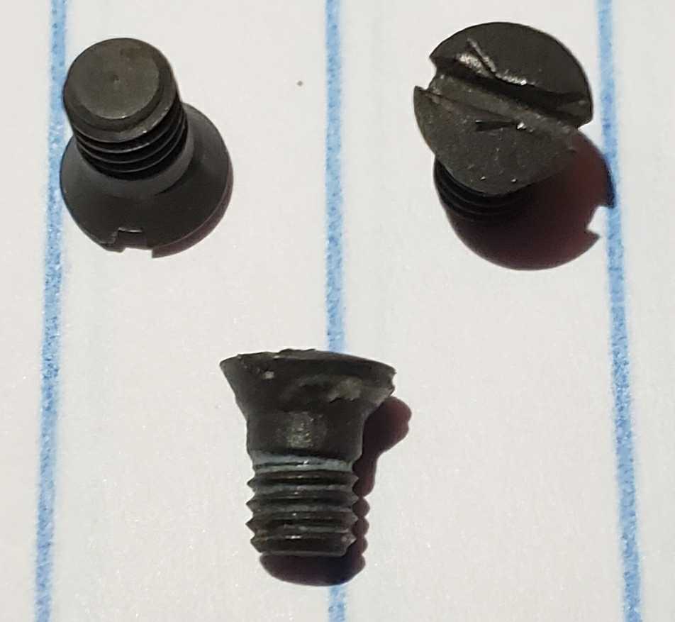

Bottom line was that I wanted new screws to install my factory Sako rail. From the previous posts you can see that this requires M3.5 screws and that the ones I had that needed replacing were 6mm overall length with a flathead drive (also I was short - I only had 3):
I bought the rifle used; it's a 2017 TRG in 6.5CM and I'm told the rail was original to the rifle (it does fit perfectly) but cannot be 100% certain the supplied screws were original. But I do THINK they are based on my research and the matching thread locker/epoxy I found on the screws/rail/rifle. In any case - the challenge is that in general, M3.5 screws have heads that are too large to sit in that rail. Well - good news, EGW makes torx drive screws that work. Buy the screws that come with the rail linked below and shorten them to 7.0-7.3mm overall length and you're in business:

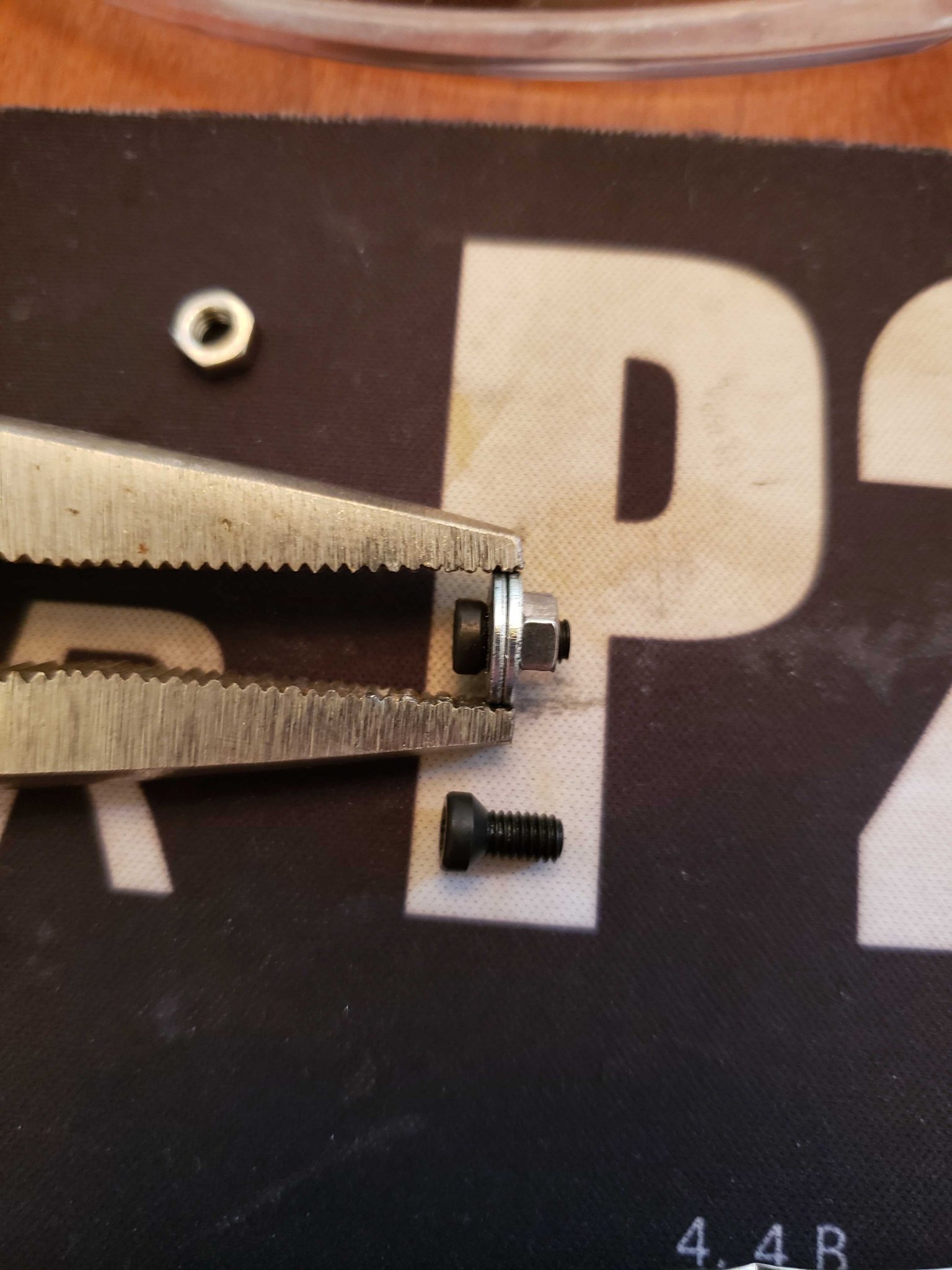

Of course I needed the screws; I also used some locking pliers and this 10 pack of really nice stainless M3.5 nuts:
So what I did first is brainstorm on how I could reliably and consistently shorten the nuts without too much user error. I decided I wanted to cut off the ends of the screws flush with the nuts - they would be my guide and they would protect the threads. But this meant I needed to be sure the nuts were in exactly the right spot.
So I grabbed my original screws and played around a bit - long story short I found that If i placed two #6 washers and then threaded on the tiny nut, I was nearly flush with the end of the screw.
I then did the same with the new screws, tightened a bit, and the result is a clearly defined bit of screw to grind off (you can also see a 'naked' EGW screw below):

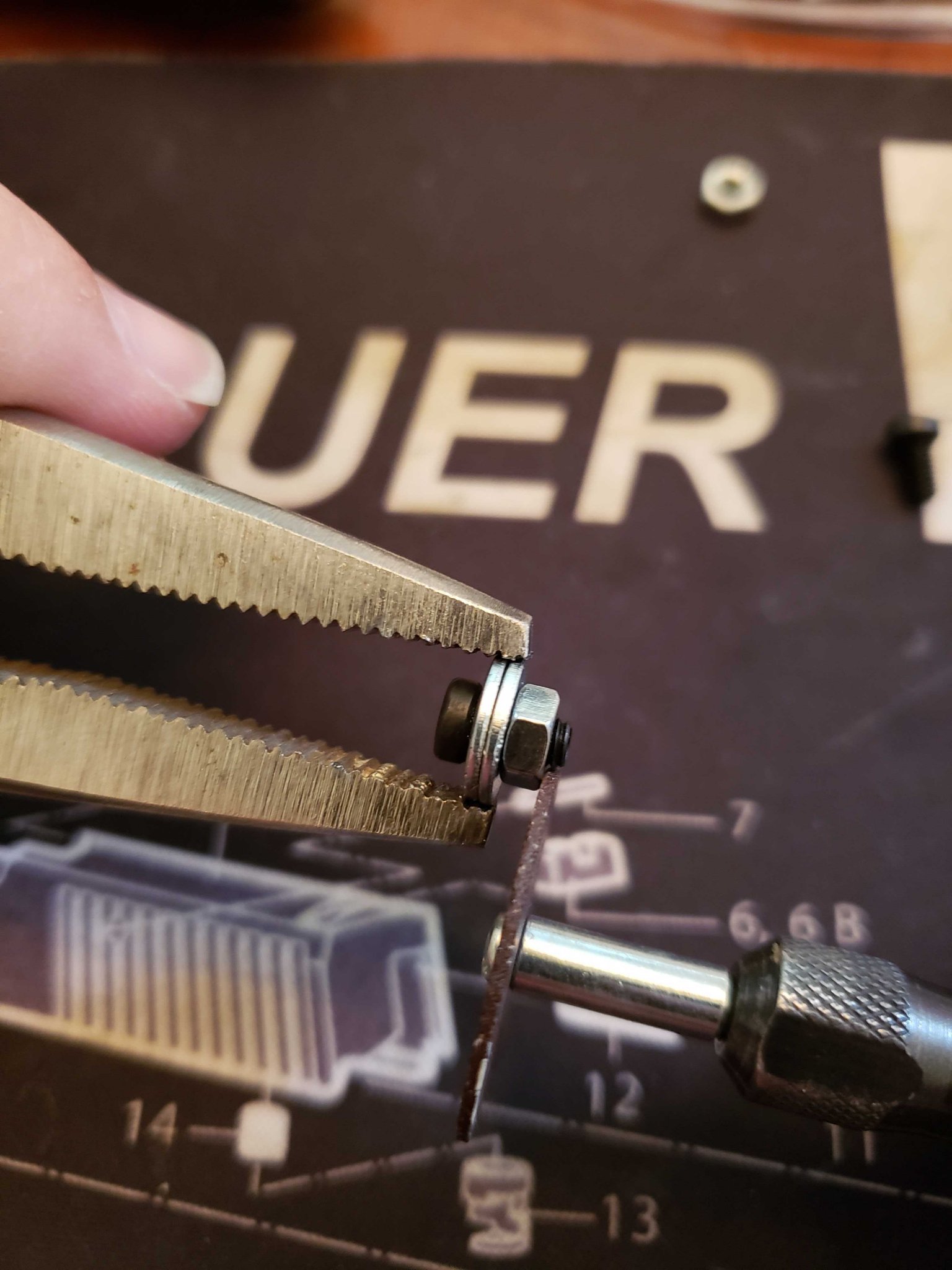

I then took a cutoff wheel to the screw, using the #6 washers as a way to grasp the screw while cutting:

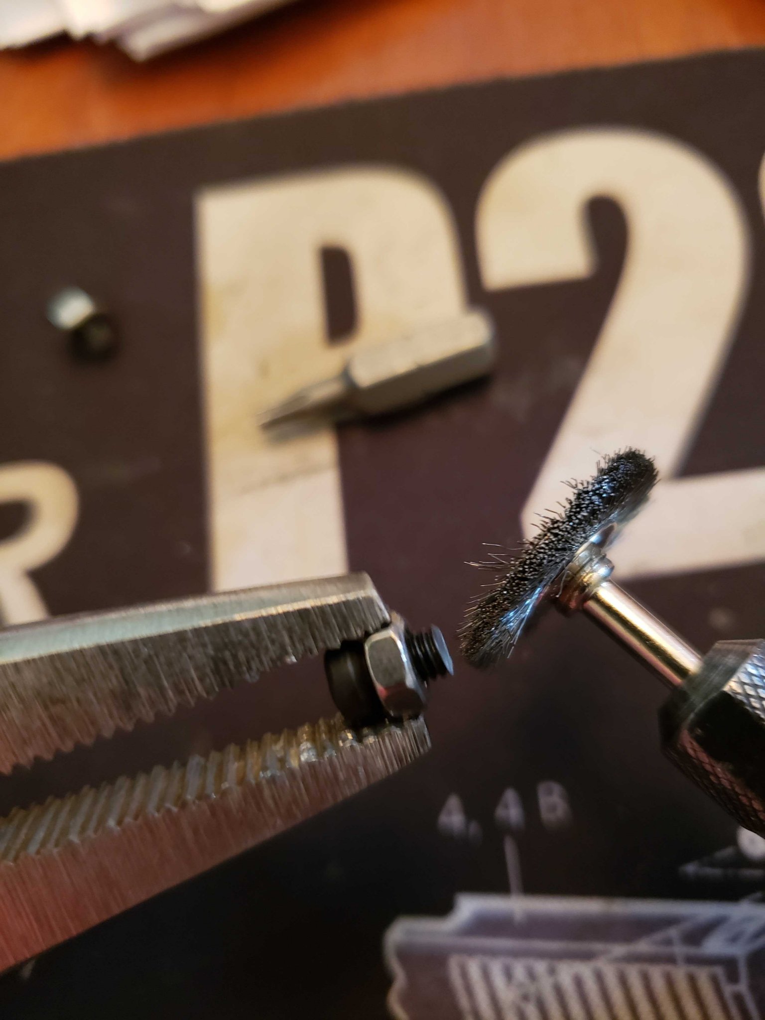

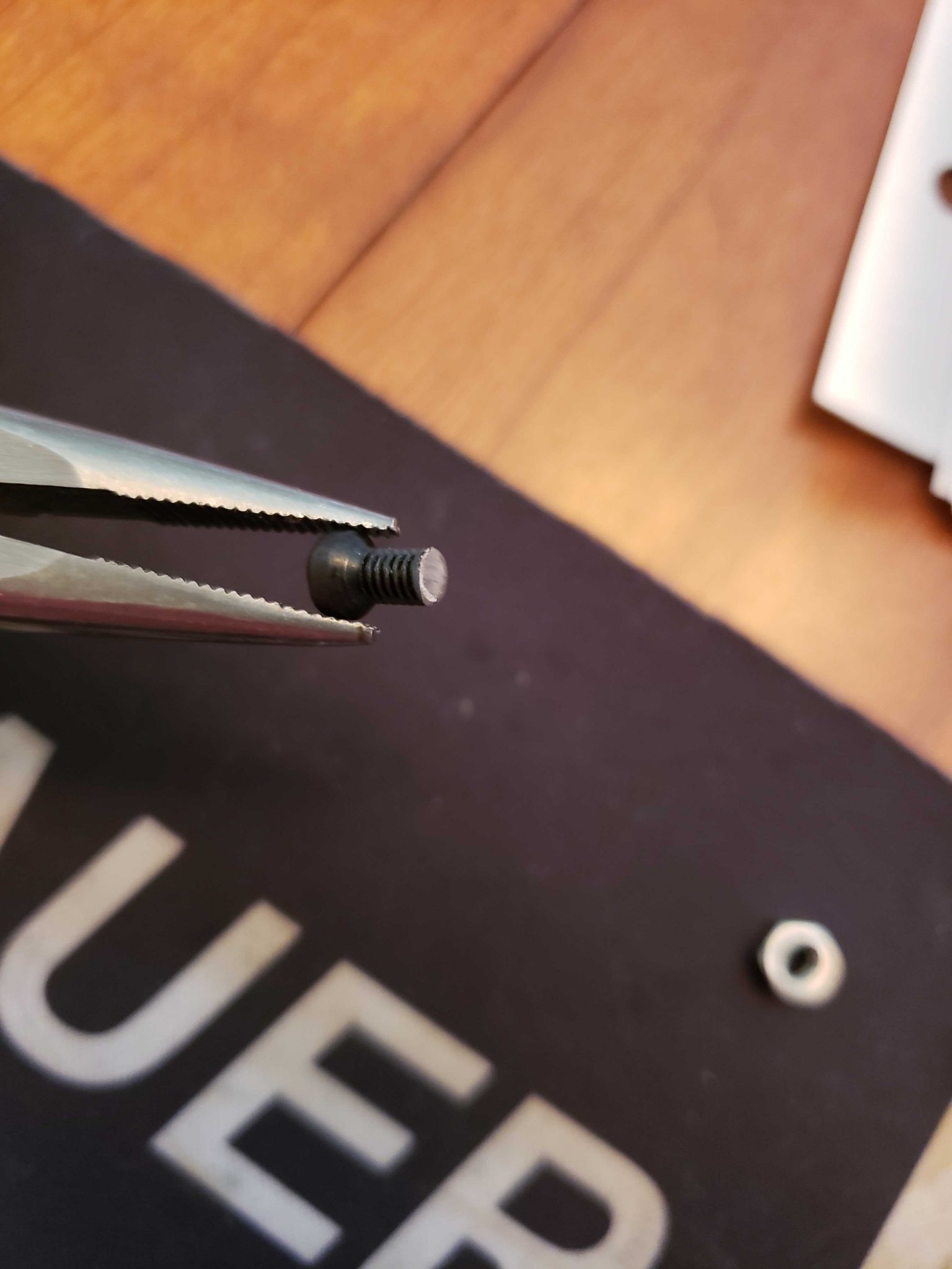

I was then able to use the side of the cutoff wheel up against the end of the screw and the nut to ensure a smooth surface without having to worry about thread damage or putting an angle or bevel on it. Removing the bolts took off any burrs (there really weren't any) resulting in this:
A minute or two with a wire brush and the speed turned down on the dremel to about 2 to smooth the edges and I was done...testing with the nuts revealed no catching and no thread damage:
