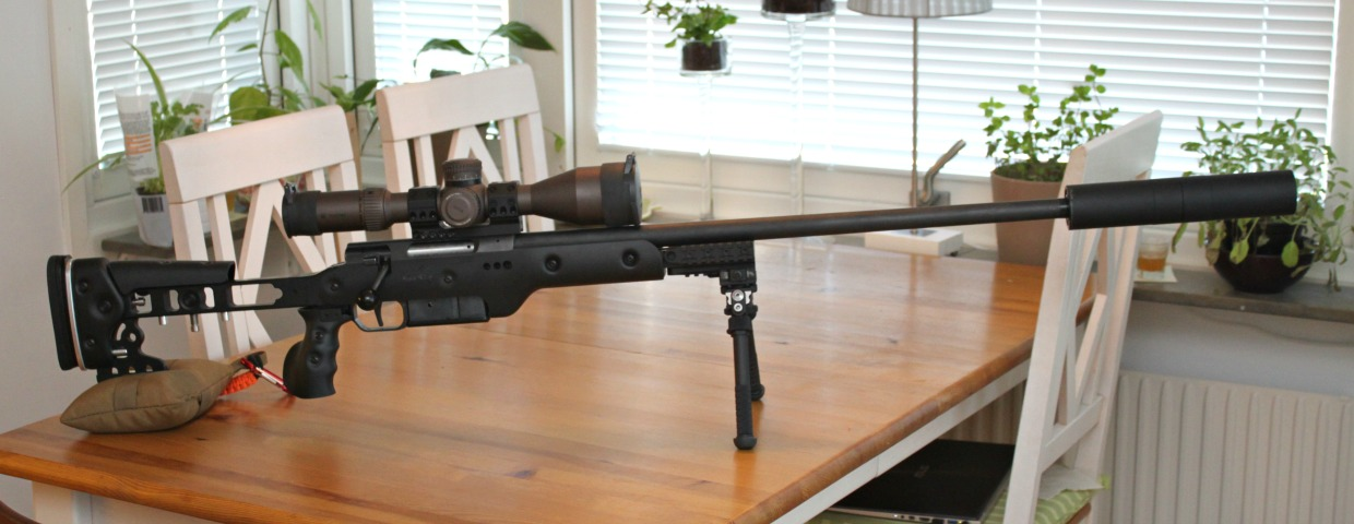

About 2 years ago I got myself a Sako TRG 22 in good old 308 winchester. I had an itch for one for a good few years before I got the opportunity to get one for the right amount of money. Its souped up with the KRG folding stock, Spuhr ISMS scope mount, various KRG bits and an Ase Utra SL7 BL suppressor.
To me, it has the best trigger of any precision rifle out there. Its crazy accurate, and I have hit steel out to 1100 meters with it. I would not say its better than the STR/SSG, they are just as good. But I like the TRG more personally. Even if everything Sako is (stupid)expensive and it is not as user friendly as the STR/SSG is. Everything about the TRG just feels the way things should feel, you know?

The Bolthorn also had the 3 holes on the side of it. Here is what mine looked like a few years ago:
