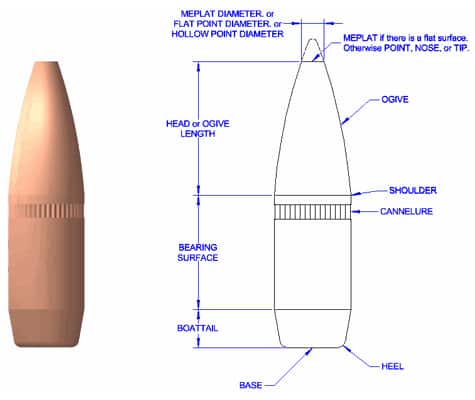

Your seating die is not seating at the ogive. Also the ogive is likely going to be in a different place on those two bullets. Yes they are both 140gr Bergers but they are different. Use your comparator to measure from the bullet base to the ogive on both of those bullets. I'm betting there is about .050 difference.
Reactions: Rh0dz
Totally different profile on the bullet
This. Remember, the ogive is the entire curved part of the bullet between the point where bore diameter ends and the bullet tip. Your seating stem will contact the ogive at a point on the bullet equal to the inside diameter of the tip of the seating stem. The point on the bullet ogive that equals that specific diameter will be different for different bullet profiles.
