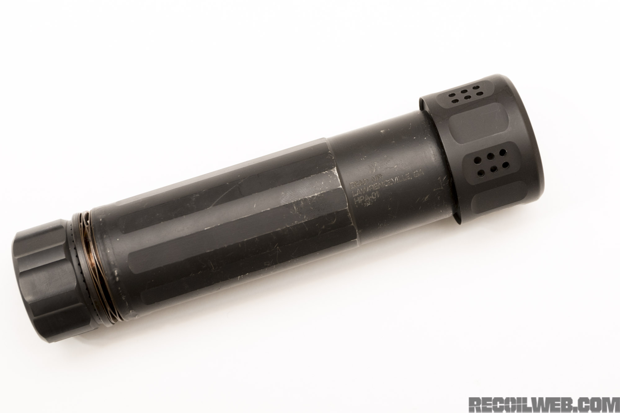

Weight and diameter are the big differences which come from the materials used in construction. The Sandman S is 17.7 oz and thinner where the Nomad is 14 oz (in direct thread). You can add the KeyMo adapter and the Nomad will be about the same weight, just larger diameter. The Nomad is just a touch shorter as well. The image below from Recoil is about the best way to visualize the difference. Sandman S with the Nomad version of the E-brake on it.
If you’re not shooting FA/SBR regularly the Sandman is a bit overkill in my opinion. Sandman has a Stellite baffle stack in a tube and the Nomad is tubeless 17-4 baffles. You’ll be fine with the Nomad but be aware it comes in direct thread config and you’ll need to add a keymo if you want that capability.
Suppression wise the Nomad is between the Sandman S and L. The Nomad L is pretty big but the suppression is impressive.
