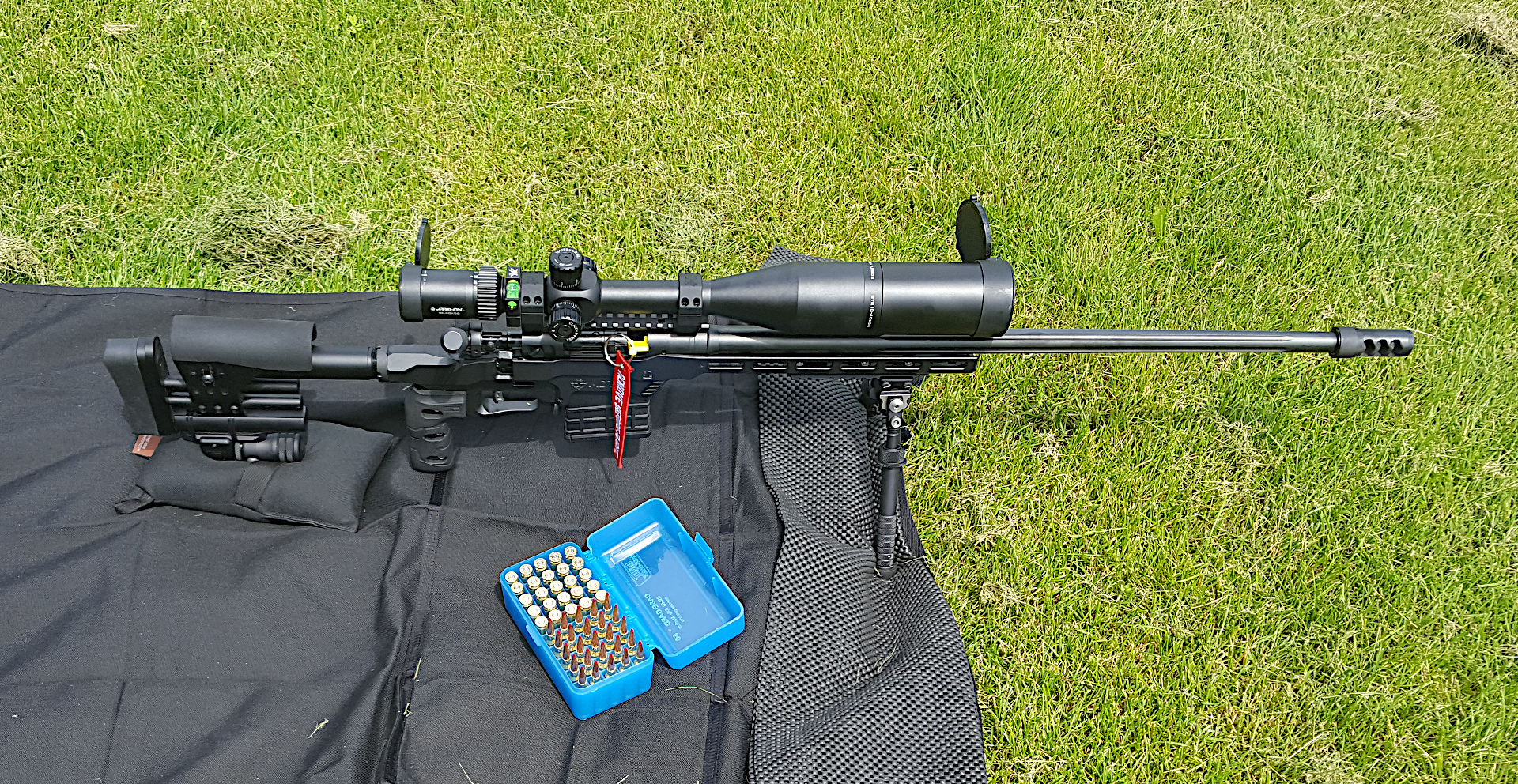

My heart throb rifle is a Savage 10 FCP-SR Tactical...it now lives in an MDT LSS-XLGen2 chassis.
Depends on what you want. I'm an MDT Whore and a Savage Whore so take my opinions with a grain of salt. MDT has the best stuff for Savage and they have "drop in" chassis for the Savage 110. Literally a 10 minute upgrade.

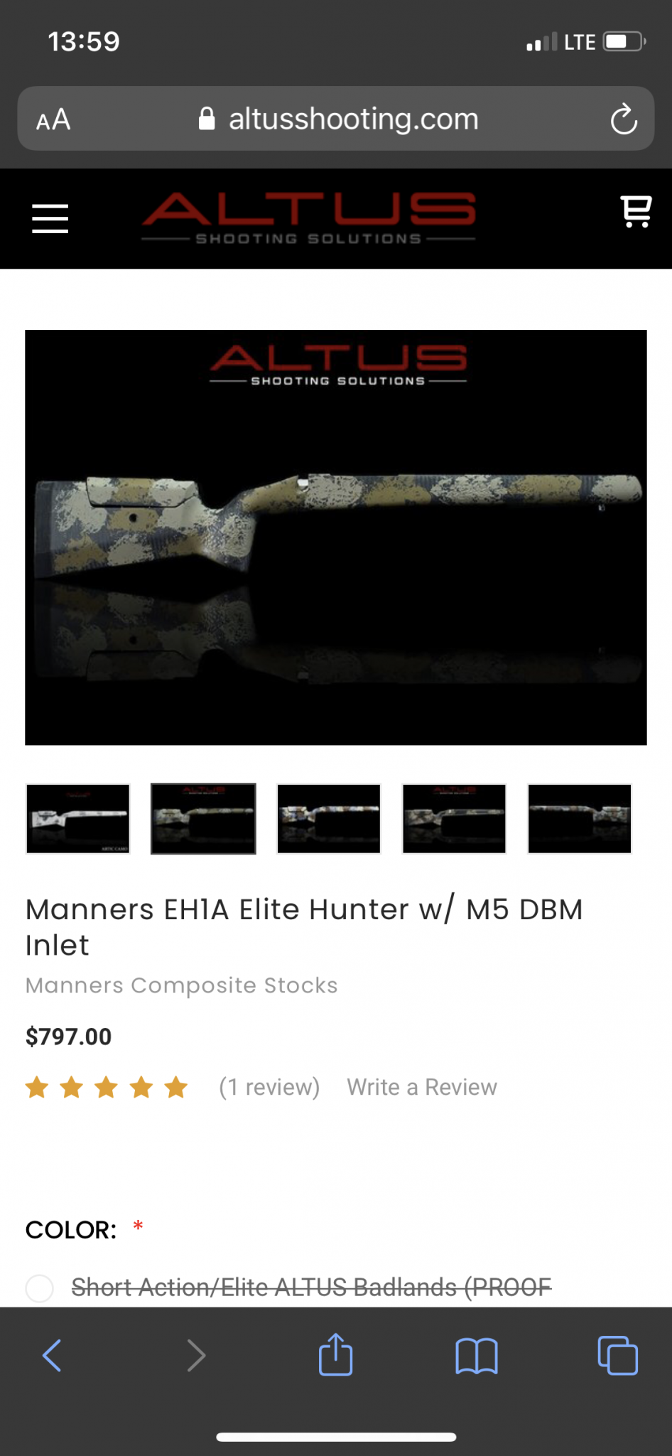

that looks good. I found one for 800ish. It’s the Manners EH1A Elite Hunter W/ M5 DBM Inlet. I just couldn’t find, for sure if my rifle would fit this stock.

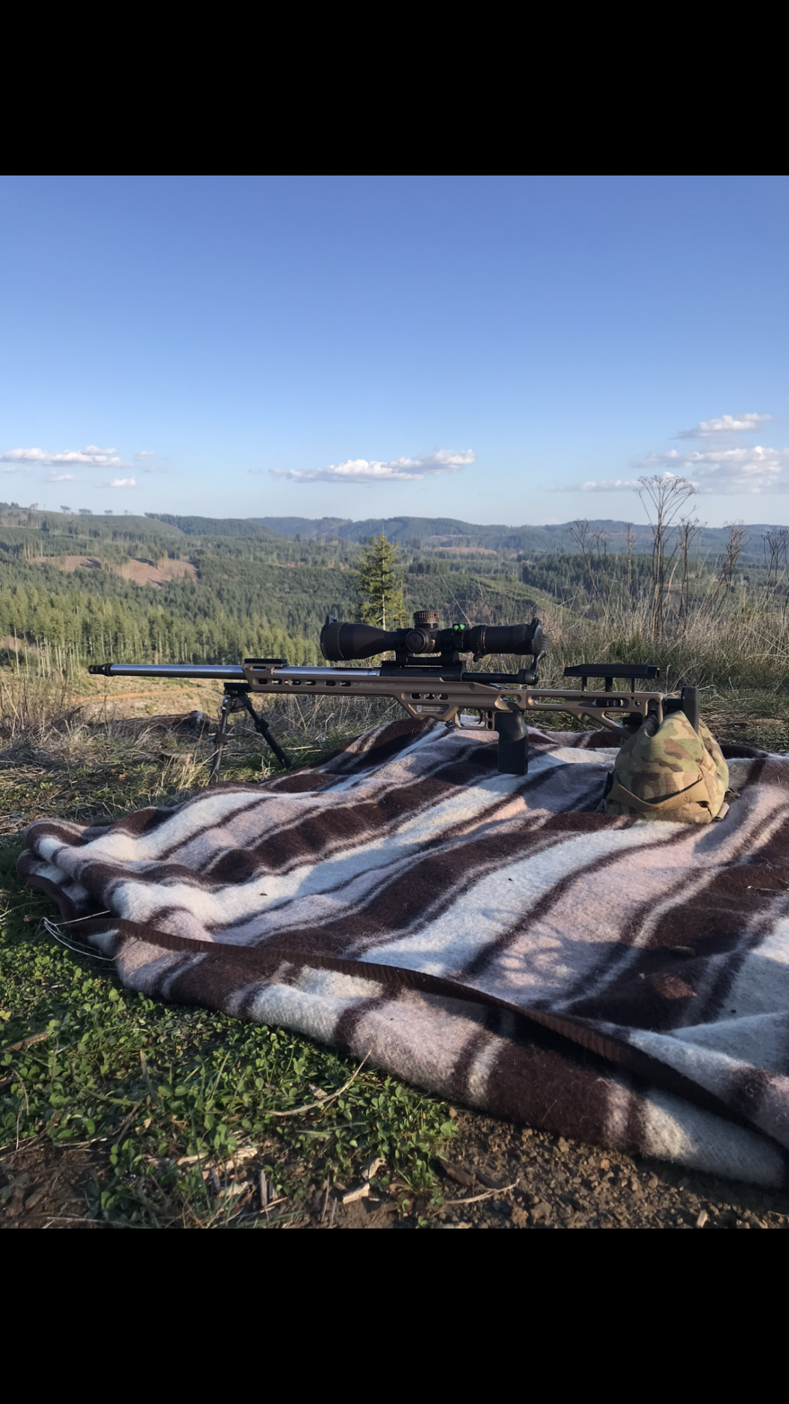

I've been searching as well but in my case for Long Action. MDT has the most and best options including the Oryx. I've seen a few AI chassis that were inletted but that may have been custom. Cadex has a couple of options and XLR and KRG as well for the short action only.
Reactions: BamaBrad

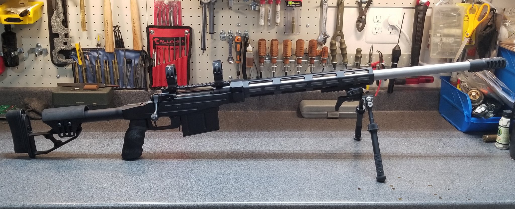

No. 7 28" Shilen match select barrel, shouldered, no barrel nut.
Witt clamp on brake.
Timney trigger.
Bolt lift kit.
XLR Element chassis.
XLR mercury recoil reducer, this helped balance out the rifle due to the heavy barrel.
I haven't had it out since I put it in the chassis, still looking and putting off buying glass.
