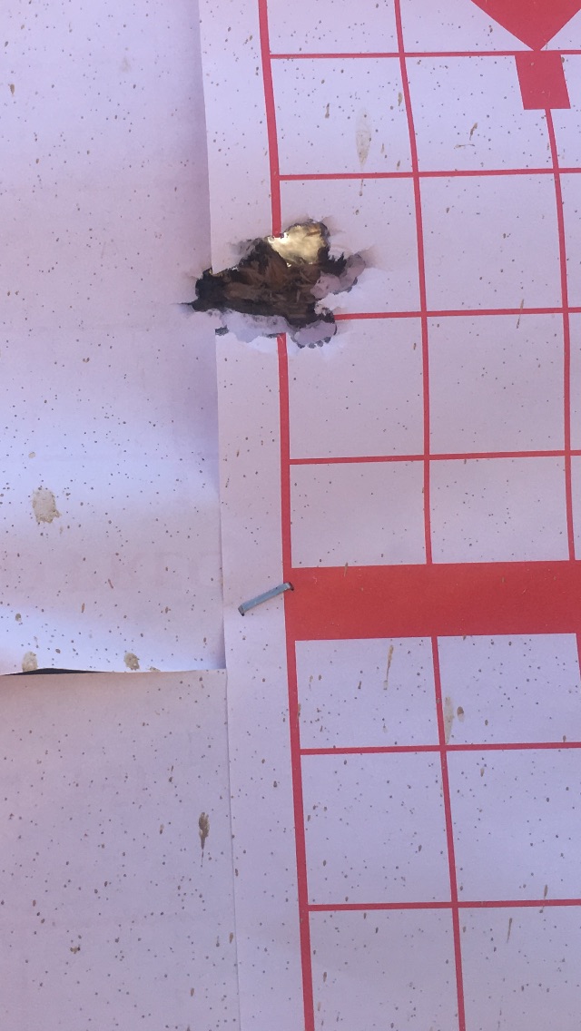

I've had one for a while and it is easily one of my most accurate rifles i own. Consistently .5 Moa with hand loads. Price of your reloads really depends on your recipe. The cost of .338 bullets vary greatly depending on your intended use. I'm shooting hornday 285 ELDM. You should be able to roughly work out your cost once you have selected your bullet and add the cost of 85-90 gr power and a primer if you already have brass.

To the OP, I have similar but a 338 FCP 110 and it put shots 7 thru 9 of its life inside of .6" @ 100 yrds using factory Lapua 300 Gr Scenar. The first 6 shots where all sub MOA as well but I had been scrubbing the barrel between those shots so was still pleasantly surprised.
