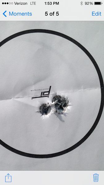

Goddamn... That is a hell of a lot more accurate than I thought it would be! I may have to build one of those myself!
My results may not be typical? The fat stubby barrel is stiff, that's gotta' help. There's VERY limited load data for this cartridge, and lots of combinations yet to explore. QuickLoad is your friend here. I got lucky early in the load development process with this particular barrel and load. There's still likely years of work to do still as it isn't super popular and there's almost no industry support. SAAMI approval would help but who knows if or when.
