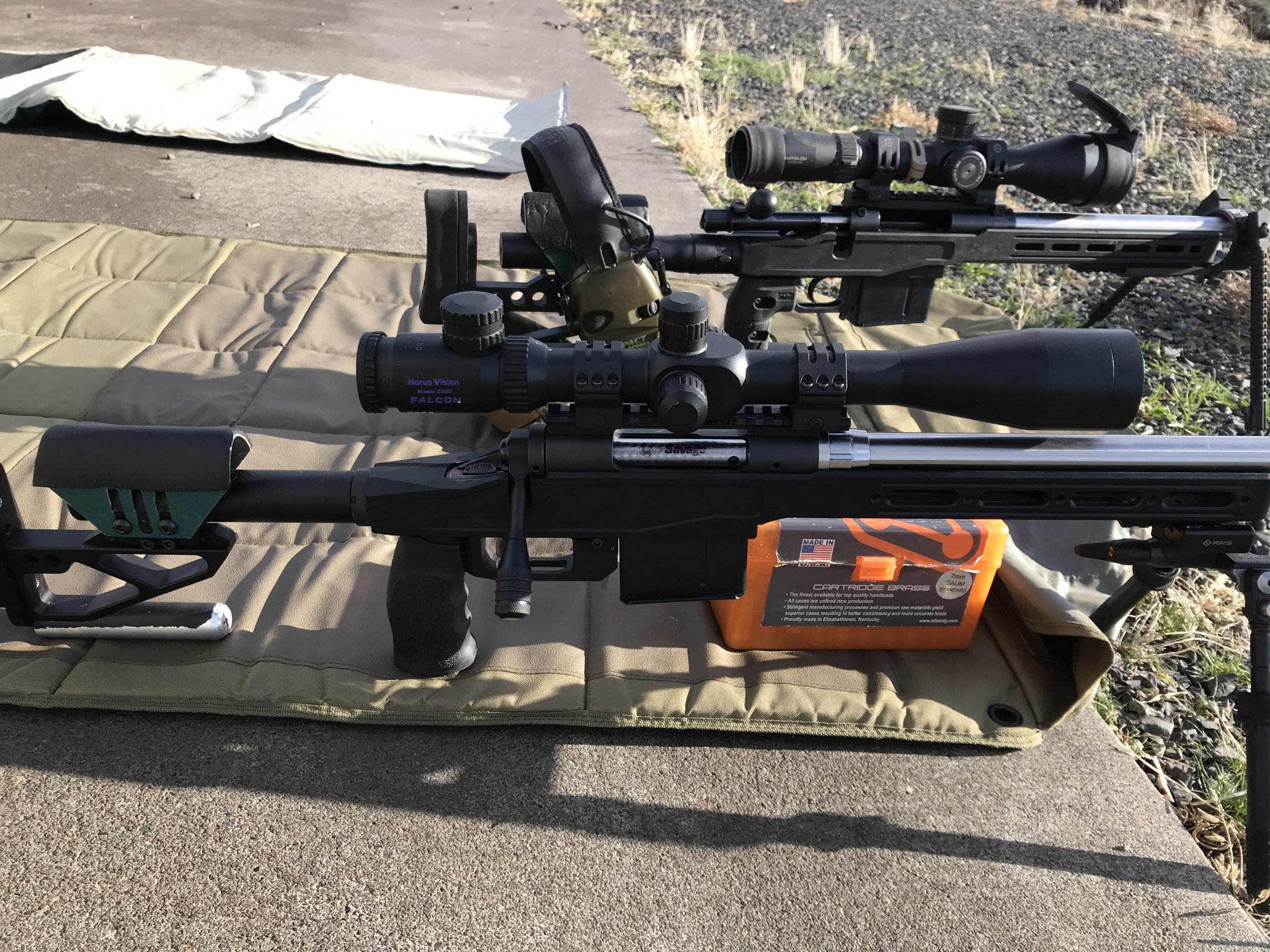

    After about 10,000 rounds my model 11 had tragic ejection and occasional extraction issues.
    I had tried to clean thing up, stretch a spring and install a larger detent ball
    That kinda helped but ejection was 25% at best and that’s being Optimistic.
    That action basically was a barrel and lugs and you had to pull the case out manually.
    I got one of the many upgraded bolt head parts kits from Tactical works.
    Just installed it.
    WOW!
    It’s never grabbed and kicked cases like that!
    I should have done this long ago.
    Now I have to upgrade that captain caveman optic.

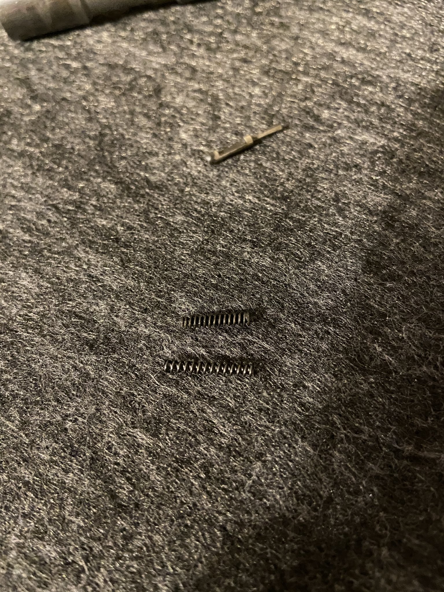

    Mine was having issues after only 1500 rounds.
    I ordered just ordered and installed the kit from gun shack. Had I known before hand that a site sponsor sold the kit I would have got it from them.
    anyway, it will now fling those empties right out of there. Old spring vs new
    Reactions: Steel head
    anyway, it will now fling those empties right out of there. Old spring vs newView attachment 7237990
    their target trigger spring is pretty awesome as well.
    My bad as I didn’t realize my sources was a site sponsor.
    i ordered the target spring as well. however after further inspection someone some done some funny business with the trigger. Not stock configuration. It shoot wells through. No take up, breaks very crisp and light, so I’m just gonna leave it for now
