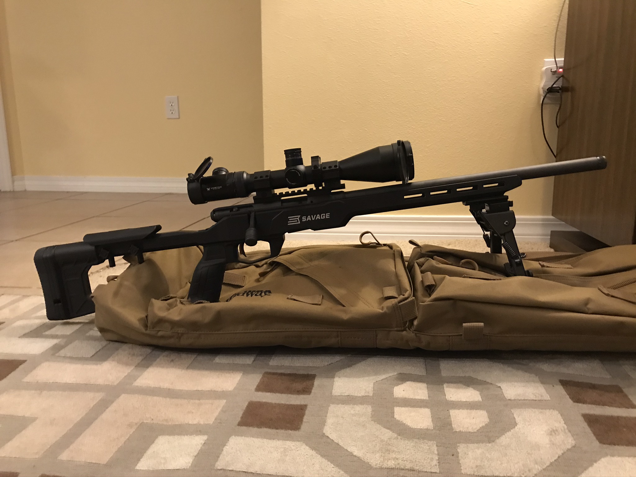

The B22 Precision Rifle is solidly built with a very comfortable and adjustable stock. The length of pull was a bit short, so I ordered spacers from MDT and the fit now mirrors my center fire rifle. The finish is matte black in what appears to be a nitrided finish that has been durable and pleasing to the eye. One issue with the adjustable plastic knobs for the cheek riser: not much force is need to lock down the riser, if you gorilla it, the knob‘s internal plastic gearing will strip off and expose the brass Allen head that is designed for more permanent cheek height setting. A small dab of Gorilla glue (pun intended) and gentle but firm tightening fixed the issues.
The bolt is smooth and does not bind when pushed forward on a slightly off axis. Bolt closure is tight with zero wiggle after closure. There is no appreciable bolt lift when cycling the action. The 2 position tange mounted safety is easy to operate and ergonomic. IMHO, the bolt is smoother and is easier to cycle faster than the CZ 457 Pro Varmint. The bolt knob is of the “tactical” variety and I think that it is permanently attached to the bolt handle. It is very ergonomic and compliments the lines and purpose of the rifle well. When re-installing the bolt, a marking on the back half of the bolt and the extractor must line up PERFECTLY. It took a few tries to get it right, and it may frustrate some newer shooter, especially young-ones starting out.
The magazines are 10 round rotary type with the release lever incorporated at the front of the magazine body. This makes unloading a breeze, but durability may be a issue after many elastic cycles of the plastic latch and drops onto concrete surfaces. Luckily, the magazines are cheap and abundant and is the same magazine in the Savage A22 and other B22 line.
I think that a 20 - 30 MOA scope base, similar to the one found on the Ruger RPRR, would be very beneficial to the intended customer for this type of rifle, but the EGW 20 MOA scope base was easy to source. True to Savage reputation, the scope base screws were loose when I removed them to install the 20 MOA base. While installing the new base, I noticed that the 2nd screw (screw 1 being the screw closest to the muzzle) was tighter and grittier and was harder to fully seat. It threaded easily for the first 1/2 and was not cross threaded. My guess is that there may be some metal shavings or uneven surfaces at the base of the hole. However, it did not bind or interfere with the bolt action.

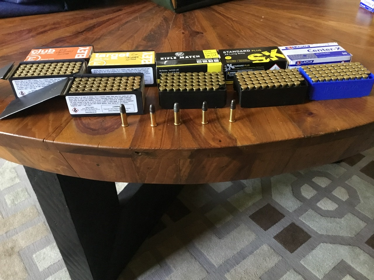

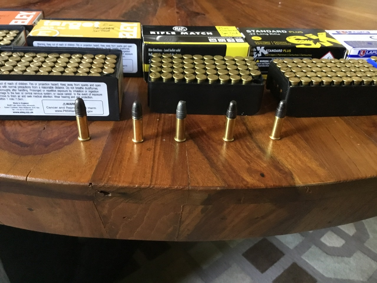

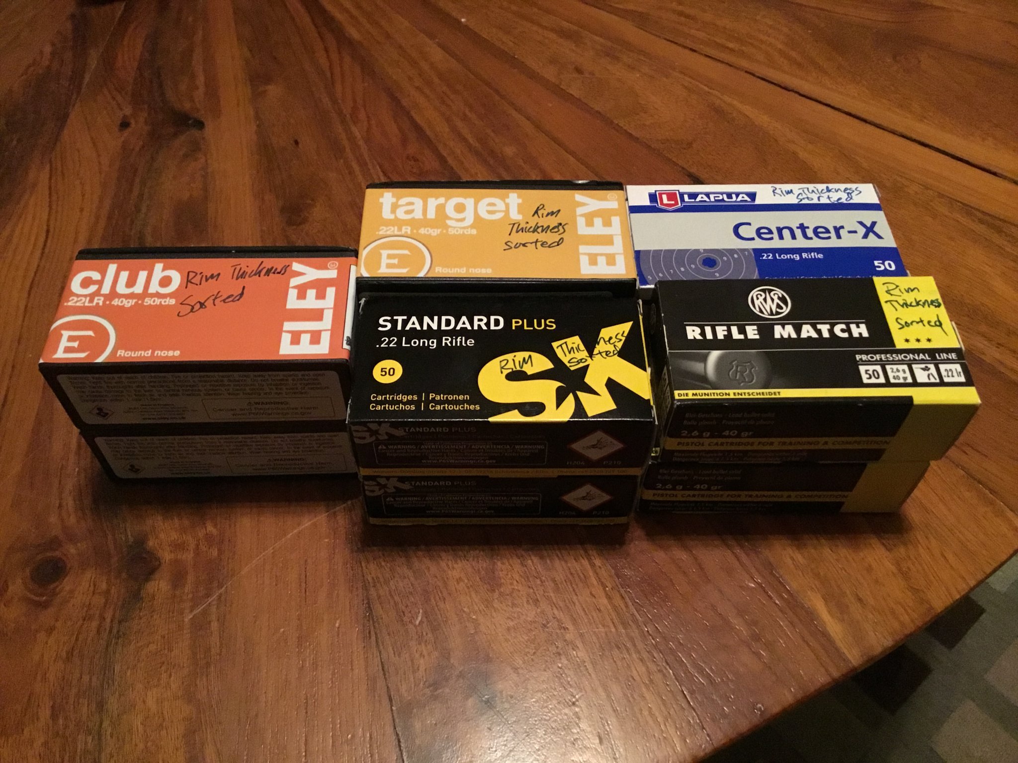

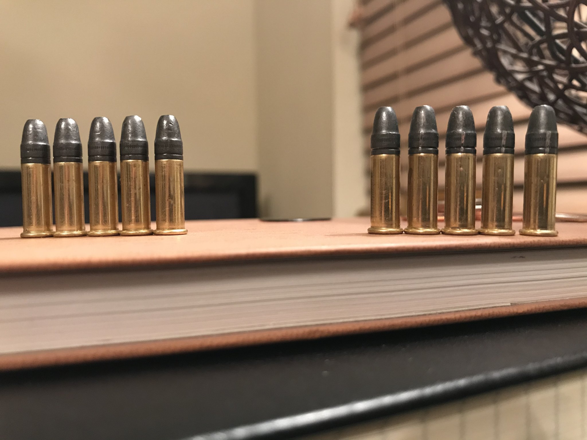

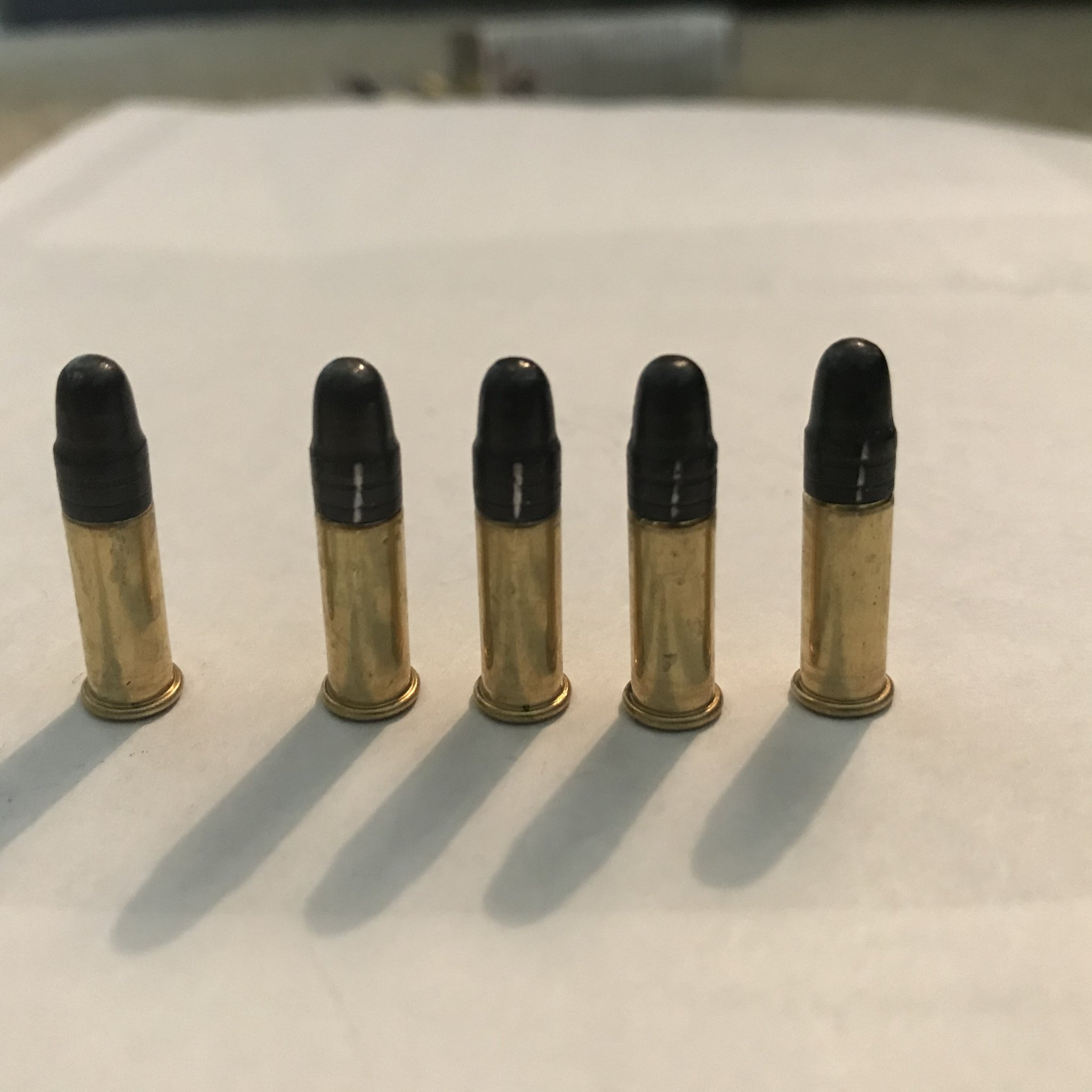

Ten boxes of mid to higher grade ammo arrived today.
Each box has been sorted for rim thickness.
My plan is to shoot 10 rounds to foul the barrel, 2 groups of 5 at 25 yards, 3 groups of 5 at 50 yards and 3 groups of 5 at 100 yards. If I can borrow a friend’s Magnetospeed, I plan to get velocity, SD and ES from each box.
The course of fire will be repeated by alternating between the Savage B22 Precision and the CZ 457 Pro Varmint starting with Eley Target, Eley Club, RWS Match, SK standard plus and Lapua Cener-X.
Few observations while sorting by rim thickness:
1. Eley cartridges had the waxiest and most dense coating, the RWS was slightly less dense, the SK/Lapua felt greasy, more like liquid.
2. The lead bullets and drive bands in these mid/higher tier 22 LR ammo are much more uniform than the CCI, Aguilla and Fiocchi Cartridges. The uniformity and lack of dents and scratches were similar to the Federal Gold Medal Ultramatch.
3. Relative to other brands sorted today, Eley ammo had the thinnest rims, next the RWS and the SK/Lapua had the thickest rims.
4. Eley ammo had the least amount of “crimp” (if you call it that) on the brass. The bullets could be turned ˜10 degrees. RWS barely wiggled. SK/Lapua didn’t budge.
5. RWS ammo had the lightest colored bullets (almost silver), Eley bullets were darker (gunmetal gray), SK/Lapua bullets were dark (similar to Space Gray in Apple parlance). I wonder if there is a difference in hardness between the brands.
We’ll see how well they perform out of the Savage and CZ as a side to side comparison this week.
YMMV, happy shooting.

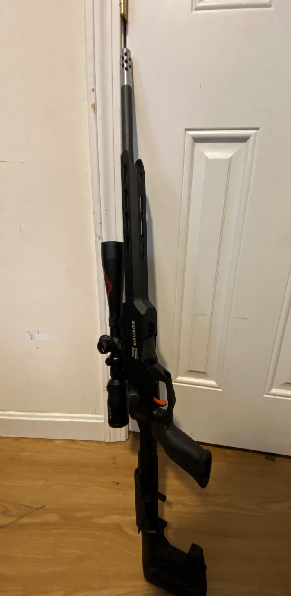

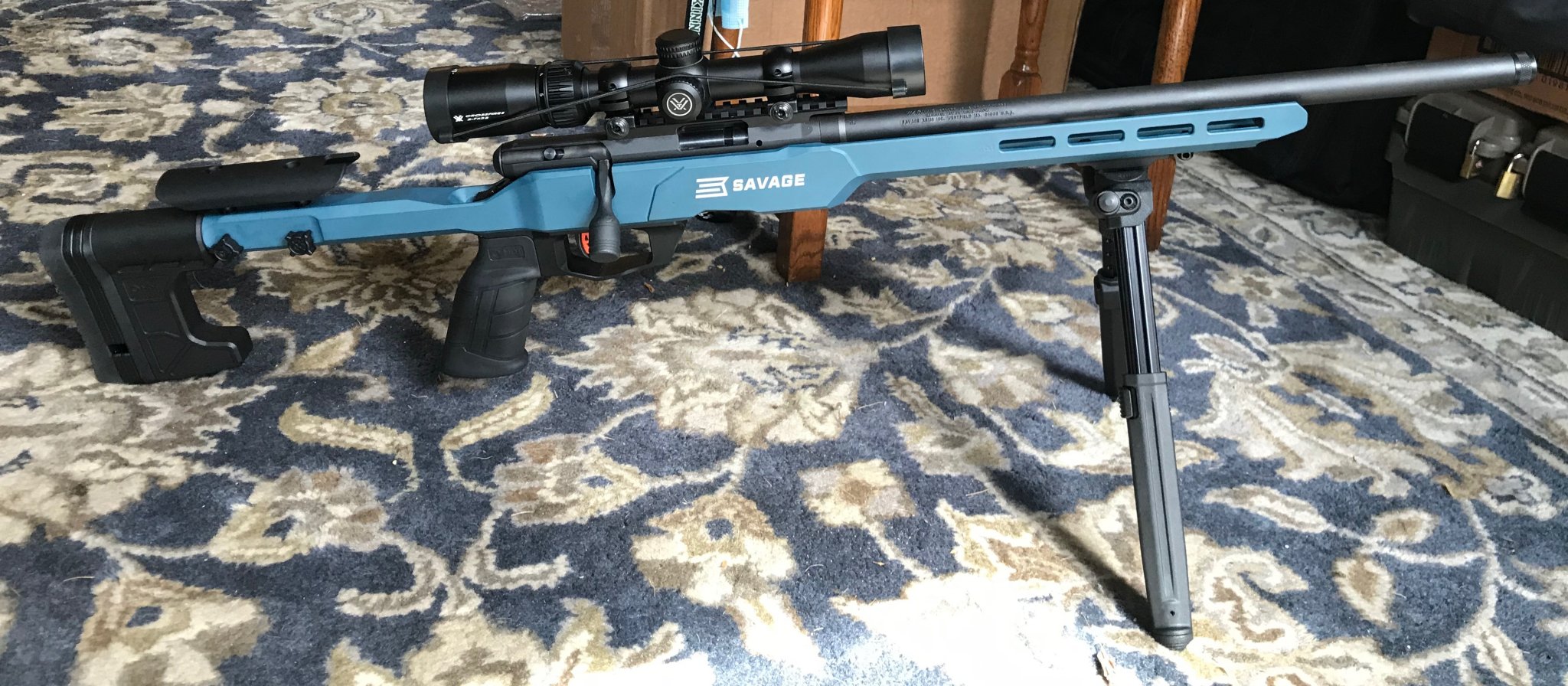

Awesome write-up thank you!! I am interested in your findings as well. I picked up a B22 Precision this summer and am soaking up all the B22 knowledge I can find. The kids and I love it! I only have a Vortex Crossfire II 2x7 on it right now but looking for something $449 MSRP or under to make the NRL22 Base cost requirements. Thankfully this one does not seem to have the scoring issue that you mentioned though as you mentioned the bolt is tricky to get aligned. Mine likes CCI-SV and Aguila Super Extra Standard Velocity (Yellow and blue box that also says Eley Prime). Best I can get with the 2x7 and being a "Noob" is 1 - 1.25" at 50 yards though my 16 yr old daughter can knock out 0.5" at 50 yards all day long. Have not seen a duplicate to mine yet, it has a matte blue MDT chassis not the standard matte black.
Wow, beautiful color. I’ve not seen it in that color.

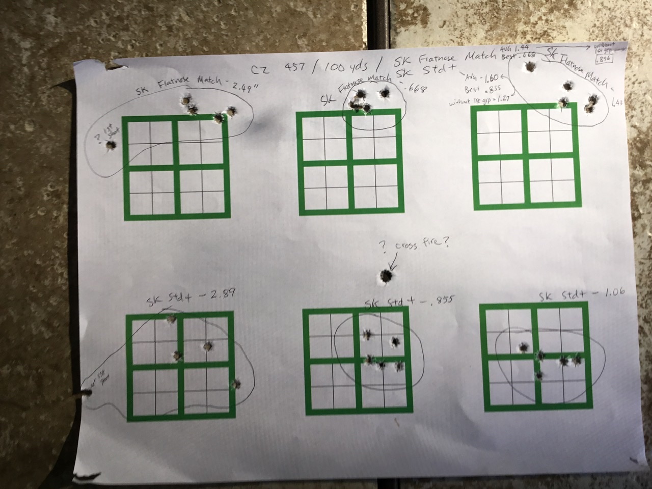

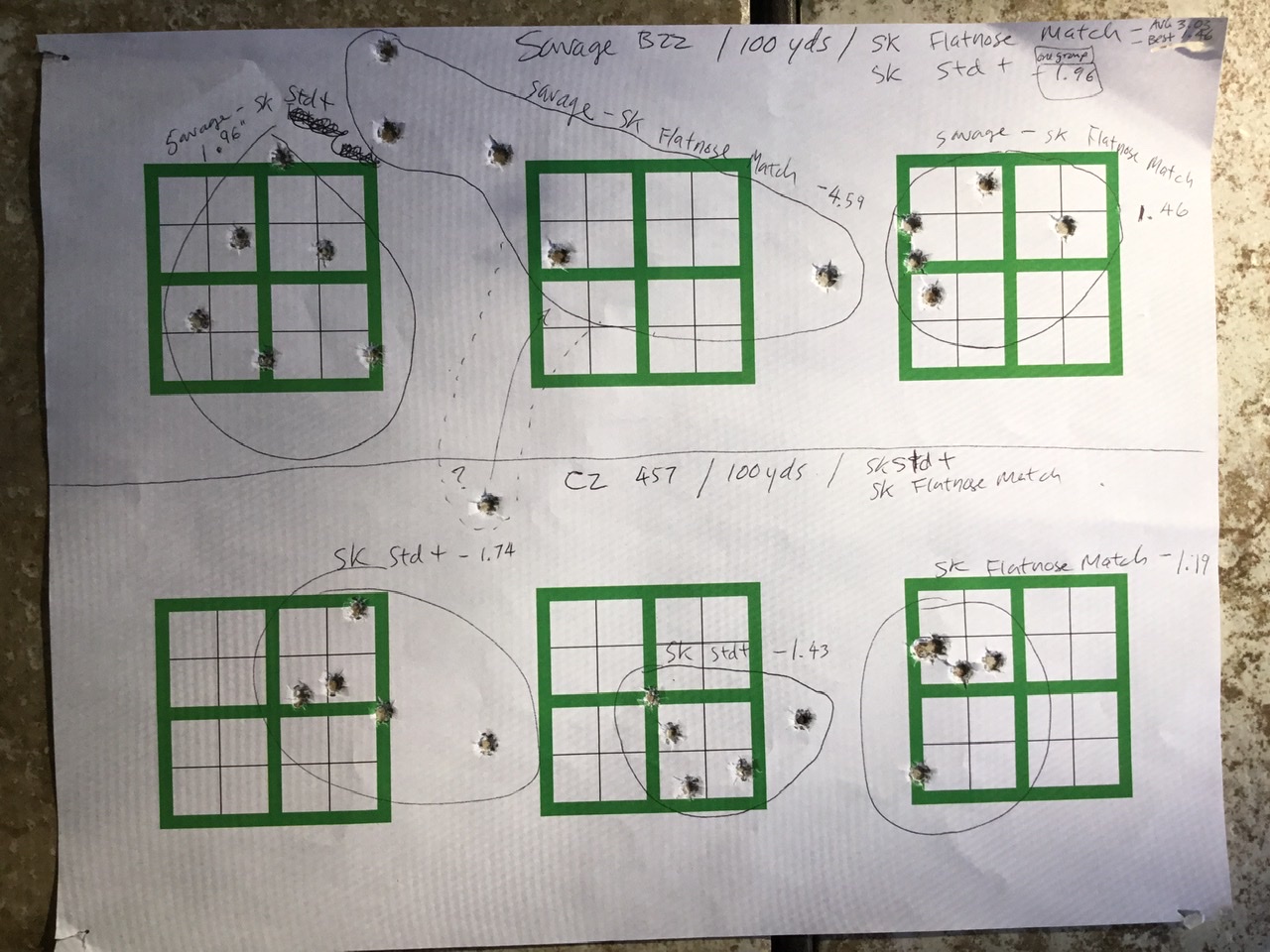

Range update 10/2/2020
Cool, breezy but sunny day in NW Florida, winds 3-4 MPH early, then 10-12 MPH later on.
Rifle: Savage B22 Precision vs CZ 457 Pro Varmint
Ammo: SK Flatnose Match (FNM) and SK Standard Plus (Std+)
Range: 50 yards and 100 yards, 5 shot groups all from the prone with a bipod and a rear bag
30 rounds chronograph data with Magnetospeed Sport on the Std+ (Sorry, forgot to put it on for the FNM)
CZ - avg 1083, hi 1101, lo 1060, SD 8, ES 41
B22 - avg 1036, hi 1058, lo 1014, SD 11, ES 44
50 yard 5 shot group results:
CZ with SK FNM - avg .546 / best .354
CZ with SK Std+ - avg .520 / best .355
B22 with SK FNM - avg .922 / best .700
B22 with SK Std+ - avg 1.02 / best .746
100 yard 5 shot group results:
CZ with SK FNM - avg 1.44 (without 1st group .896) / best .668
CZ with SK Std+ - avg 1.60 (without 1st group 1.27) / best .855
B22 with SK FNM - avg 3.03 / best 1.46 (stopped after seeing that it does not group)
B22 with SK Std+ - one 5 shot group 1.96 (stopped after seeing that it does not group)
Conclusions:
1. Beautiful day at the range. Autumn is here.
2. CZ shoots very well with the SK Ammo. It shot the SK FNM and Std+ about the same at 50 yards, but the FNM shot slightly better than the SK Std+ at 100 yards. (Could be due to increased winds later on in the range session)
3. CZ with the SK FNM shot reasonably well even with relatively high winds at 100 yards. It may be the flattened nose design similar to the Eleys, it may have been winds or fatigue (I shot the SK Std+ during the last 1/2 of the session)
4. Savage B22 at 50 yards with the SK ammo tested is not competitive. Even the best 5 shot groups were larger than the CZ’s average group size for 6x5.
5. Savage B22 completely falls apart at 100 yards. Although I have more testing to complete with other ammo, my hypothesis that the scored/scarred bullet driving bands introduces inaccuracies into the shot groups that worsens as the distance increase.
6. The adage of “double the distance, triple the group size” appears to hold true for the CZ (.540 at 50 yards to 1.44 at 100 yards) and the B22 (.922 at 50 yards to 3.03 at 100 yards).
YMMV, happy shooting, and more testing soon.

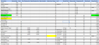

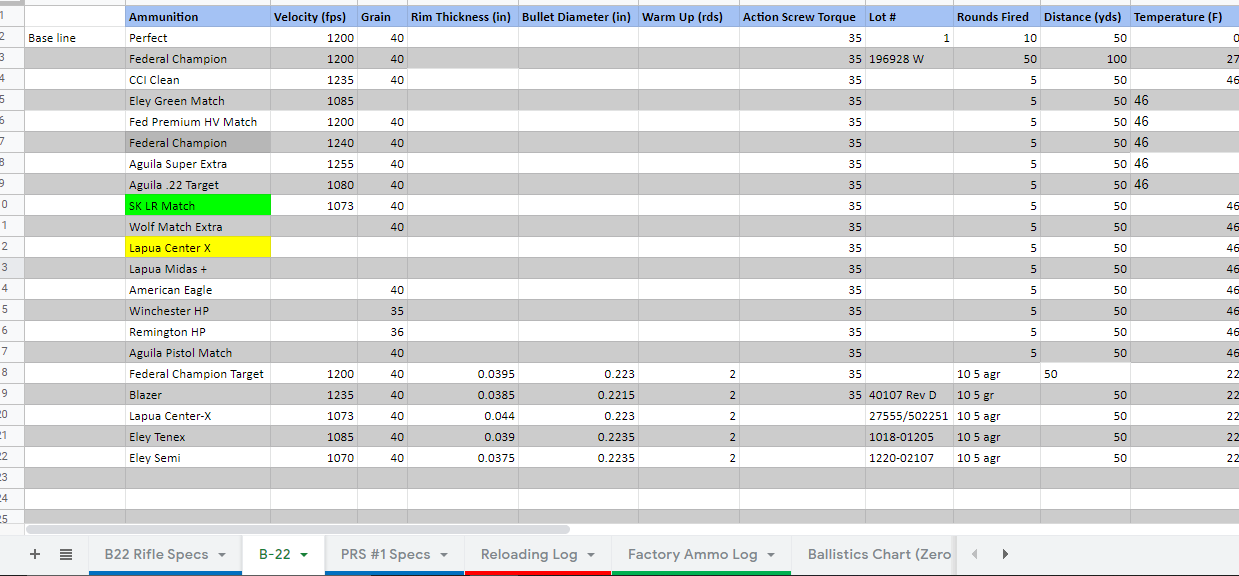

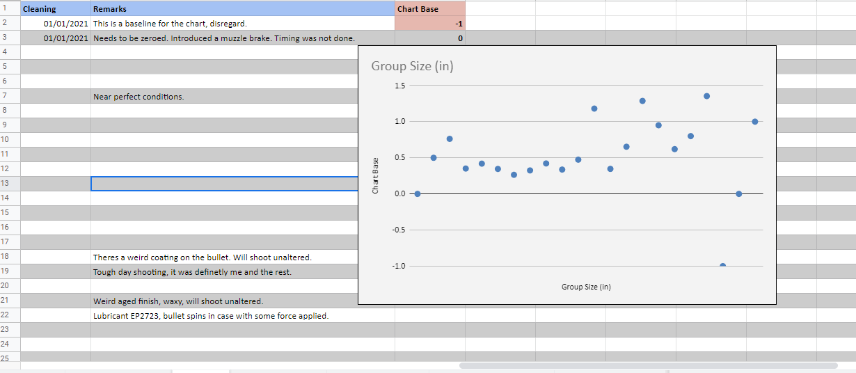

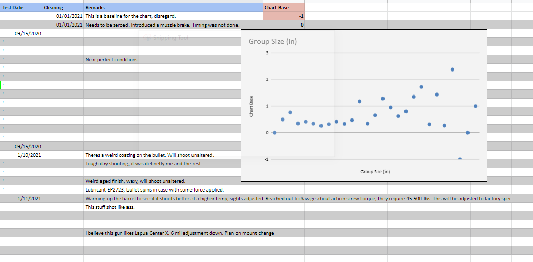

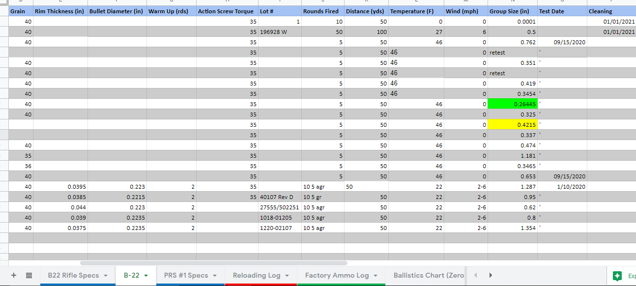

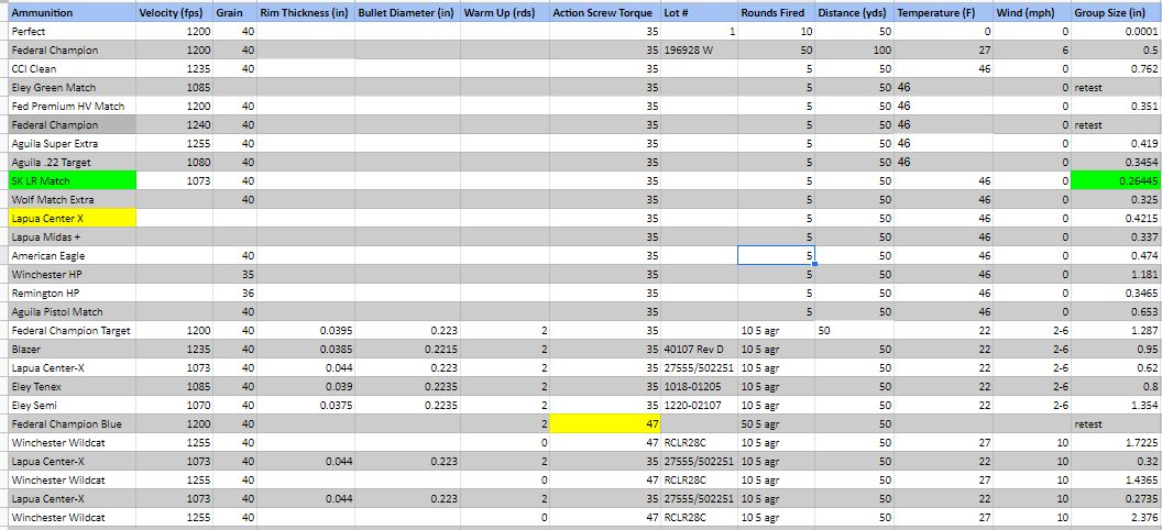

I like the concept of this gun. It keeps me busy while my PRS rifle is being built. The gun is bone stock besides the muzzle brake and optic. It has a Vortex Diamondback Tactical and some standard rings (subject to change). The muzzle brake has been machined out of 416 stainless by a good friend of mine. I am not the best shooter in the world, but I am oddly driven to see the limits of this gun.
Here is a brief breakdown of how this gun has been behaving. IMO so far save and buy something more reputable. I am saving for a Vudoo, this B-22 seems to be extremely good at running anything you put in it. I have had one failure to extract out of all my time spent behind this gun. I will try to update this weekly as I shoot.
I measure groups the way Steve Ostrem measures groups, I use a benchrest target for 100 yards to shoot at. Let me know your thoughts.

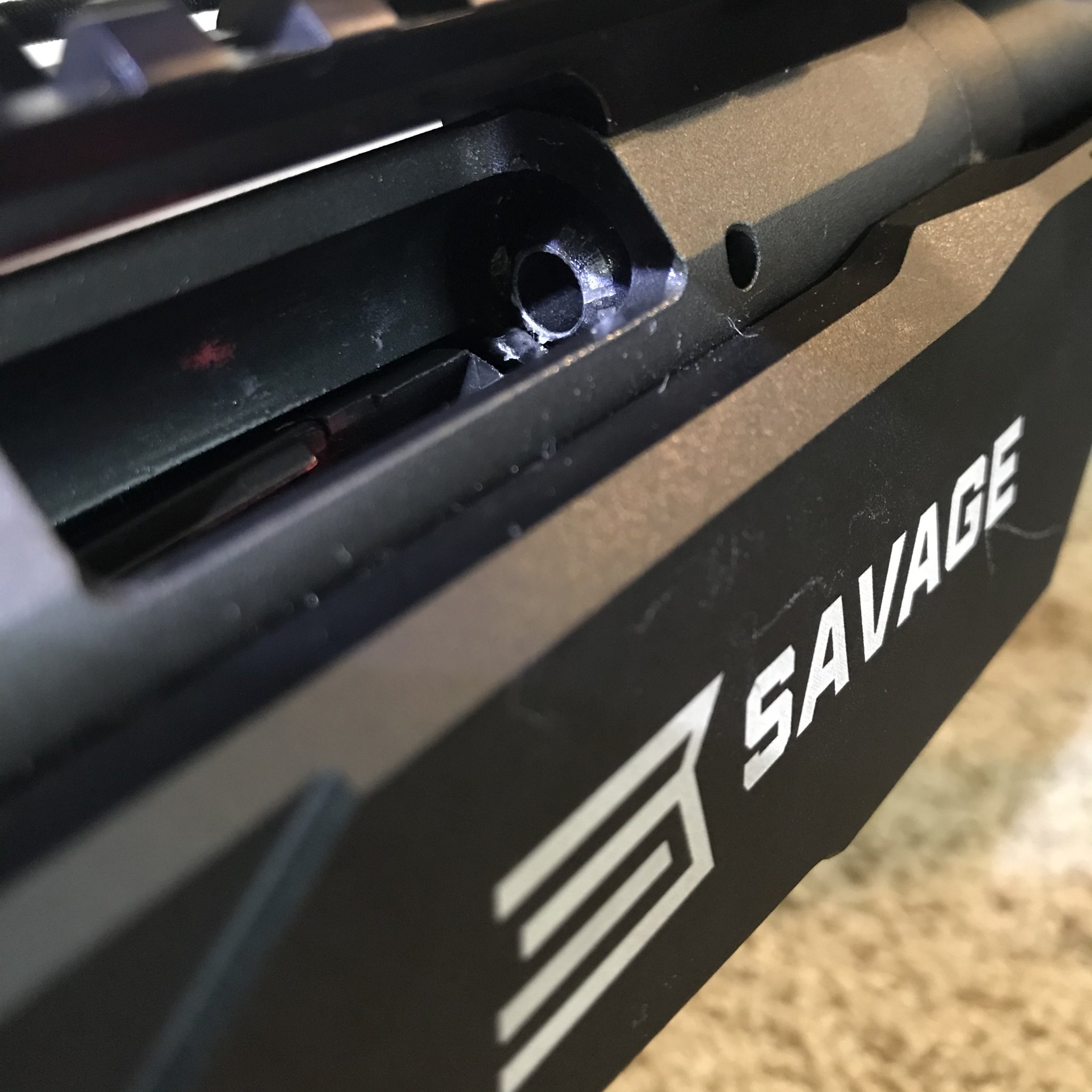

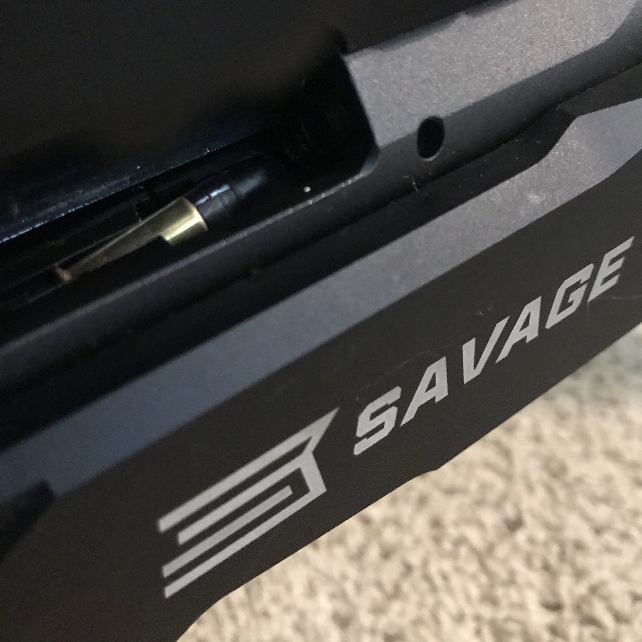

I got one last month since my son commandeered my Tikka and it seemed like a good way to get into a "chassis gun". So far, I'm definitely underwhelmed.
  • Extractor doesn't work. Out of the box, after a basic cleaning, about 90% of rounds failed to extract. I've used three different brands of ammo: Browning, Aguila, and Tippmann. After scrubbing the snot out of the chamber, I fired another magazine and three rounds actually extracted. Rather than deal with that nonsense, I put the Savage away and shot my Glock instead. I'll order some new parts tomorrow and see if that helps.
  • Unresponsive support. I opened a ticket last Monday morning regarding the extraction issue. No response, even so much as "Please give us more time as we're overwhelmed."
  • Fit and finish. When I took a picture of the bolt for the support ticket, I was surprised by how it looked more like a relic than a brand new part. The roughness of the finish and the premature wear are more evocative of a hammer than a precision device.
  • Other broken parts. When I was putting the Savage in its case yesterday to take the range, the comb broke. The threads stripped out of one of the shafts where it attaches to the cheek piece. I was able to clamp it down with just one shaft but the way the thread material just pulled out with the bolt doesn't inspire confidence.
Don't get me wrong. I'm not angry and I'm still hopeful that after I work through these issues, I'll have a great-shooting gun. It's just that we're not off to a great start. :(
Update: Opening a ticket with Support was apparently the wrong approach. Today, I just called to order replacement parts (extractor and comb) and they're sending them to me under warranty. I should have the parts around the end of next week.
One curious note is that, since the chassis comes as a single component from MDT, they couldn't just send me the part for the comb or even a new comb. I'm actually getting a whole chassis and will send it back with the broken comb. Hopefully the new extractor does the trick. If nothing else, I have a spare to reshape if it doesn't work off the bat.
I emailed Savage and asked for a second clip to add tension to the extractor. I filed the second clip down some so it wouldn’t protrude outside the bolt OD and now all failures to extract are gone. Went from 90% fte like yours to zero. I have a B-22 and a V-22 and the Savage can hang with the Vudoo out past 100 yards. The Savage even got its first NRL22 first place finish from my daughters boyfriend while my Vudoo is still a bridesmaid!

It's the MDT chassis - I guess that is the precision. All ammo works now with the sceond clip. SK, CCI SV and Fiocchi are the last 3 I've tried. Shoots them all the same at 100 yards, 1-2 inches, with no failures.

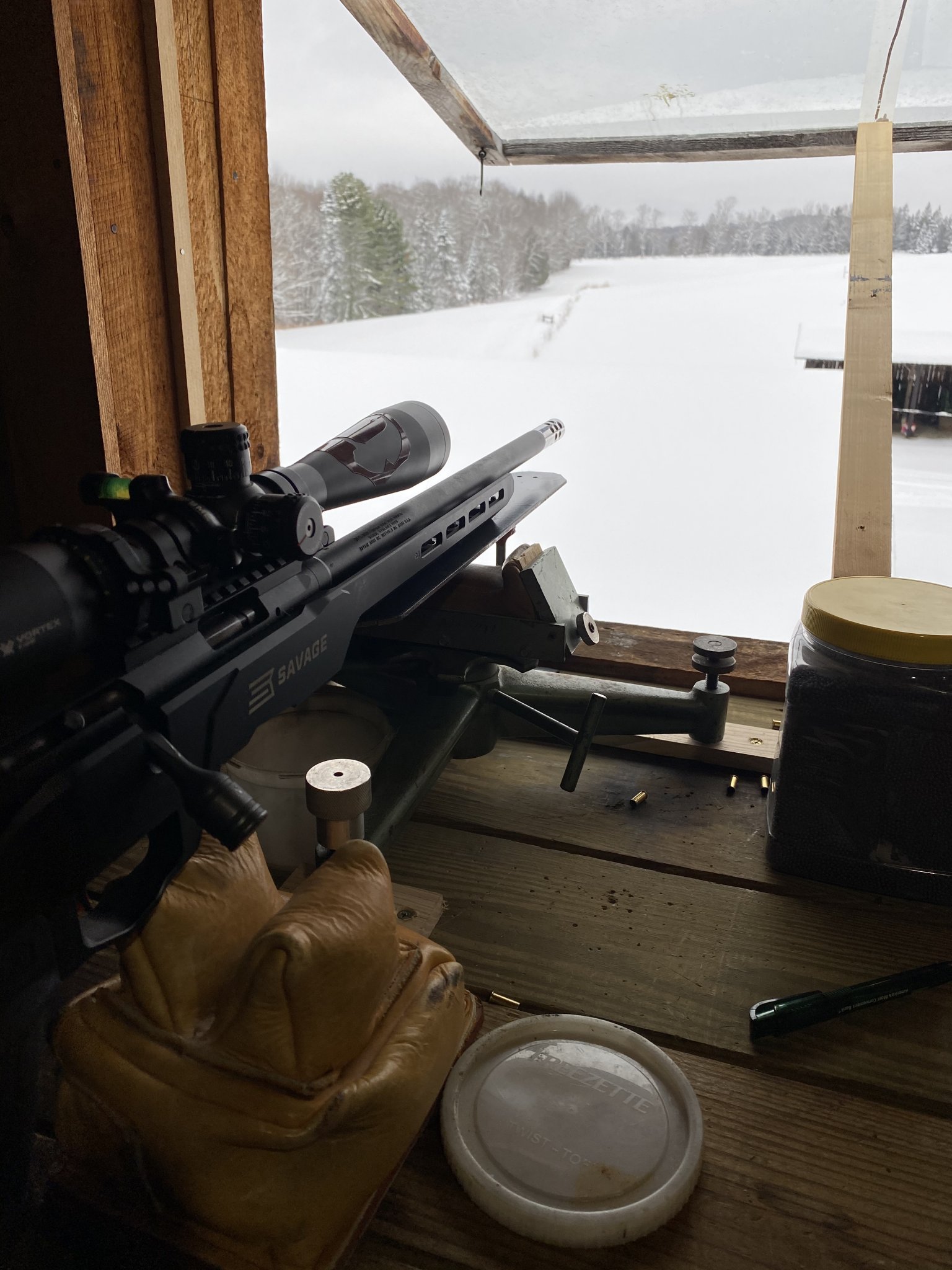

I shot in a damn storm, the northeast is not forgiving. Here is some more data for you guys to look at.
Somethings that I plan on changing. The mounts on the gun are going to change to a higher quality and the optic needs to be something with 1/8'' min clicks or more. Let me know your thoughts if you have any ideas on something that would work.
Lapua Center X seems to be getting the best groups out of this gun.

After "sharpening" the extractor and spending a lot of time scrubbing the chamber, rounds were successfully extracted 80-90% of the time when I didn't rush moving the bolt. That's still not acceptable but I can tolerate that until the new parts come in. I'm now pretty confident that doubling the clamp will get things extracting reliably.
What are you cleaning with? Scrubbing with? I have had issues with cleaning after shooting ELEY and using Shooters choice. I stay to Breakthrough right not and I haven't had any issues yet.
Just ordered one. :oops:
Let me know what you get for results. I have modified a bore snake for chamber of this rifle. It works for the wax coating removal, then I clean with a normal brush with a chamber guide. I wonder when and if I will would start having issues with this gun.
Something odd I do not think I mentioned in the update is that I attempted to shoot some older stuff to "clean" between shots and they would not feed up the ramp at all. The bullet itself was being crushed and deformed, they were not hollow points. After these two I had not had any other issues.
Ran the chamber brush through the Savage this morning before heading to the range. Two out of my first three rounds failed to extract. :confused: Then I remembered that I got better results when I pulled the bolt back slowly.
Boy did my results get better! I shot 57 more rounds after that and 57 rounds extracted. Still waiting on parts from Savage. Hopefully, doubling the extractor spring will make it so I don't have to baby the bolt.

I got one of the blue special sportsmans warehouse editions and it has been a lot of fun.
Mine does scratch the next round but I have loaded one, drop mag, shoot, push mag back in, rather than trying to hand feed them single. Mine didn't feed copper plated hollow points worth a damn. the edge of the chamber caught the HP and made a mess of it.
I did just stone the bottom side of the bolt and I don't believe you can bevel the bottom leading edge of the bolt. That's what picks up the next round in the mag. The bolt looked almost identical to the CZ457 so I believe it has something to do with the rotary mag not having any vertical give after it rotates the next round under the bolt. I might mess with somehow making a vertical mag similar to the A22.

I'm also looking at making a new feed ramp so it will reliably feed hollow points for when I do a little prairie dog shooting this spring.

I switched optics to a Vortex Strike Eagle with more magnification and finer adjustments. I think I have found the limits of this rifle at .2-.33"
If you get this rifle to run hollow points under an inch and feed them. Let me know, I will gladly pay for whatever you're doing.

Good shooting. Were they best 5 shot groups or something like a 6x5?
My extractor retention clip came in, they also sent a new extractor and a ejector. Range time set up for tomorrow.
I shoot off of 100 yard benchrest targets at 50 yards. I shoot 5 round strings. I measure the way Steve does in ((1) Quick Tip: How to Measure a Group - YouTube
The best group came from SK Long Rifle. I too am shooting tomorrow, just in the damn snow of New England...
I like your spreadsheet. I do the same. Do you measure base to ogive for your ammo as well? I'm not suggesting sorting to 0.001" as i dont see that making a difference. More is there a correlation between length and what shoots best?
I dont see a difference at 50 yds but at 200 where I do most testing I seem to have a correlation with length.
Reactions: Echo.shooter
Yeah right now it does a good job of cutting half the hollow point off. I'm looking at setting the cnc to machine a new feed ramp. I also took 2 mags apart and reduced the spring tension. Gonna see if they still mark the bullets as bad now.
