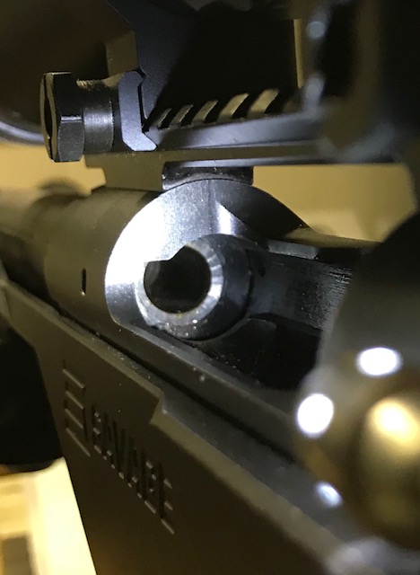

I had the same exact problem with mine. I finally took it to a gunsmith, and he added a nice big chamfer to the chamber. Now the entrance to the barrel is beveled instead of flat, which you can clearly see in the picture. The neck of the rounds was getting hung up on that. You can see how adding the chamfer would fix that. I also have the most success with Accuracy International magazines with feed lips "tuned" to .385 inches. You can buy a feed lip tuner online. She cycles awesome now. If your rifle is like mine, you probably also have a bolt with a lot of play/slop in it. You can buy a custom size bolt for $99 at Pacific Tool & Gauge. (Don't buy a fluted one, though. It's a gimmick.) Just buy some pin gages on Amazon to get the exact size of your raceway diameter. Savage should be around .7 inches. My factory bolt was substantially less than that, which has to be expected on a cheap rifle. The size my bolt SHOULD be is exactly .701 inches. Hope this helps!!

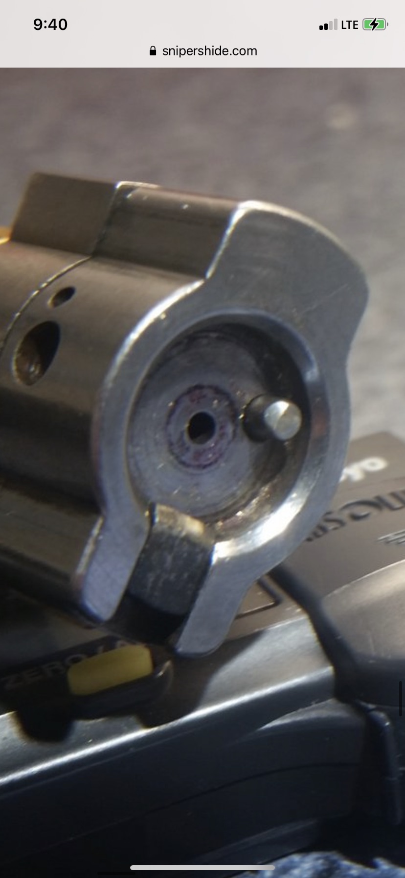

Hate to bump an older post, but thank you Scott for your input in this one. I’ve been fighting the “round jumping higher than breech face” jam on my budget Axis build for going on two years and really only saw what was happening today. Some quick google-fu landed me on this thread-glad it did.
Trimmed and chamfered ejector, and now she feeds quick and easy.

I don't think they're out of spec, I think they swapped ejector styles without telling anyone. Even if you call savage and tell them you need a replacement angled ejector it's a roll of the dice to see if you get the round one instead.

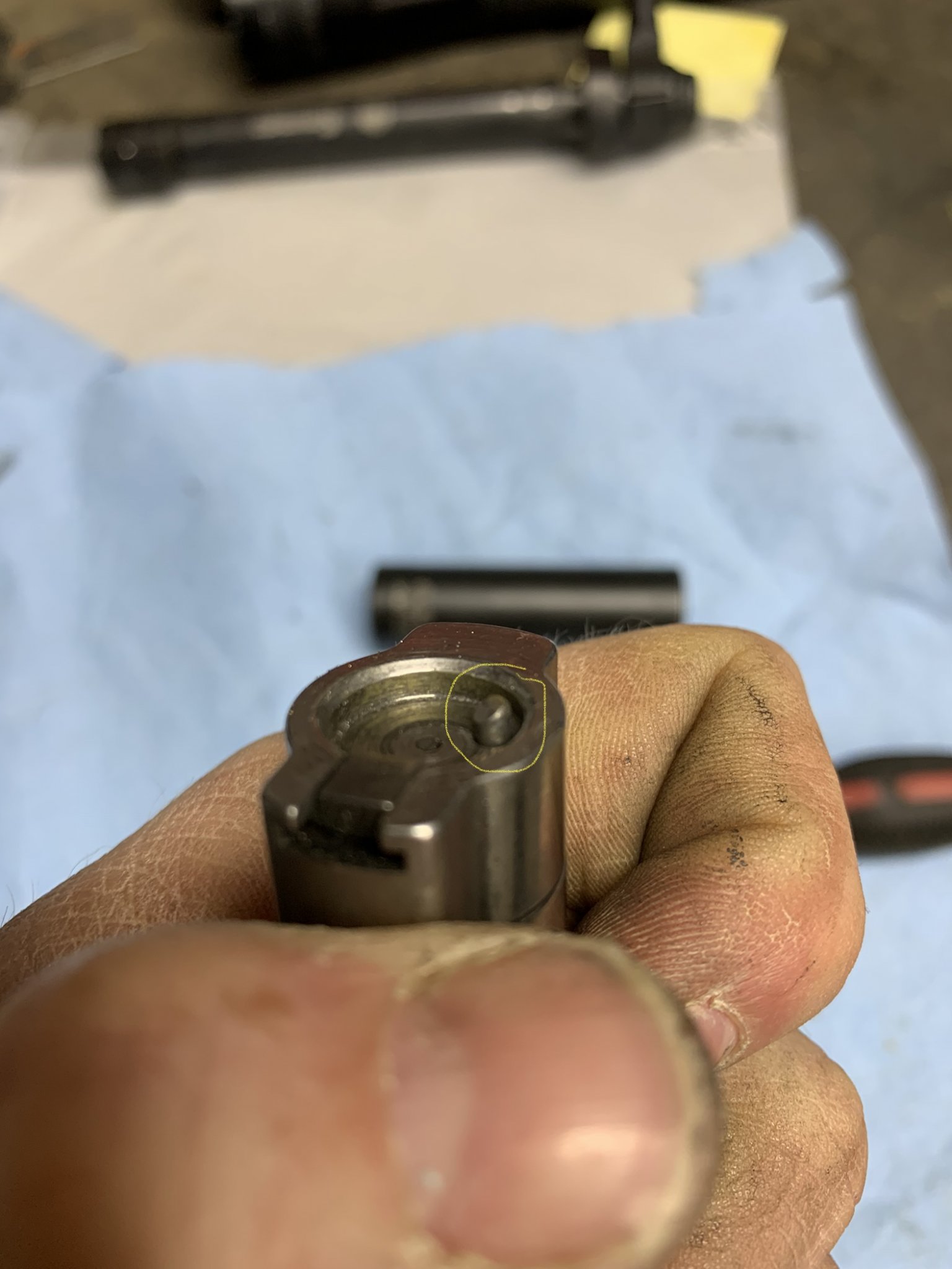

THANKS EVERYONE HERE!!! I'm working thru the same issues now with my new .308 High Country. Slow feeding the bolt is fine, but any kind of speed and the case jumps out of the feed lips to the top of the bolt face and cocks/jams before chambering. My barrel also has a sharp edge at the chamber facing the bolt. I'll start with the ejector pin and go from there! My pin is just even with the top of the bolt face and has a domed shape to it. Also the ejection is somewhat limp as the empty just gets out of the reciever!, Thanks, Gerry
This is all it took to get my working proper.

Update: Like everyone has said, shaping the ejector pin towards the firing pin has done it for me! I pulled the pin out first and tested on mocked up loads empty and with a bullet seated, both worked equally fine, and I can cycle the bolt as fast as I want. Now I would like the eject a little more powerful, but I am not looking a gift horse so to speak!

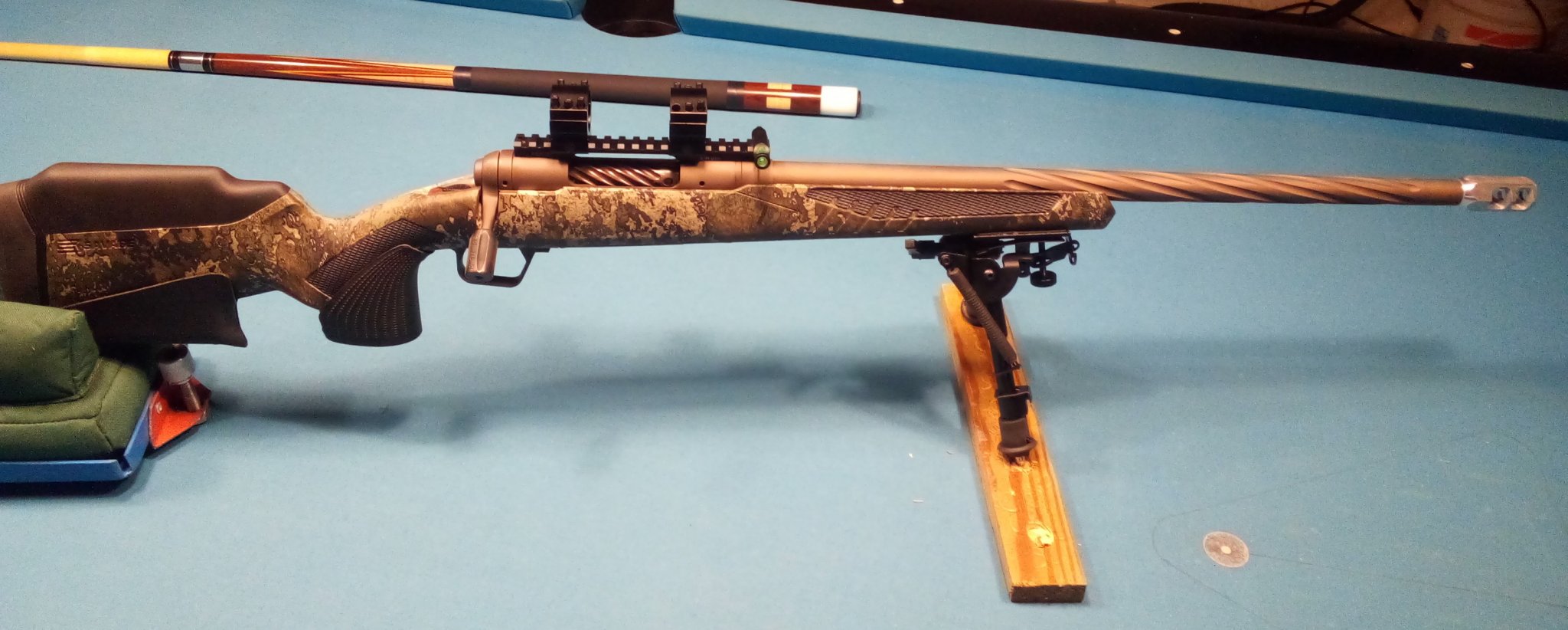

Here's the new rifle waiting for glass from Optics Planet. I made the bolt lift knob(section of .223 Wylde barrel), bag rider(Kydex) and muzzle brake(design ripped from Bangsteel guys) here in my shop. The grip is from a Tikka, but not sure if it going to stay? it does fit my hand well. Thanks again all, Have fun, G.
