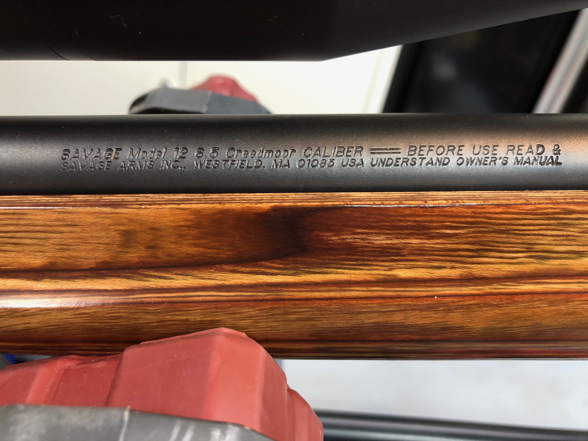

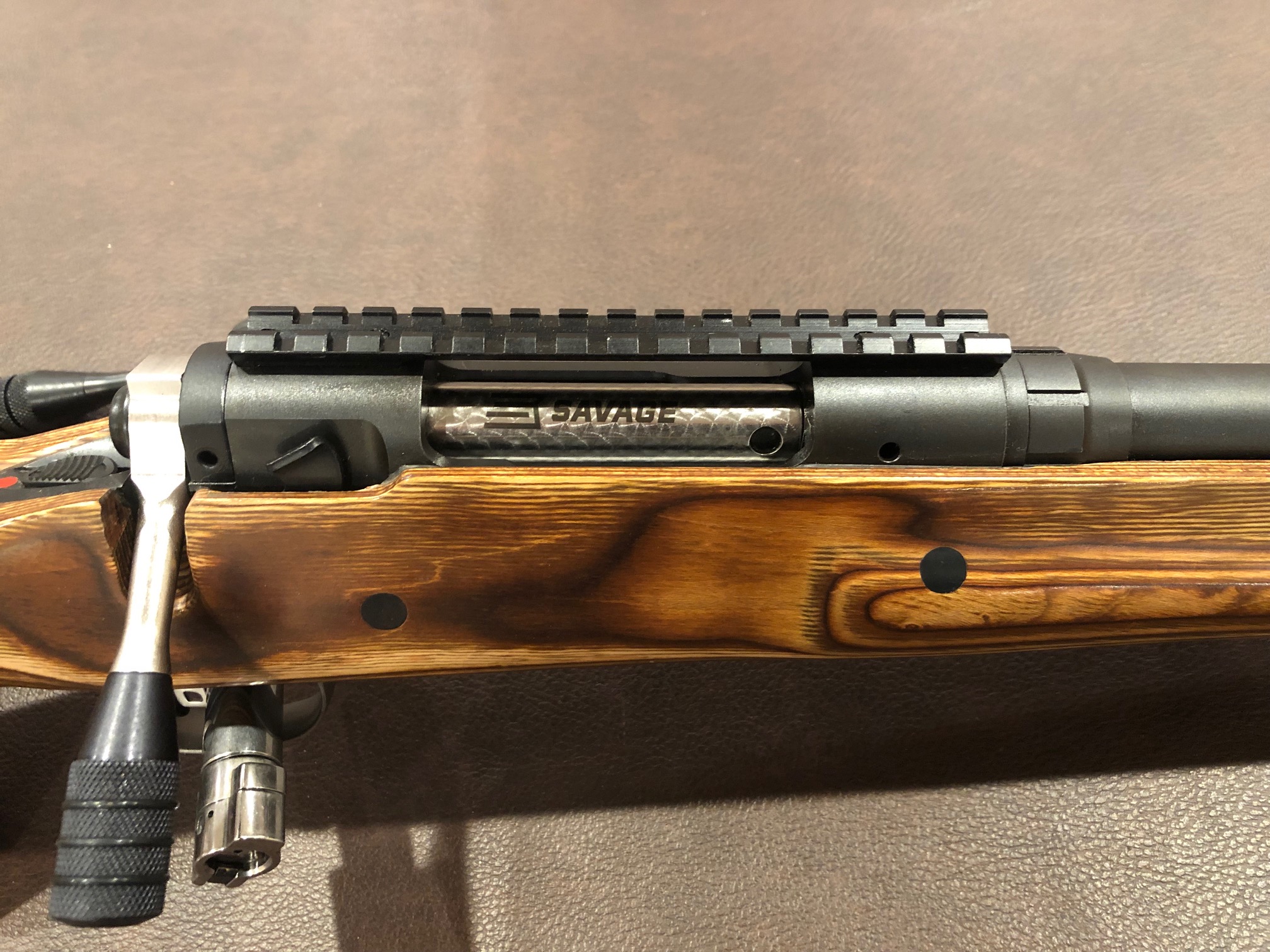

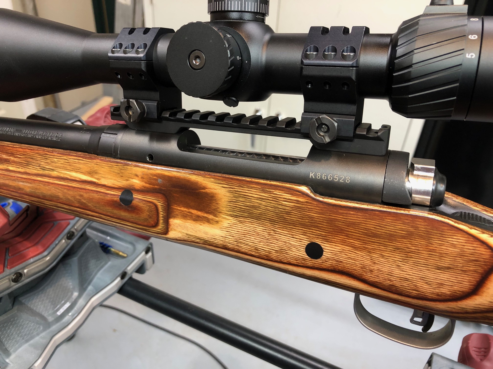

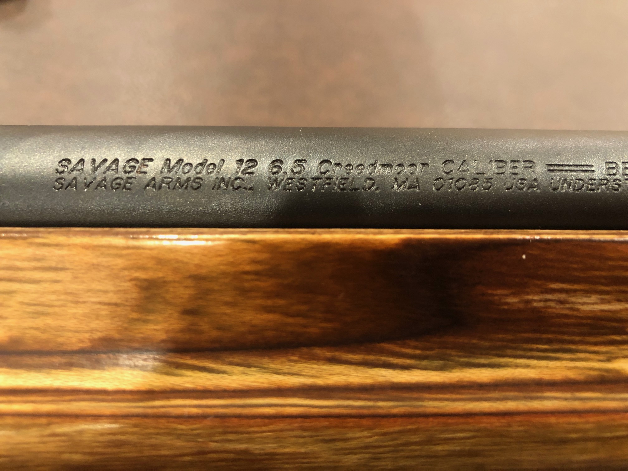

So, this past weekend I picked up a very nice Savage model 12 in 6.5 CM at a local gun show, I'm just not really sure which model 12 it is. I been searching in the forums, Savages website, other forums etc., but can't really nail down what it is. It's not really imperative that I do, I'm just really curious. The guy that was selling builds custom bench guns, he had taken this one and pillar bedded & glass bedded the action into a Boyds stock. He also put a bottom plate in it to make it a single shot. It is very smooth and shoots well (consistent .5-.6 MOA groups with off the shelf ammo). I tried 10 different brands/weights of ammo and it shot all very well.
It does have an Accutrigger and it was set to 1lb, but will adjust down to about 6oz. I was thinking it was a 12FV or 12 LRP, but I'm not sure. If any of you guys could offer some input, I would be very greatful.
Reactions: TurdFerguson
The finish is on the rough side, so could just be a Cabela's special 12FV action gussied up with a new bolt handle and stock. And if the trigger can truly be set to 6oz it was worked over hard...make sure it's drop safe!
Reactions: SlimJim_
It is drop safe, I tried to get it fail multiple times and it didn't. I put about 75 rounds through it without any sort of failures or issues.

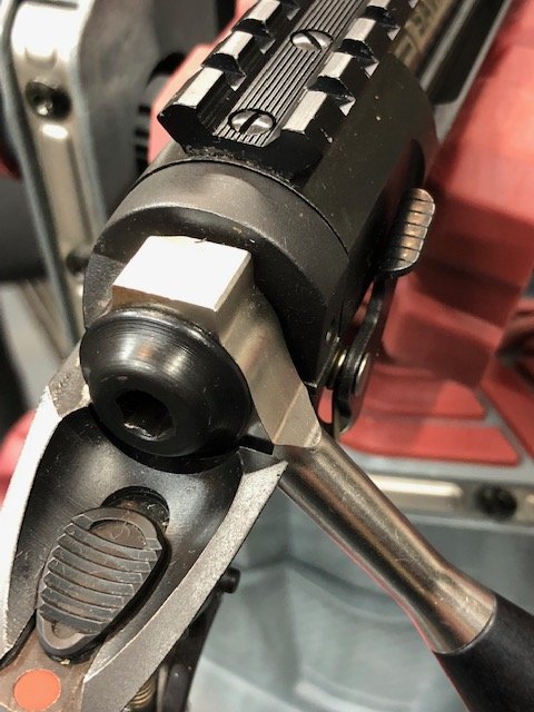

Glimpse of the safety blade in the pics is silver...target triggers are red. And this action is a small shank, think the target actions are large shank??
Yes, it is silver trigger and it is a small shank. That's what got me curious. The seller did say that he did some trigger work to it. I'm going to look closer at it to see if it's an aftermarket, I didn't really look that close at it before.
I am happy with this rifle in every way, shoots great, bolt lift is nice and the trigger is amazing (price was good too). Like I mentioned in the first post, I was just curious about the parts. I'm going to work up some loads soon to see what it likes. Hopefully it will be a performer.
One nice thing about the savage is the ability to buy new bolt handles. Looks like a new bolt handle, hard to tell about the barrel, but looks pretty standard.
Looks like one of these stocks:
I'd pop it out and see if it is bedded, if not, I would pillar and skim bed it.
Probably shoots really well.

It is the standard barrel. It is also has been pillared and bedded. I shot what purchased ammo that I had (S&B, Aguila, Barnes, Federal etc.) It shot most of it very well, except for the Aguila, it had the worst grouping. I'll be loading some 123gr match for it with the StaBALL match powder to see how it does.

For the OP's rifle, I will also say it is most likely a Model 12 FV that someone installed a Boyds Pro Varmint stock on. As far as I know, Savage has never used the Boyds Pro Varmint stock as a factory option.

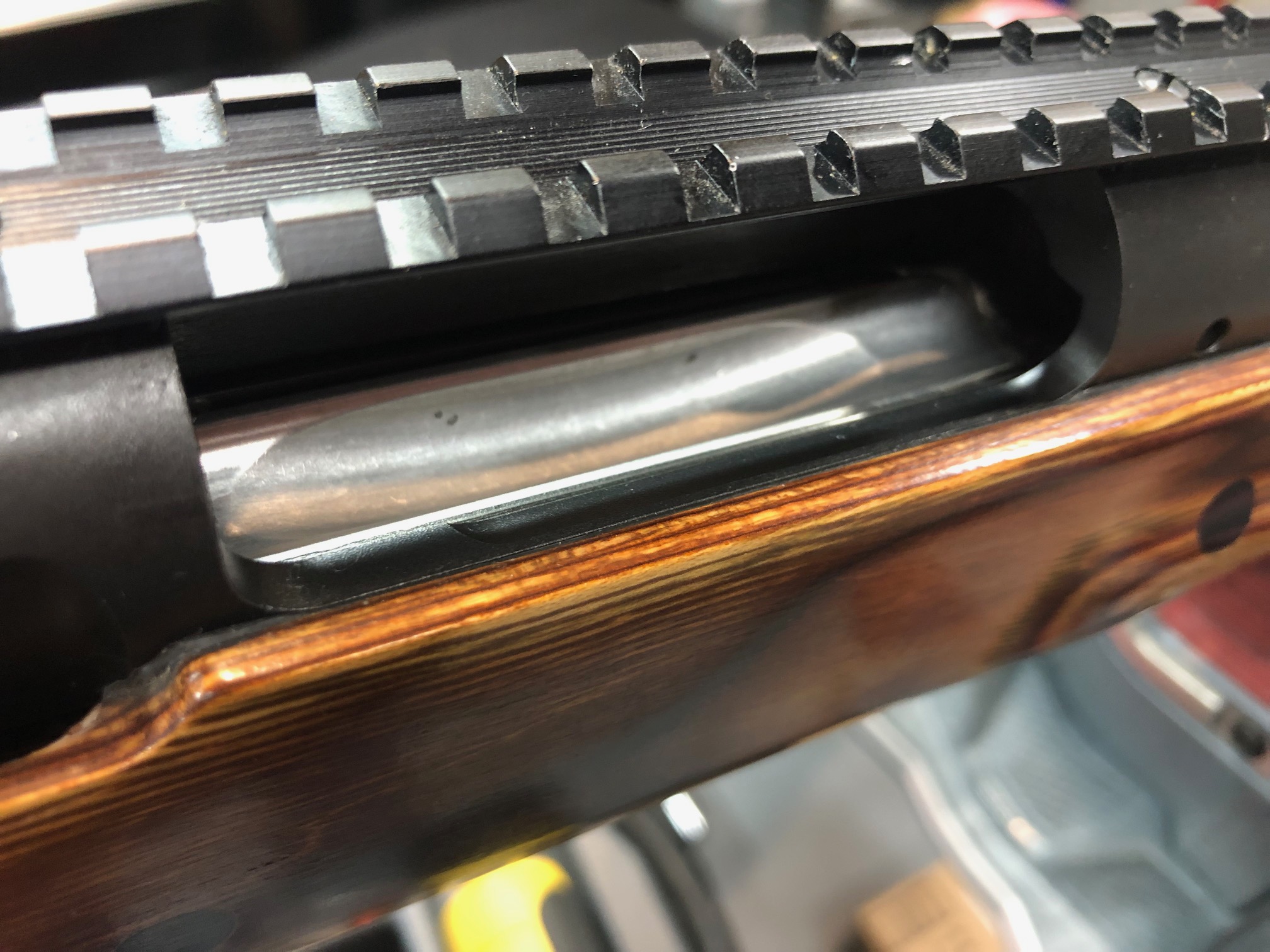

That is the standard top bolt release used on pretty much all Savage models.
there's a bottom bolt release as well. but the 4.4" action spacing and bolt release mean its either the same action as the 12FV or it's the same rifle. The action does have a different finish which is odd but it looks to have been dressed up anyways.
Yes there are bottom bolt releases too along with the different action screw spacing for the older staggered feed short action models. But when it comes to the top bolt release, it is the same no matter what model it is.
