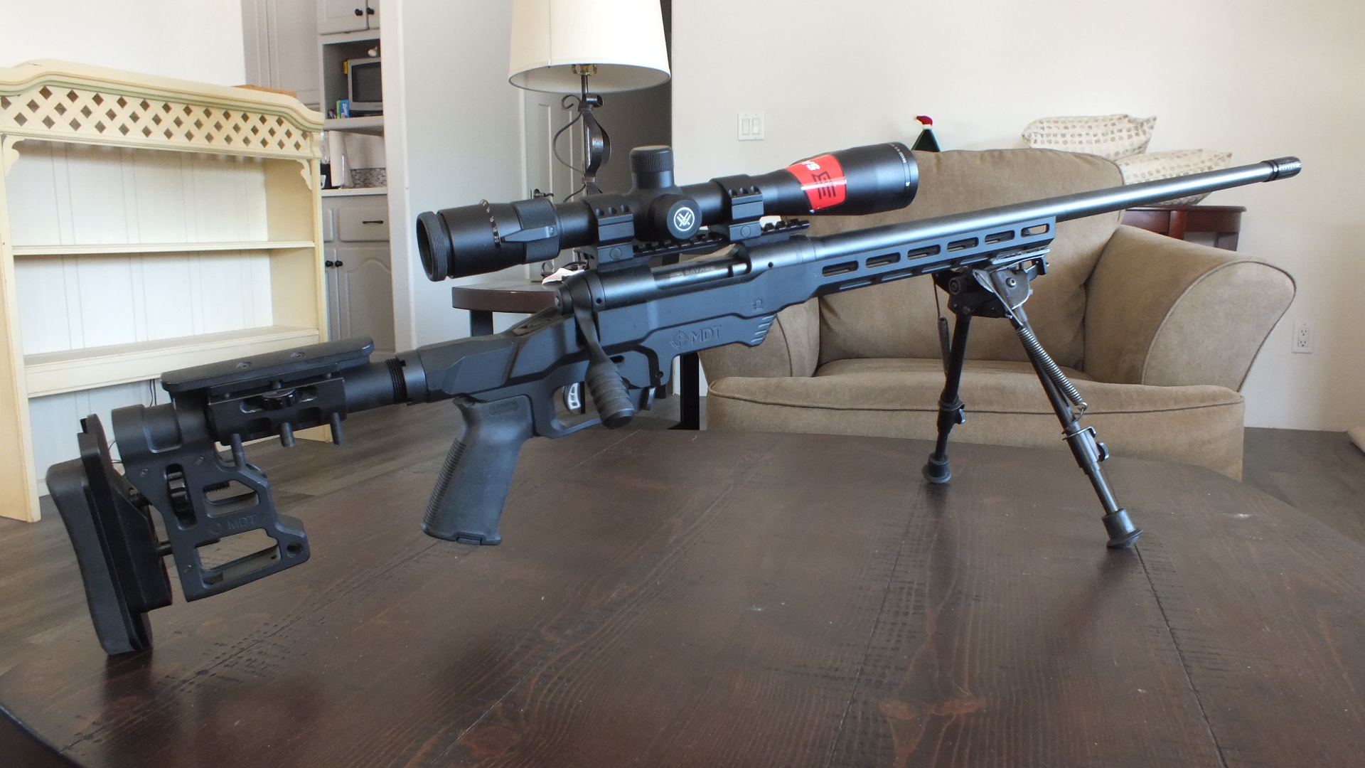

    Try getting inlets for lefty savages. ?. Thankfully MDT has a nice chassis. Been happy with it so far. All other bolt guns are Rem 700s. Shoots pretty good for lower cost stock barrel. Can’t wait to burn it out and slap on a Proof. For the total cost, i could have just got the APO SH Rifle. But I already had the barreled action.

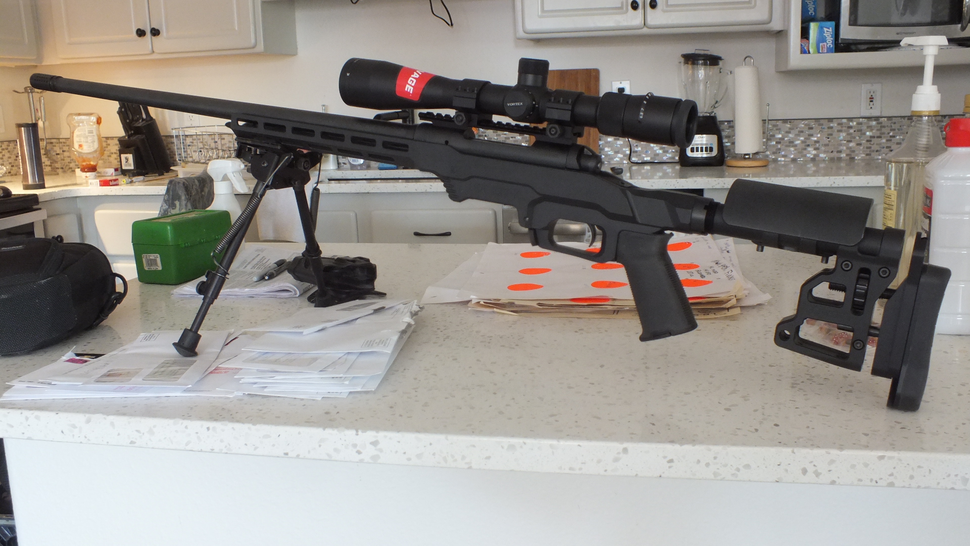

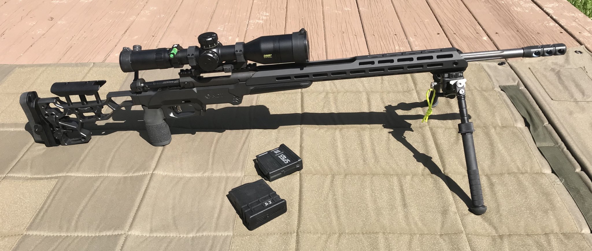

    I have a Savage FCP-SR 6.5 creedmoor in a MDT HS3 chassis with Magpul AR10 PRS stock (Approx $1200) that is currently outshooting my Tikka T3X TAC A1 6.5 creedmoor which costed me $1800.

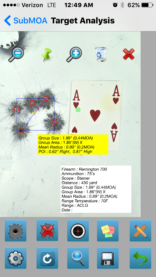

    Savage with hand loaded Hornady ELD-M's I am seeing .5 moa groupings or better (.75 moa with the oem Accustock).
    Tikka with hand loaded Hornady ELD-M's my best grouping is .75" moa only. The Tikka's velocity is also 100fps or slower too.

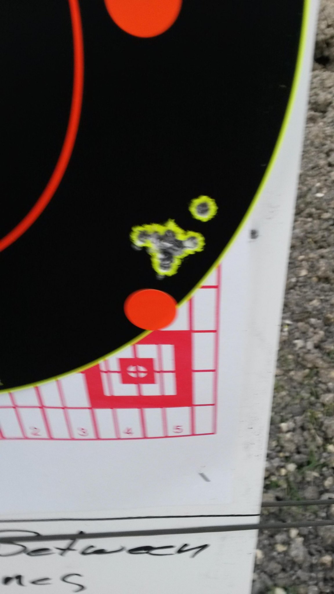

    This is a 15 shot group with 69 gr. SMKs over 24.5 gr. of RE15.
    7115525

    My "down the toilet Remington" sps 223 @ 430 yards. Rem 700 is THE budget rifle because of all the cheap aftermarket stuff that the px is full of. The Savage's do shoot but..

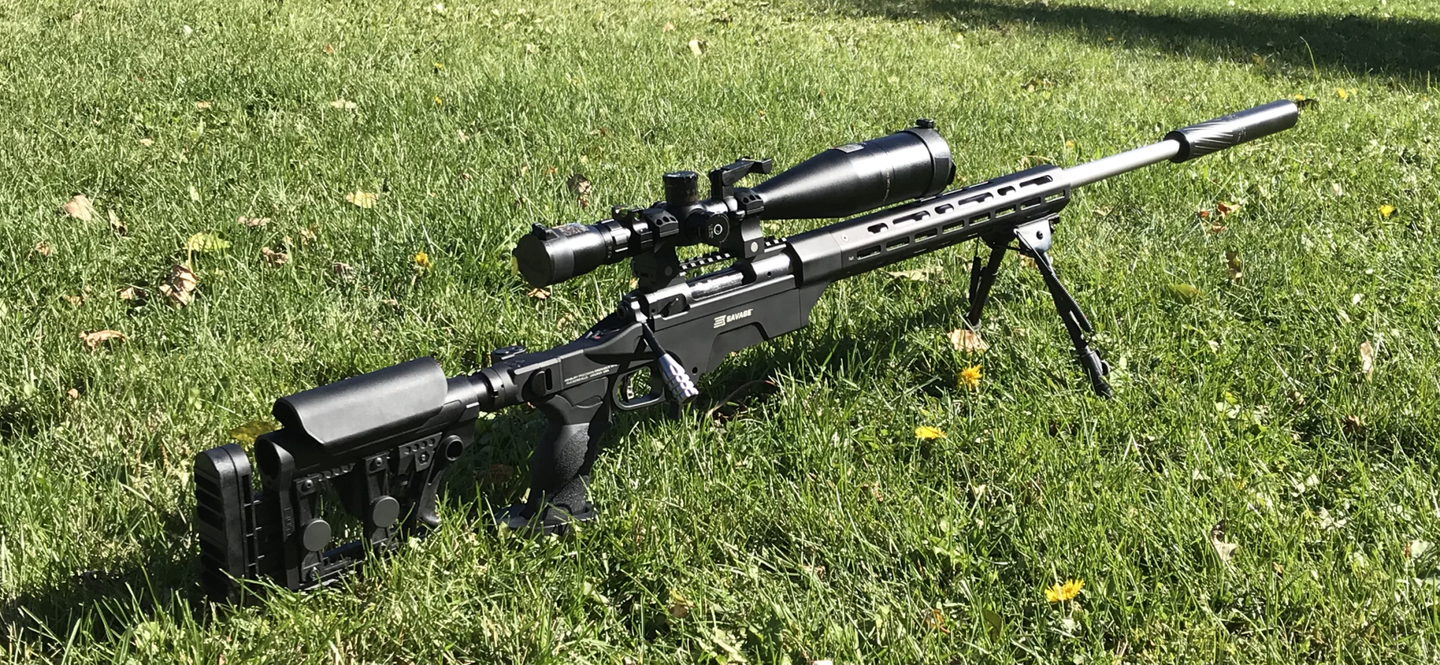

    Couple of my Savages below.
    To be completely honest the 300 WM brown/black gun shoots just as well as my GAP 300 WM. The Savage Accutrigger is better/lighter/crisper than the GAP with a tuned 700 trigger as well. I bought the GAP on here a while back and had the intentions of parting with the savage. But it’s to consistent and perfectly set up for me to part with.
    The black/stainless is a 260 with a CBI 26” barrel. The group shown is that 260 at 600 yards. This gun was previously in a Mcree chassis. Which while not the prettiest gun on the line it did smoke 75% of the other rifles (most customs) on the line at a 1,000 yard F-Class match.

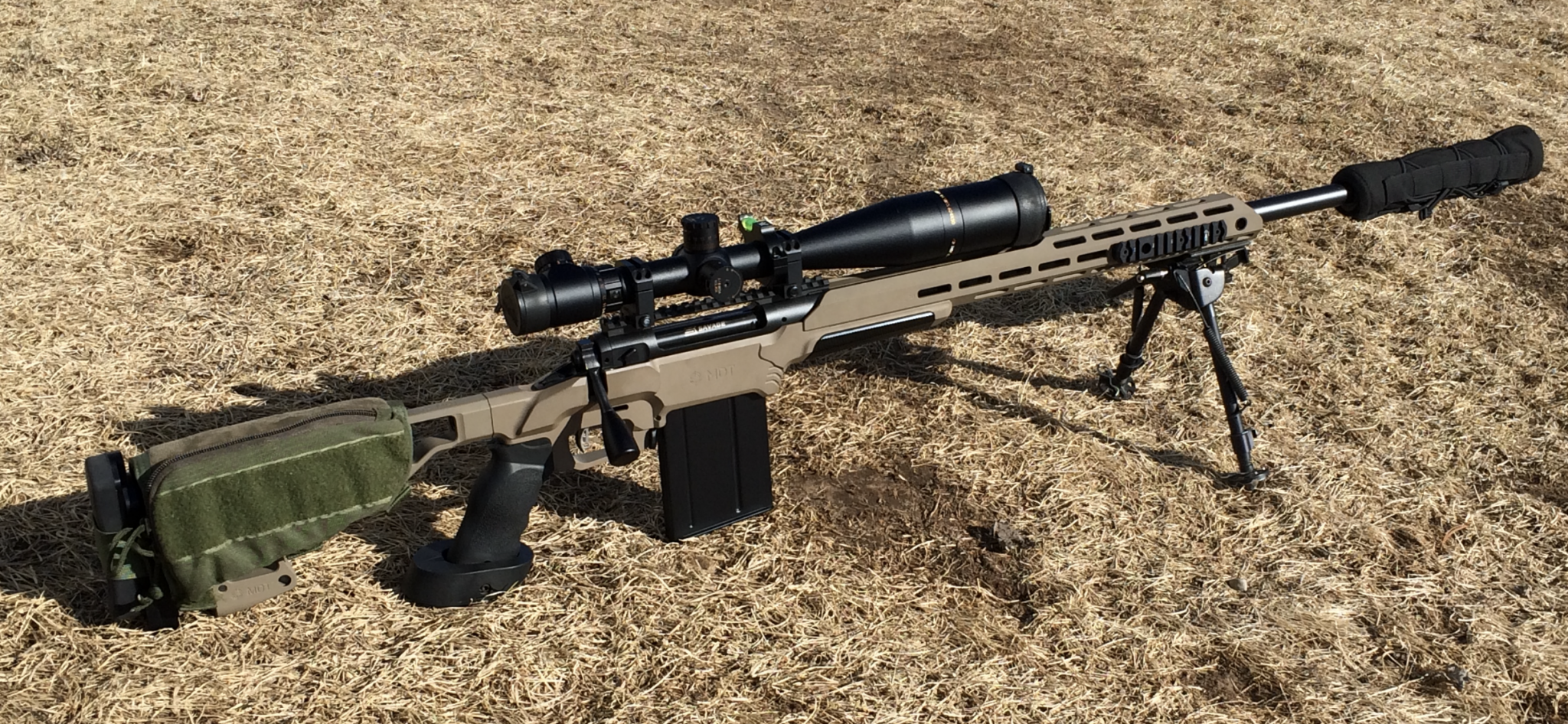

    I dolled up my Savage 10 FCP SR and added an MDT chassis and and XLR buttstock and other goodies and have a standing offer(s) from other shooters that would give most of my investment back if I wanted to sell which I do not. Savages have their following - mostly among other shooters who are not influenced by stuff like resale value (they don't intend to sell the gun) and are more focused on results like group size an accuracy instead of prestige, resale value, or other stuff.
    It's not a "given" that Savages will all develop feeding/extraction and action issues. Mine is flawless coming up on 1K rounds. If I were a competitor in PRS and other rough and tumble games I'd start with something other than a Savage as it will be a better expenditure of $ but there is nothing wrong with the current line of Savage rifles as shooters or as a first precision rifle build.

    I have Savage 10 series rifles in .308 and 6.5 CM. Upgraded both to MDT chassis since not a fan of the Accustock. Both are 1/2 MOA out of the box. Changing the barrel is a breeze too. Wouldn't hesitate to buy another one.
