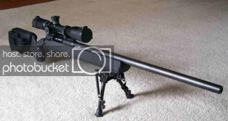

Has anyone out there done just a barrel swap to an aftermarket barrel? Any big improvement in accuracy?

yea i know how you feel, i started with a savage 12 then graduated to curtis and no matter what i do that curtis will not shoot as accurate, but other than accuracy a custom action is very smooth to operate
What are the stats on your Curtis? Who put it together, what make of barrel, etc. Any pics?
