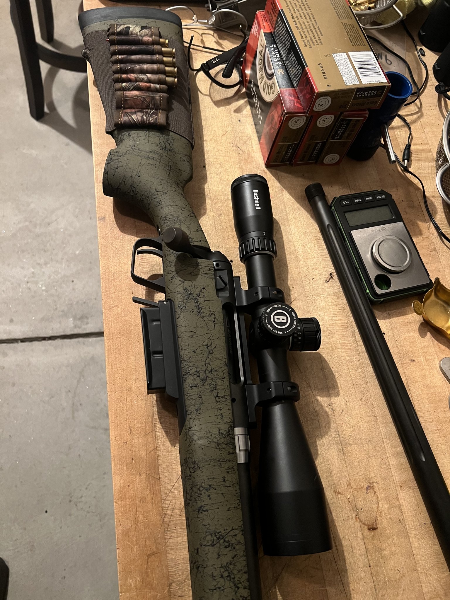

Donor rifle. Did a check. Small firing pin hole. Already has a precision ground barrel nut and recoil lug.
Since I get to pick a twist and know I’m going to run 200 SGK or 200 ELDX, should I consider a 9 or 8 twist?
Suggestion on barrel length and contour.
I’m thinking Sendero at 22 or 23 inches.

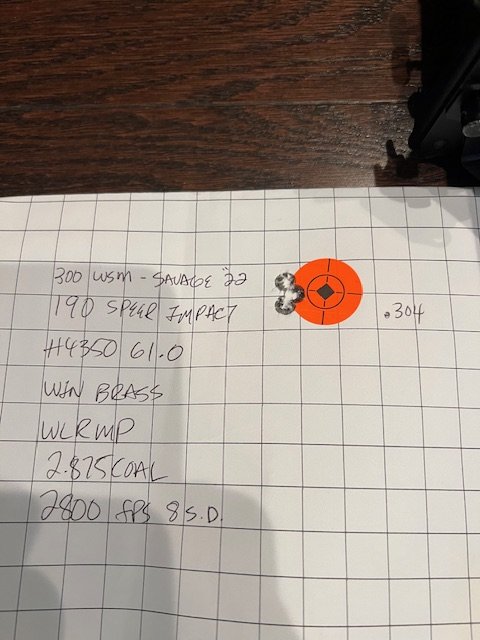

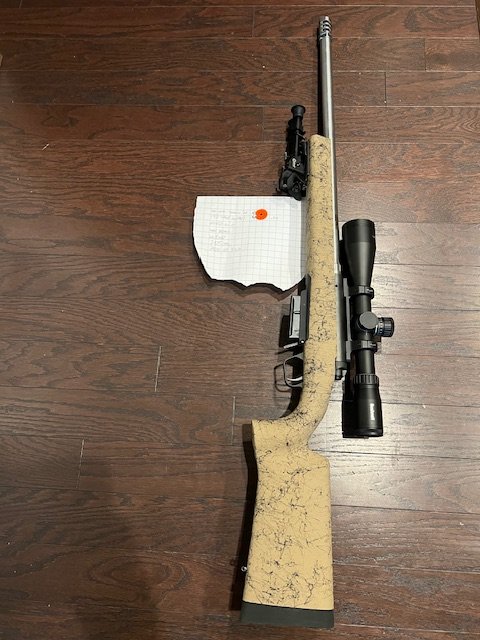

This is a WINNER! Thanks loveha for the help. Absolutely zero issues with function. Rifle is more accurate than me for sure.
Crown barrel works did the barrel. Its working out great as well.
Now...if someone could get me a lead on some brass that would be awesome!
