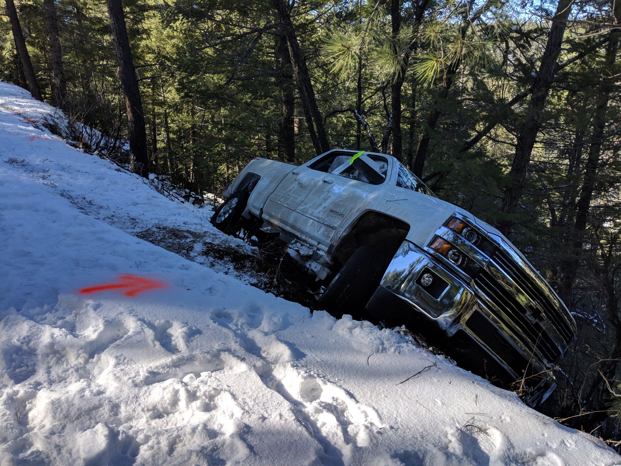

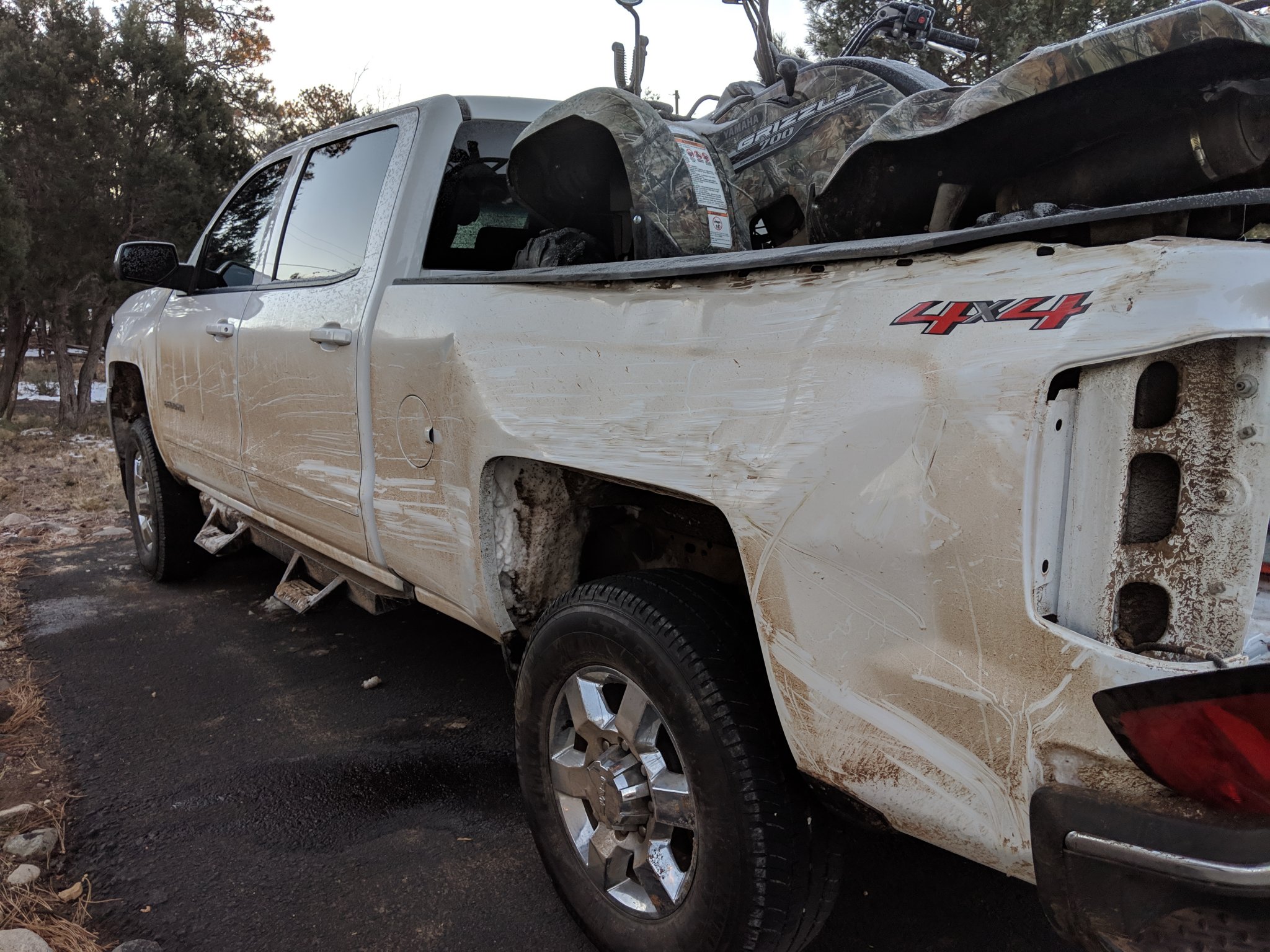

I dozed off. When I woke from the head bob, I was behind on the turn. Truck was in 4H. Tow truck guy said if I was in 4L, all the axles would have been locked in together. 2 tow trucks, 5 hours, and $2200 to get it out. Thank god I have insurance. I wish I would have dozed off in a spot that I would have realized how tired I was. I shot the elk at 1430, quartered it up, and got back to my truck at 1730 and wrecked at 1815. It was 15 degrees and I was so beat, I had to stop every 100 yards to catch my breath on my way back to the truck. I had to to walk 4 miles to get cell reception when I crashed. I walked to the closes camp. As I walked up (with a flashlight), they said that's a good way to get shot, From the dark I replied, sneaking up from behind you without a flashlight would be a better way to get shot. They laughed and waved me in. They offered me a beer but I was so tired and dehydrated I asked for water. He laughed and said, if you don't want a beer, I wont bother offering you whiskey. Side airbags deployed so now I am waiting to hear if it's totaled. I slid sideways at 15 mph. I don't think I hit that hard but it hit the A post and I think that is what activated the system.
