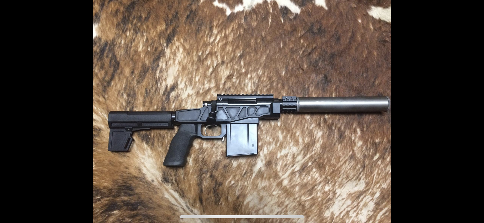

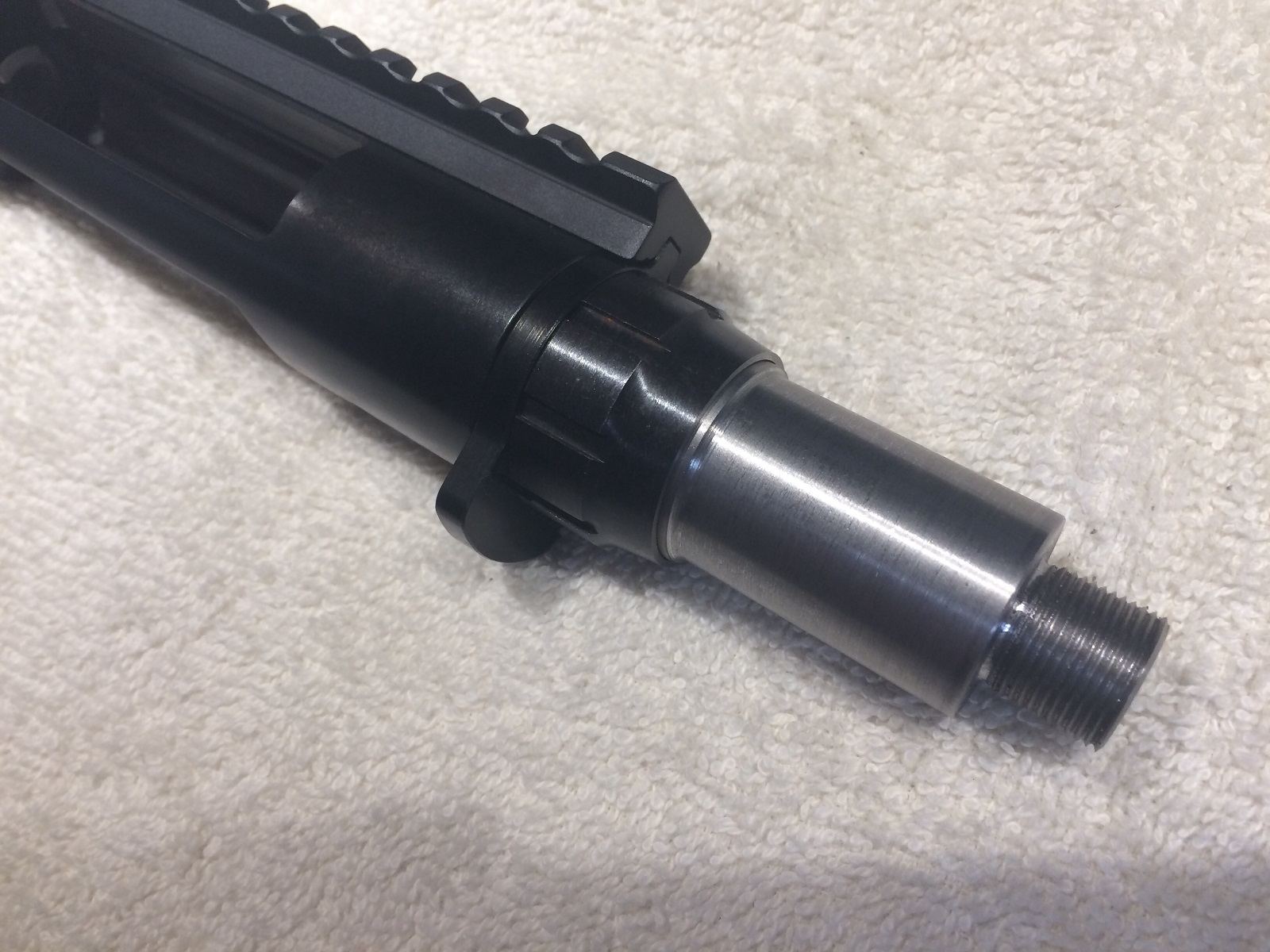

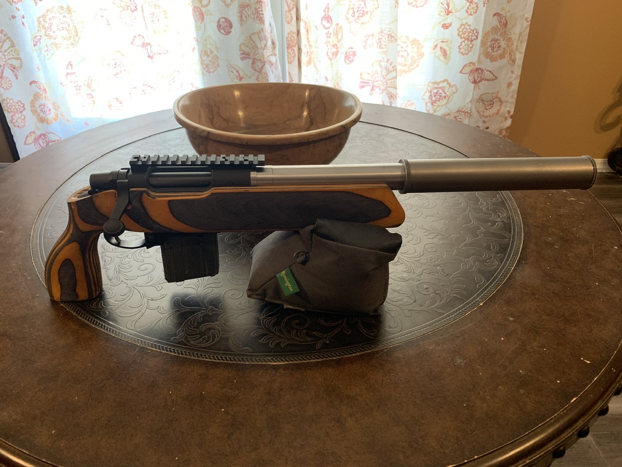

Here is my bolt action “pistol”. 3.5” barrel in 300 Blackout with my F1 silencer. It has a Shockwave brace.

My picture above is a "pistol" because it is less than 26" in overall length. If I installed a barrel, or buffer tube and pistol brace, that resulted in an overall length greater than 26" it would convert the "pistol" into a "firearm". A "firearm" has no minimum barrel length, only a minimum overall length.
Thank you Sir!! May I ask what chassis you have above? Also, where might a guy look to have a 3.5" barrel chambered in 300 BLK.

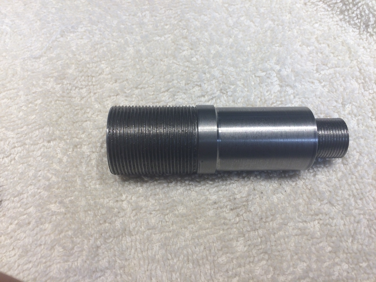

I made that barrel myself using an 8 twist Green Mountain barrel blank. The chassis was a XLR Carbon chassis with the hand guard removed. The railed section on the barrel was meant for a magazine tube on the shotgun. I cut the diameter of the barrel to use it.
Even with a 3.5" barrel I was able to shoot 265g bullets to supersonic velocities. It also stabilized those bullets at subsonic velocities. It was louder than longer barrels though. The action is an American Rifle Company Nucleus. I replaced the X Mark trigger with a Trigger Tech Diamond shortly after these pictures were taken.

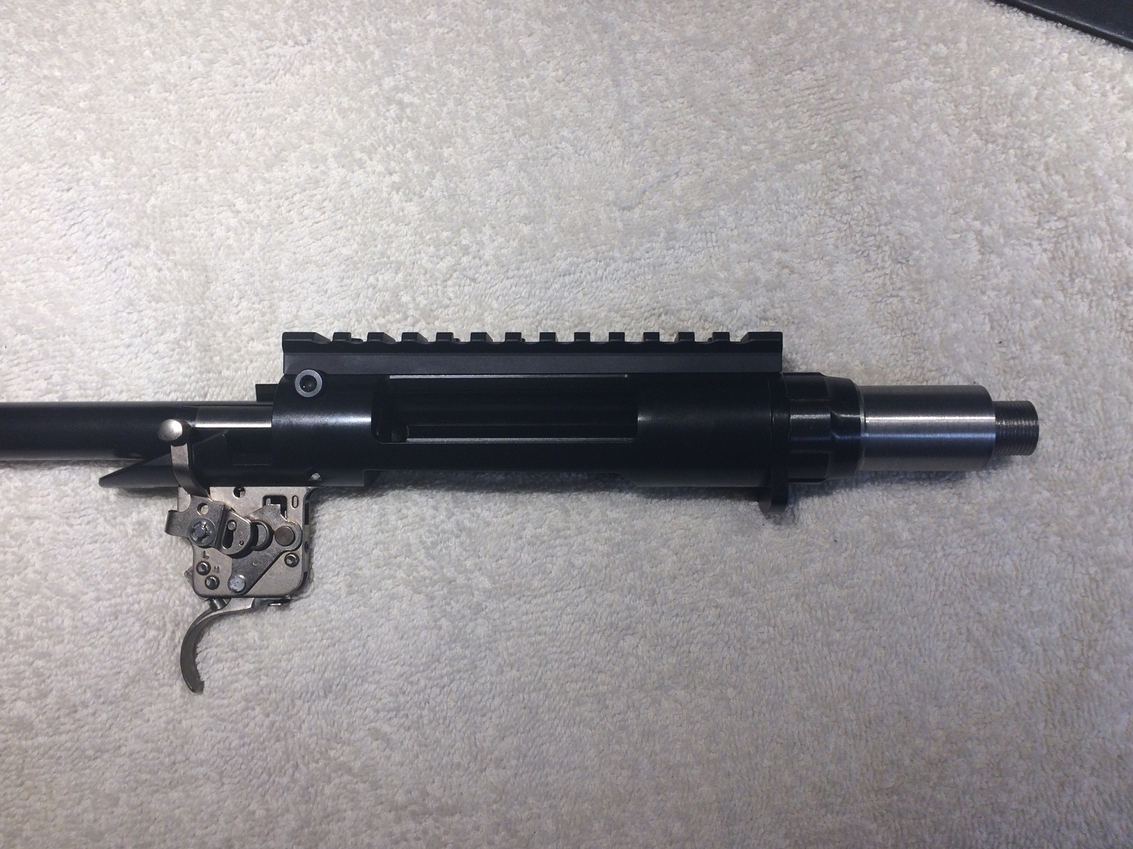

Here are pictures of the action and barrel.

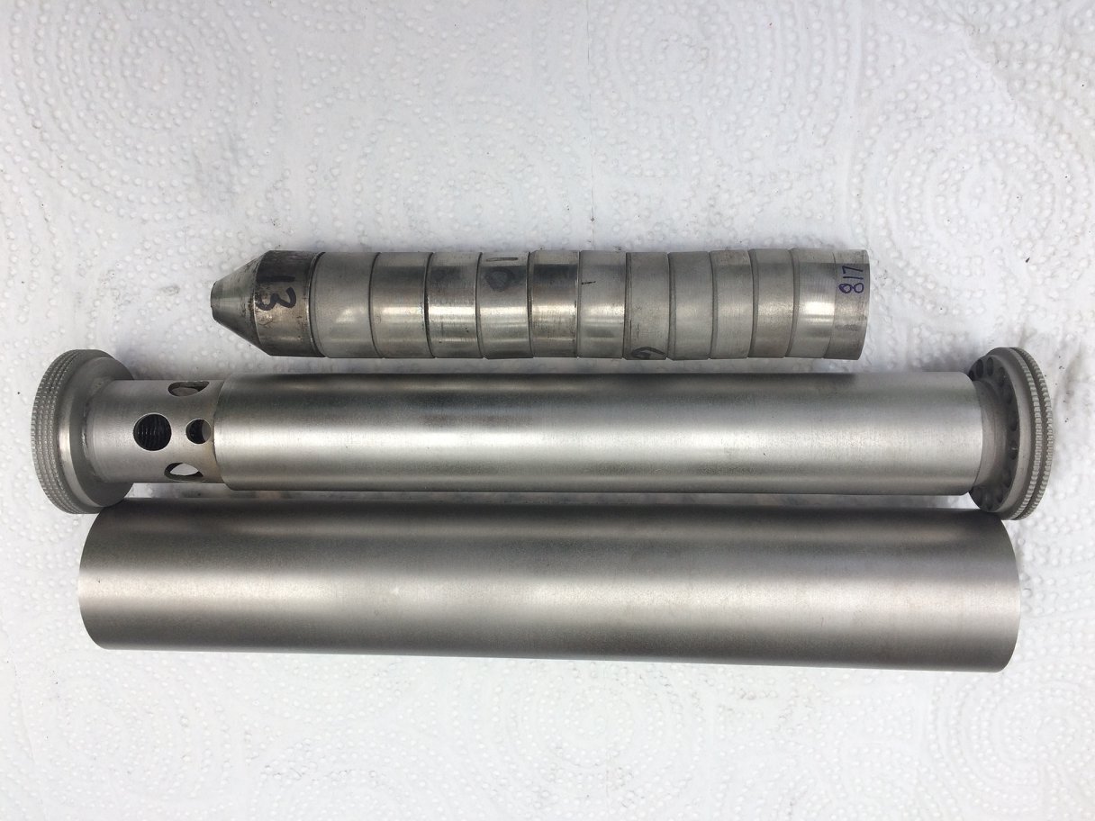

Here is my F1 silencer. It uses a 1.5" titanium outer tube that is .035' thick that is compressed between the two 17-4 end caps. The inner tube is 1.25" .065" wall 304 stainless and houses the 13 cone baffles made of 17-4. The holes in the inner tube vent gasses into the space between the inner and outer tubes creating a very large blast chamber. It works extremely well with both supersonic and subsonic loads.
View attachment 7212107View attachment 7212108View attachment 7212109
What is the purpose of the railed section between the barrel nut and the suppressor? I am really wanting to build one of these. Did I see where you were or are selling the chassis?
The railed section was going to be for a bipod. Never got pictures of it before I tore the gun back down.
I built it mostly so I could go back and forth between a pistol and rifle. Had I built it as a rifle first it would have to have stayed a rifle. I built it as a pistol then took pictures to settle any doubts as to whether it was a pistol first.
I already traded the chassis for another chassis. Honestly, I wish I would have kept it because the XLR Carbon is really lightweight.

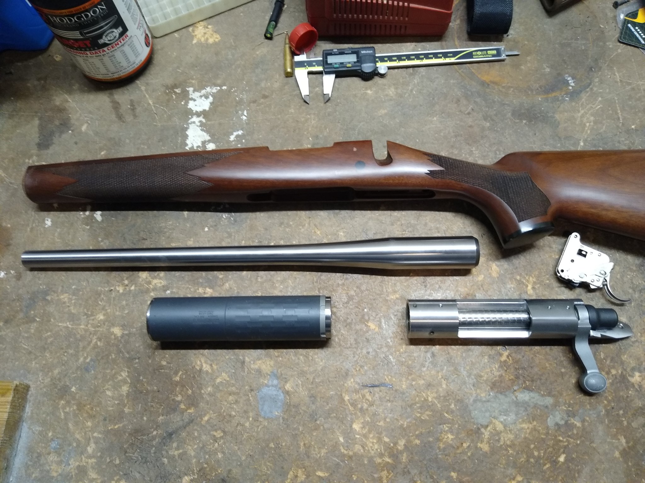

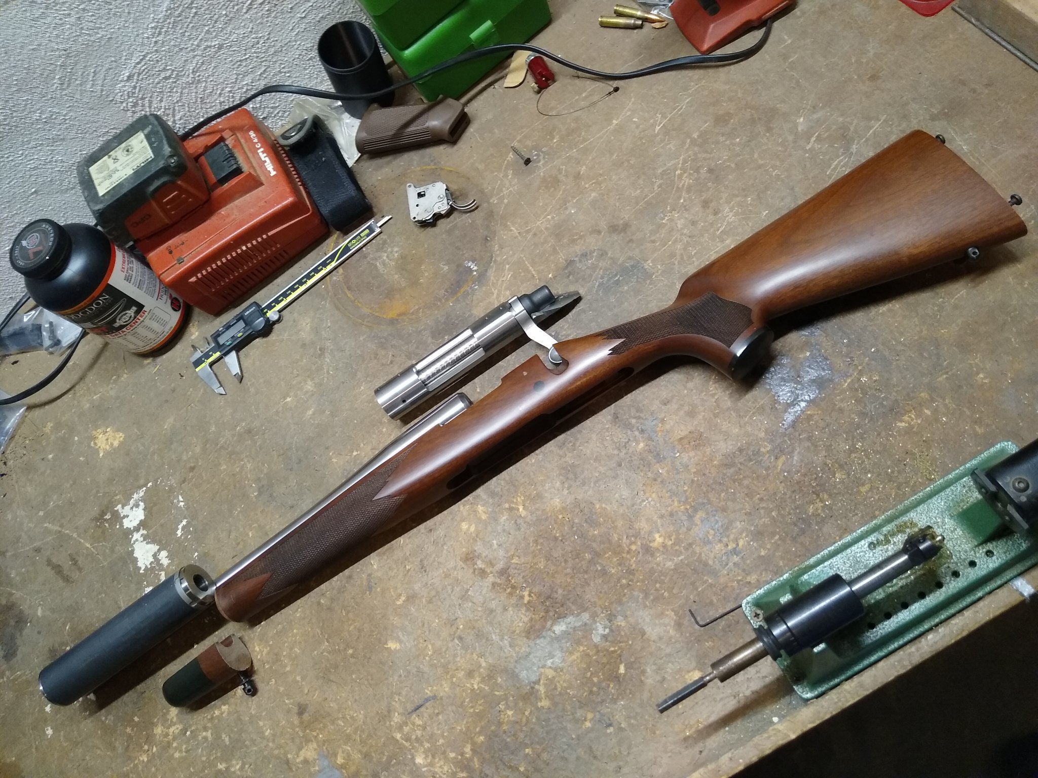

I finally got most of my parts.
I cut of the front of the wooden stock.
Got a xcaliber barrel in #19 contour which is the regular Remington Sporter contour in 1/7 twist and 6mm.
I did a mock up and will end up with around 10" barrel length.
So now I will measure the final rifle length and submit my form 1
In the meantime I will look for a used dbl bottom metal and a recoil pad.
I'm using a standard rem700 trigger for now, and the total cost with the tax but without the suppressor will be just under 1000$

No to resurrect to much dead space but this seemed like just as good of place as any to ask.
My Bighorn TL3 has been a rifle since its first assembly. I've got 4 barrels sitting here that get swapped back and forth for matches and hunting.
Now I'm considering doing a Form1 to SBR the action so I can get a 9" 300 blk barrel for it.
Question is...what are the legalities of having a registered SBR with a full length stock and +16" barrel. Can't imagine it would be an issue as long as it's registered. It's still a rifle.
I'll most likely do the same with my Ar-15 lower. It's currently a pistol...but I plan to register as an SBR and swap uppers back and forth at will , once the Form 1 clears.
Thoughts??
The way I understand it is that that's legal to do, like you said everyone does it with an AR15
But don't take my word for it, hopefully someone with additional knowledge posts here soon
