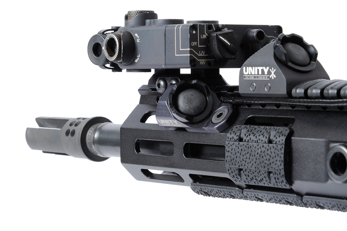

My suggestion is to step back and try to define EXACTLY what role this rifle will play and set it up accordingly as to how you will use it. For example if I were to build another one it would be for a mid range setup. I would have a 12.5" barrel and it would probably wear a 1-6x or 1-8x optic. I would even consider doing it in some other caliber such as 6 ARC. 5.56 would still have the same concept behind it though.
I currently have one that is 10.5" and another than is 9". If I had to do those over about the only thing I would change is using a hand guard that has m lok flats at the 1:30, 4:30, 7:30, and 10:30 positions. If nothing else this gives many more options to mount things like remote switches for lights or whatever (should that ever come up).
Instead of jumping right in to X brand of this or Y brand of that, define specifically what kind of setup you want. This will actually take quite a lot of research. For example if you want to build a shorty for CQC/CQB applications you will need to have at least a loose understanding of the tactics involved in doing that. Same thing for fighting around cars or primarily inside of structures as well.
Seemingly little things such as light placement will matter. Think about that stuff as a first thing, not an after thought after it's all put together. On my two SBRs now, both of them run a light at the 10:30 position and I do not use any kind of remote switches. I planned to avoid wires from the start on those rifles.
If I had something with a longer rail though a remote switch would be a primary concern, which would then help determine where to put the light and what switch. If I did my 12.5 for example I would have my light at the 1:30 position and have a Unity Tactical Hot Button at the 10:30 position. That placement of the button would not be an option with a rail that has 3:00, 6:00, and 9:00 only positions.
You don't need to be an expert in all things tactics, but having a general idea about something specific will help you tremendously in getting right the first time (for the most part).
It seems like a small thing, but the devil is genuinely in the details. This is the type of button mentioned above. Also this picture shows the type of rail mentioned as well. If you think about those types of issues from the start it will save you lots of headaches later on.
You will save yourself some grief if you create a different list. What light do you want? Where will it be at? What mount will you use to secure said light? How will you activate it? Are you going to run a laser/NV/thermal or whatever?
Do you want the options to QD release a red dot and replace the optic with a thermal or something else?
On one of my rifles the red dot is secured with an ADM QD mount. Later on I can swap optics in the field if say I go on a hog hunt at night. Also are you going to be wearing body armor? How high do you want your mount for your RDS?
The list goes on and on. In other words you are starting out trying to figure out which roll mark you like best on which lower, but in reality you need to work in the other direction...
