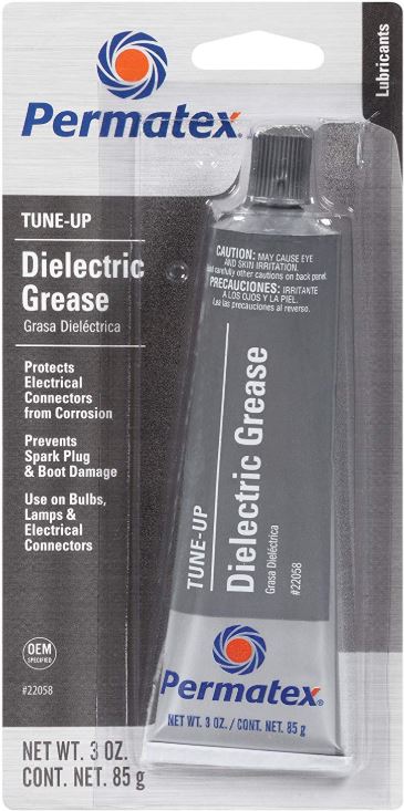

    After you get it really clean, buy some pure silicone dielectric grease (auto parts) and grease everything down with it when you put it back together and you won't have the problem anymore.

    Don't use anti-seize grease, it makes a horrible mess. Get the stuff I mentioned above, you'll thank me for it, I have 2 Sparrows with in excess of 40k rounds through each, most on full auto. I know of what I speak.

    Is this the stuff you're talking about? Found it on Amazon.
