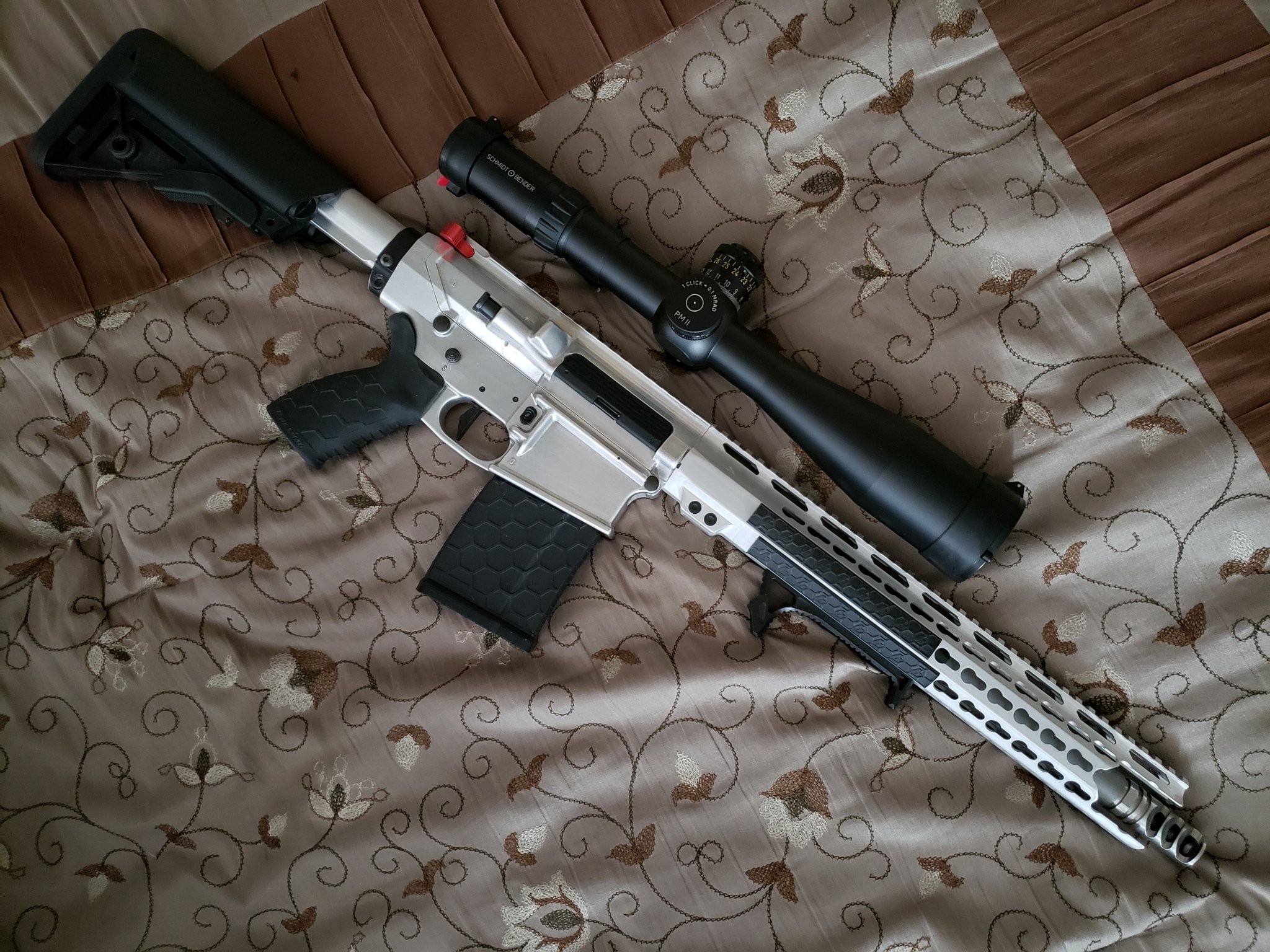

Im in the market for a canted cantilever scope mount for my AR10 build in 6.5cm, not separate rings, and with a minimum of 20moa that will For Sure fit a Schmidt&Bender PMii 5-25x56. For those not aware, Schmidts have a specifically small area u have to use, on the tube body directly in front and behind the center knobs. Also, the illumination is mounted near the mag ring and that means even more tube mounting area is gone. Ive seen the Spuhr ISM cantilever mount in 20moa and know it works for sure, but are there any other options for less that can do the same job respectively? If I have to I will buy a Spuhr but Anyone Know if there are Other Options?

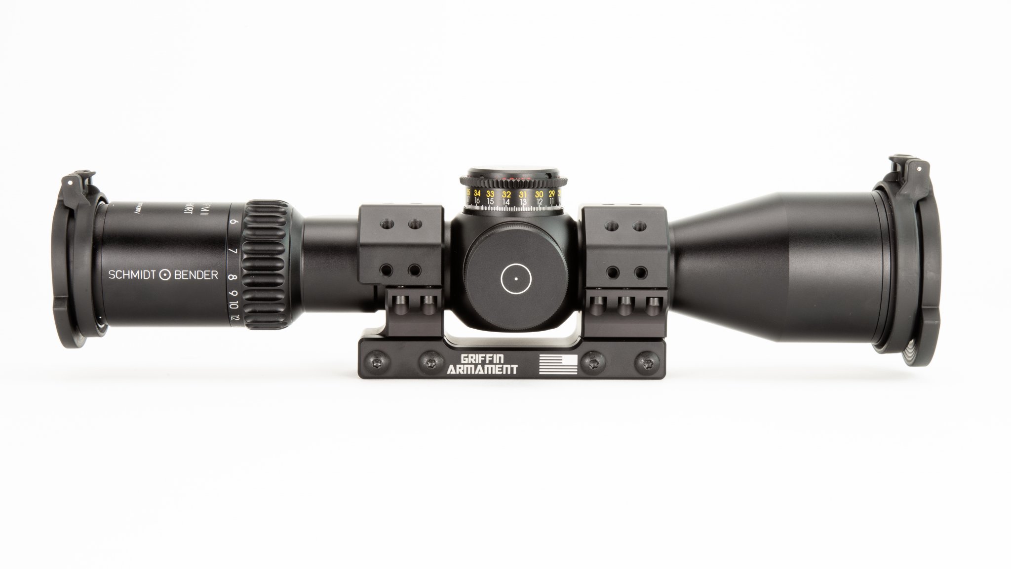

Since you have a white rifle a @GRIFFIN_ARMAMENT sperm mount might work.

My rifle is raw aluminum silver so yeah, dont need a white mount??‍♂️

The griffin mount can be any color you want to match your whatever color of the rainbow your lil stick there wants to do be

Badger makes a 34mm unimount with 0 or 20 moa of cant built in, their “PSR” mount was specifically designed for the PMII 5-25.
I did call S&B this year to ask about this and was told by their tech Jerry that there IS optical quality tradeoffs at your 100m zero when you have the max cant like 40moa on your rail/mount. After talking with him I decided that 20 moa total, rather than 40, was better for my needs.
