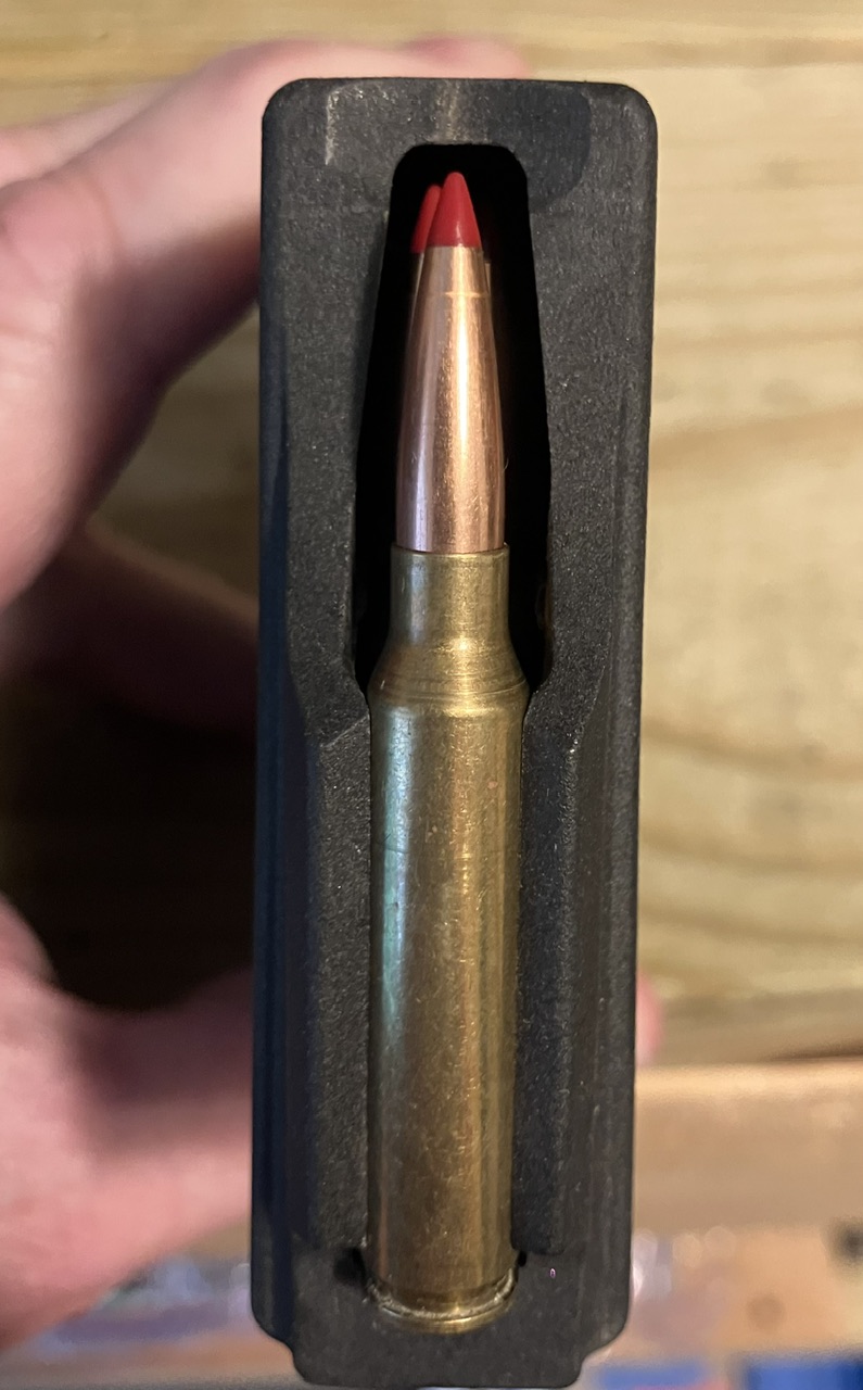

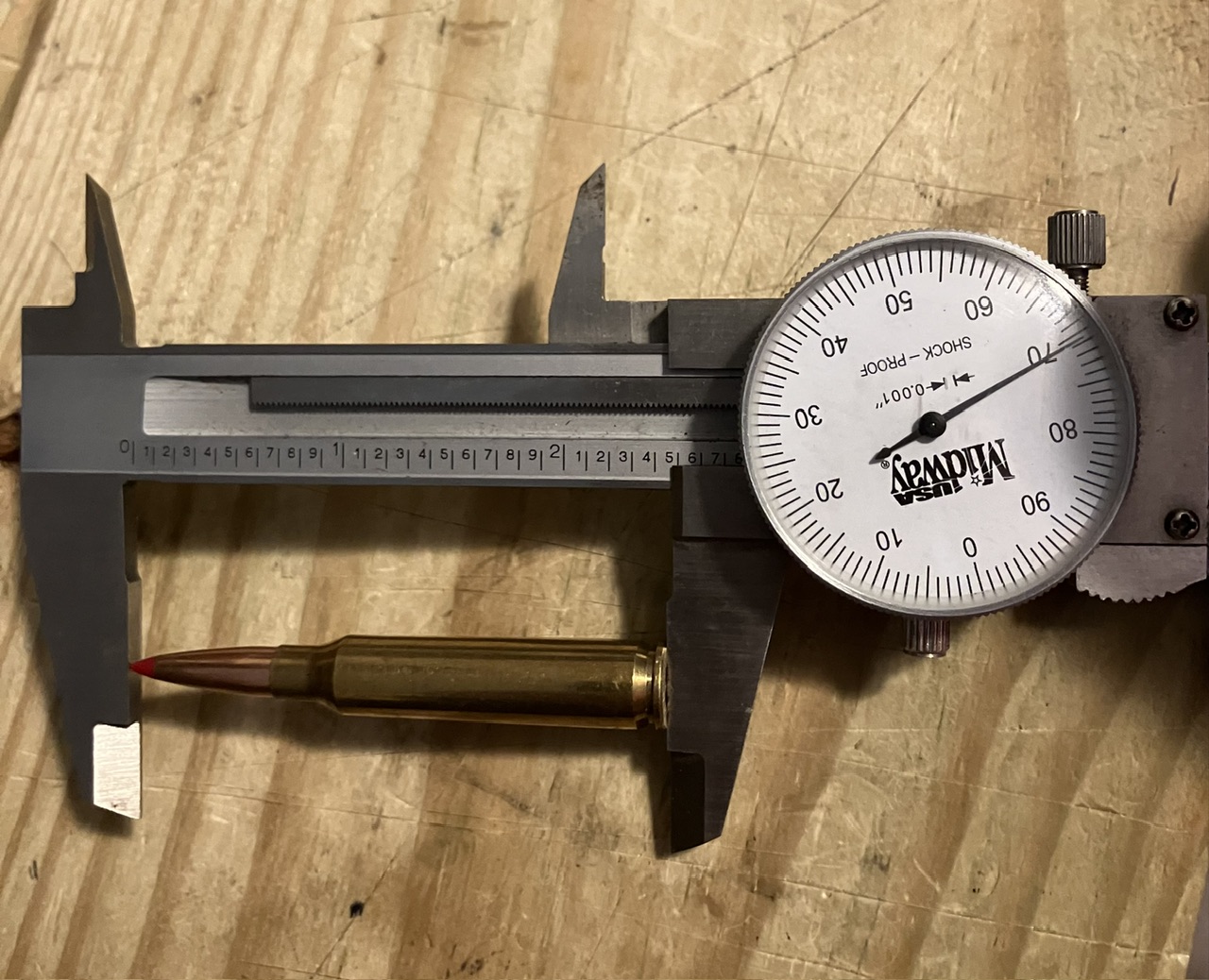

Update- the old style MDT poly MAGS with the longer OAL are a no go with my aero Solus in a KRG.
Bought two and neither will feed.
Now looking for a metal mag or a Ruger AICS.
This is the style I tried with no success.
Why won’t they feed? What is happening?
Bullet tip hits the back of the barrel about 3/16” below the chamber. This happens every time regardless of magazine height and regardless of how many rounds are in the mag.
If the barrel had a conical breech, I think they would feed fine. If it were a metal mag, I could probably tune to the lips and resolve the issue.
The exact same thing happens with my .223 in a Solus action with Accurate Mags. I can’t physically push the mag high enough up to make it feed, so a longer mag catch won’t fix it. The tips just slam into the breech face. I’m going to try the Ruger mag next.

What stops the magazin?
Its because they keep the round forced too flat and dont let it tip up. I have yet to find a place where they work well, they best I have been able to do is only the occasional mid mag hiccup but thats only in a krg bravo... and the last one and two are hitchy and require a stop and resume pushing forward, other chassis they simply refuse to feed well at all.
The fat ass plastic feed lips

I think I can see what the problem is looking at my Solus action. The shoulder of the case doesn't hit the ramp before the bullet hits the barrel. So there's nothing pushing up the case. My other guns are being pushed up by the actions feeds ramp before hitting barrel. Not sure if the feed ramp is lower because of the 6 o clock lug or the angle is just simply different.
