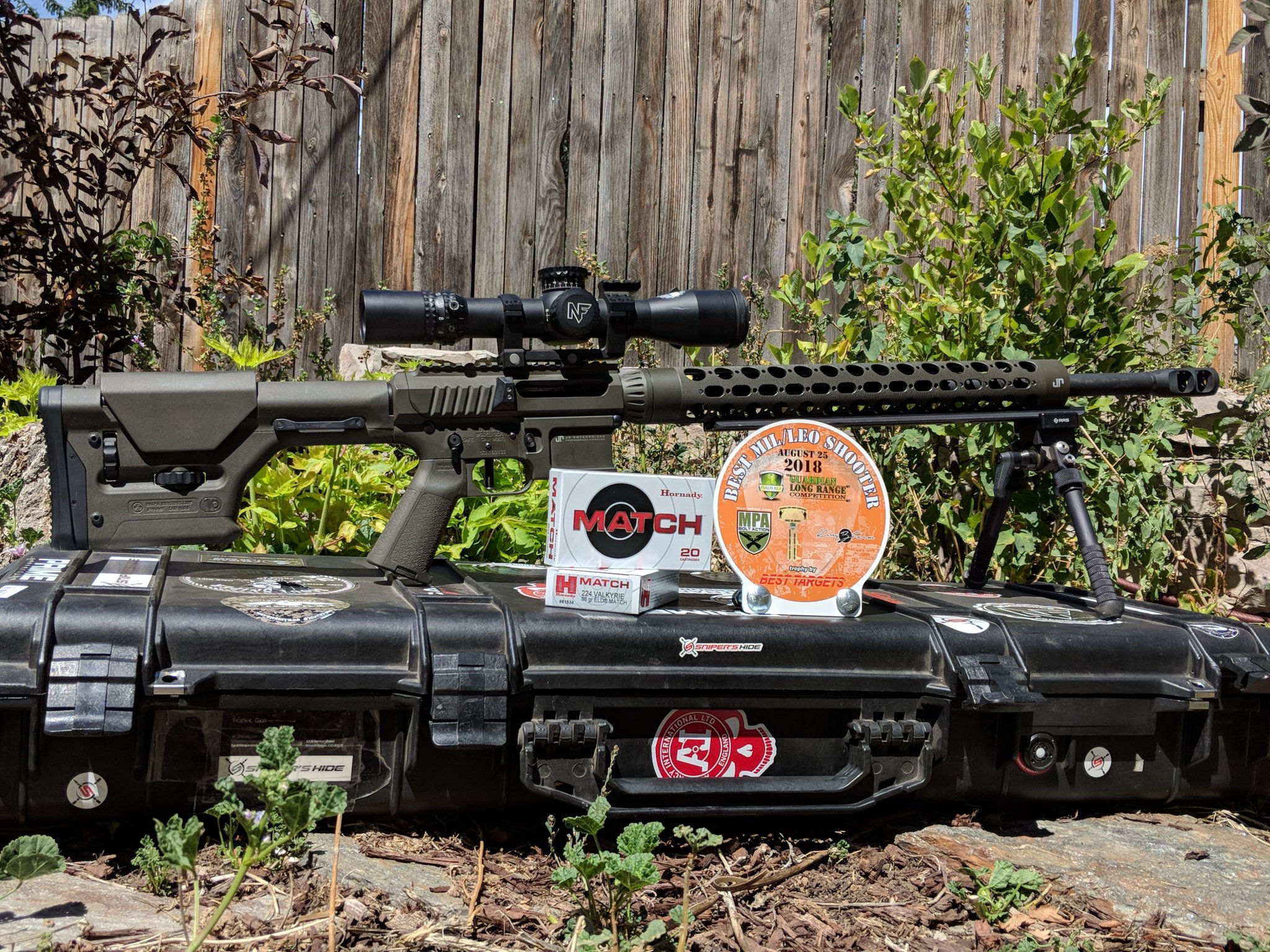

If I ever buy another AR, it would be pretty much what I already have:
LMT SLK8 (MRP) with 16" 1:7.5 SS barrel
Battlecomp Brake
Magpul MOE-K2 Grip
Raptor SL Ambi Charging Handle
Magpul BAD Lever
SOPMOD stock (if RDS) or Magpul CTR w/ RISR (if LPVO or Scope)
Magpul Pro BUIS
LaRue MBT
Optics: (one of the below)
Larue QD w/ NF ATACR 1-8 (LPVO)
Larue QD w/ NF ATACR 4-16x42 (Scope)
Larue QD w/ Aimpoint (RDS - either a T1, T2, or CompM5)
Mags:
30rd Mags: USGI Aluminum or Magpul Gen 3 window mags (doesn't matter)
20rd Mags: Aluminum w/ the upgraded followers (I prefer these to the Magpul 20's)
Sling:
TAB Gear Carbine Sling w/ QDs
The above (albeit with my MK6 3-18x optic) shoots predominately sub-MOA at 100 and 200, with my best group being .49" at 200yds with Defender 77gr SMKs the other day (total luck with that .49" group but 1.25-1.75" at 200 is normal). Ripped the scope off and used the T1 Micro out to 425yds with boring hits on full-sized steel (as expected). Used to be able to run it to 600 but the targets are gone. If you can't kill it within 400 with an AR topped with irons or a red dot, then there isn't a point in having it.
For most shooters, any half-ass quality AR (be it kitchen built or factory made) will get them out to 500yds on man-sized targets with 62gr shit ball ammo. They've been doing it for decades with boots in boot camp. Unless you're buying a $300 gun show AR-15, you won't have a problem reaching out to 600. If you aren't someone who takes the time to clean your shit and hates busting carbon, then go piston instead of direct impingement. That being said, you're only gaining a benefit with a piston if you're running full auto and/or suppressed.
End of the day, you can buy a complete quality system (no glass) that will outperform 90% of shooters out there for around $1500 or less, especially in the SH PX).

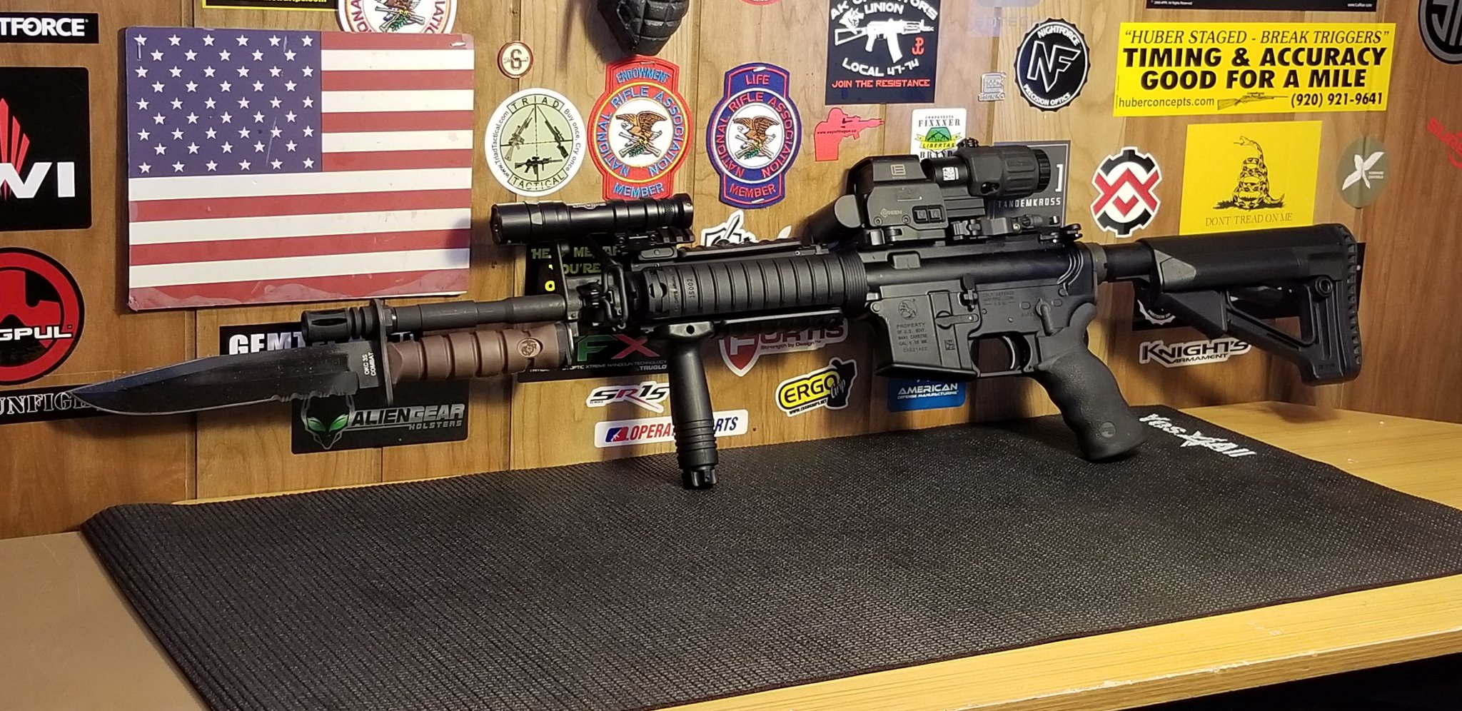

Consider something along the lines of a Socom URGI or M4A1 Block II. 14.5-16” chrome line 1:7 rht barrel, match trigger of your choice (I run CMC super match) high quality charging handle of your choice (I like the radian raptor) and quality BCG. Attach a Muzzle device of your choice. I like chrome lined barrels for hard use, barrel life and ease of maintenance (I clean it every 300 rounds or so). Stainless is more accurate but doesn’t last as long and requires more cleaning.
For optics I like and use a combo consisting of a NF 2.5-10x24 Mil/Mil Mil-R and an Aimpoint T1 in a larue QD 45’degree offset mount.
The nightforce is zeroed for 200 yards and the aimpoint 36 yards. I have no problems hitting 8” discs at 300 (poa/poi using the aimpoint) and 200-600 using the NF dialing elevation and holding wind...I run black hills 77g smk 5.56 NATO and Hornady Superformance 75g 5.56 NATO.
If 5.56 isn’t your thing but want to keep with the small frame AR, consider 6.8 SPC, 6.5 Grendel or .224 Valkrye.
If I had to do this AR thing all over again I would get a factory SBR then just buy a precision upper for use when needed. I would also make sure to upgrade to a two stage trigger. All I have now are AR’s with my name engraved on the lowers, no resale value.
Reactions: ccasanova
