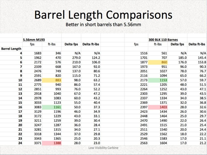

Here is a dandy chart showing the difference between 5.56 and .300 blk.
If you want a 5" barrel, go with a pistol caliber.

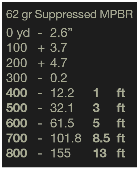

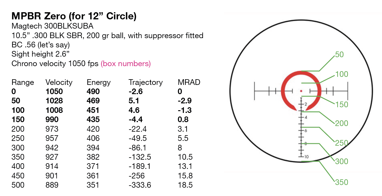

FWIW, staying off the 5" topic, here's my 12.5" + suppressor range card as glued to the top of the scope cover.
Multi-foot holdovers are hard so I rarely hit point targets with those, at least not right away but it tends to surprise the people who think 5.56 is short range and anything less than 16 is hopeless when I get easy hits at 3-400 yds. And I am not that great a shot.

You really should consider a 50 or 200yd zero with that one. That will be 1.3” high at 100yds with M855, 1.4” high with M193 even though the M193 is faster. BC of M193 gives it more arc due to rapid velocity loss.
Think partially-exposed targets and how your rounds will wizz over heads using the 300yd zero. The Army’s 25/300m zero is a really bad idea when it comes to zeros for that reason.
10.5” with Mk.262 just for illustration:
iu
Reactions: long range sponge
That's a Maximum Point Blank Range zero, so theoretically as long a (12"?) point blank zone as I can get, because I had poor performance and weird holds trying the 25/200 zero with that particular gun. It just /happens/ to be close to zero at 300 m/yd, but I didn't do that on purpose.
Still got precision guns at 100 yd zero, most rifles at 25-ish / 200, but trying MPBR and it seems clever for some things like this.
ETA: for someone like me being a hobbyist so I do sorta everything with the gun as the fancy strikes me. I can imagine many jobs where you have friends with other guns, it would make much more sense to make the short carbine a better 0-200m gun, as you propose. Roles matter, indeed.
What kind of scope are you using, and are you converting from inches to angular units and back to inches to make your hold overs? Wouldn’t listing holdovers in moa or mrad be easier?
Good point also. This one is RDS + magnifier. The holds are in feet because I guesstimate based off target size, terrain features, etc.
For my dialable / millable scopes I keep it all in MRAD. As a short barrel example for the fun of it, here's the .300 subsonic where it stands now (not finished picking a load as you may expect due to timing, etc so just a working sheet, not taped to the gun yet). I can hold, or dial, in those units.

At the muzzle on a 6" pistol shooting 193, you are getting 2200 fps
That is the same velocity you are getting from a 20" barrel at 300yds
I've not heard one person argue a 20" rifle is ineffective at 300.....ever
So yes.....at 20 feet, it's not going to make any fucking difference wether you shot the guy with a 20" or a 6"......

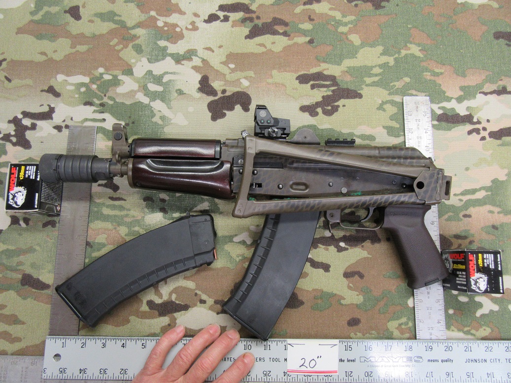

SBR . Go to the Dark Side, ... LOL .. 8.5" barrel and fold stock Krink , with 5.45x39
The AKSU-74's 8-ish" barrel was driven by space requirements, gave marginal performance even with an increased twist rate, due to loss of velocity mostly. Note the current carbine verson, the AK104, has a ~12.5" barrel. Hmmm... almost like 22-ish caliber projectiles all have to follow the same laws of physics or something :LOL:

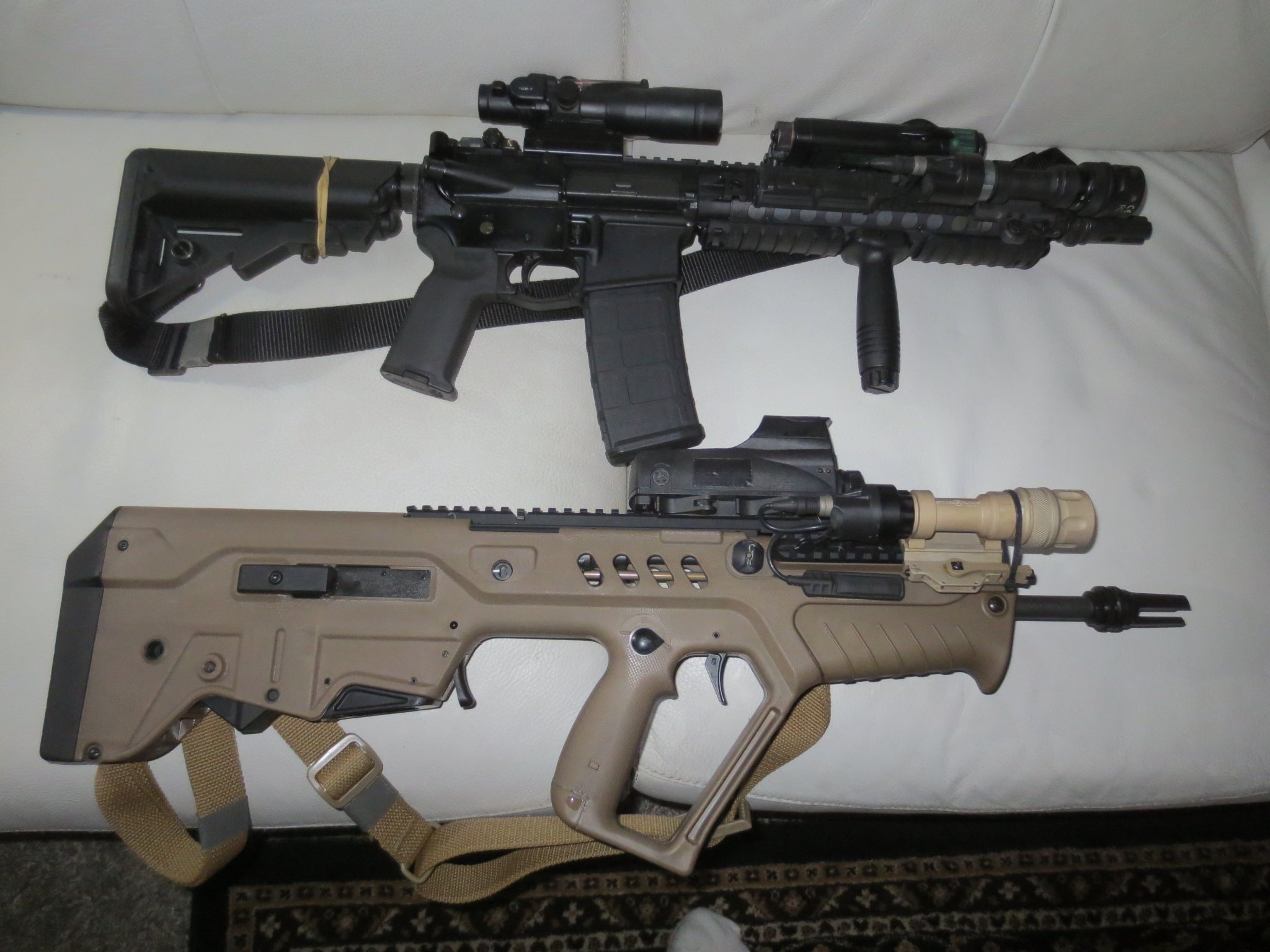

Consider a Tavor. Sort of the AK of bullpups, they're super reliable, super simple, well thought out weapons. This one is 9mm, comes in 5.56, .300blk and there are conversion kits for all 3. SAR is the older one, the one I have (but it integrates the laser switch on the Mepro MOR into the handguard, had one already so had to have it...). Compared to an 11.5" SBR, it has a 17"bbl. and of course far more energy. In 9mm, it pretty much maxes what the round is capable of and +P+ hit pretty fucking hard. It's also a serious defensive weapon, not a toy, and it's not all that expensive for a used SAR. $1350 is what I paid for this one earlier in the year. Less than that SBR cost to build. It's "accurate enough", it'll do 4" at 100. Probably in 9mm too, I haven't tried. Little recoil, easy to manage, nice little rifle. I love mine, got it as a 9mm toy, now I want the 5.56 conversion since it actually sees use.
And it doesn't require a tax stamp.
Only upside to the brace bullshit is it allows me to carry that weapon loaded in the vehicle or concealed --technically it's a pistol. But I never expected that to last for as long as it did.
+1 on the Tavor. I also have the earlier SAR and it is a great gun. Very reliable and fun to shoot. It takes a while to get comfortable with the layout if you're used to an AR, but not really that hard to pick up. Takes AR mags, which is nice. They are a little heavy, but most of the weight is at the rear, which makes them very easy to handle and shoot offhand. Smaller than a lot of SBR's but with a 16" barrel.
Honestly, I think some of the accuracy issues is that they are hard to bench. With ammo it likes you should be able to get at least 2 MOA.
I do think they require a couple of upgrades though. The stock trigger (especially in the SAR) sucks. Geissele makes a pretty good replacement trigger, and it just drops in so installing it is a snap. Of course, it's expensive. Also, as you can see from the above picture, rail is basically even with the top of the stock. This means you're going to need a very high mount, or to add a separate picatinny rail to the top of the existing rail to mount optics to - at least if you have a fat face like me.
20 inch OAL on the fold
Oh yeah, they are short, and short things are fun. But just imagine if the Soviets had not cheapened out (by going with tiny service rifle) and adopted something more like the original concepts. THIS takes full power 5.45. Yeah, magazine as pistol grip (I assume for stowage as a PDW most of all. Nothing sticks down):
