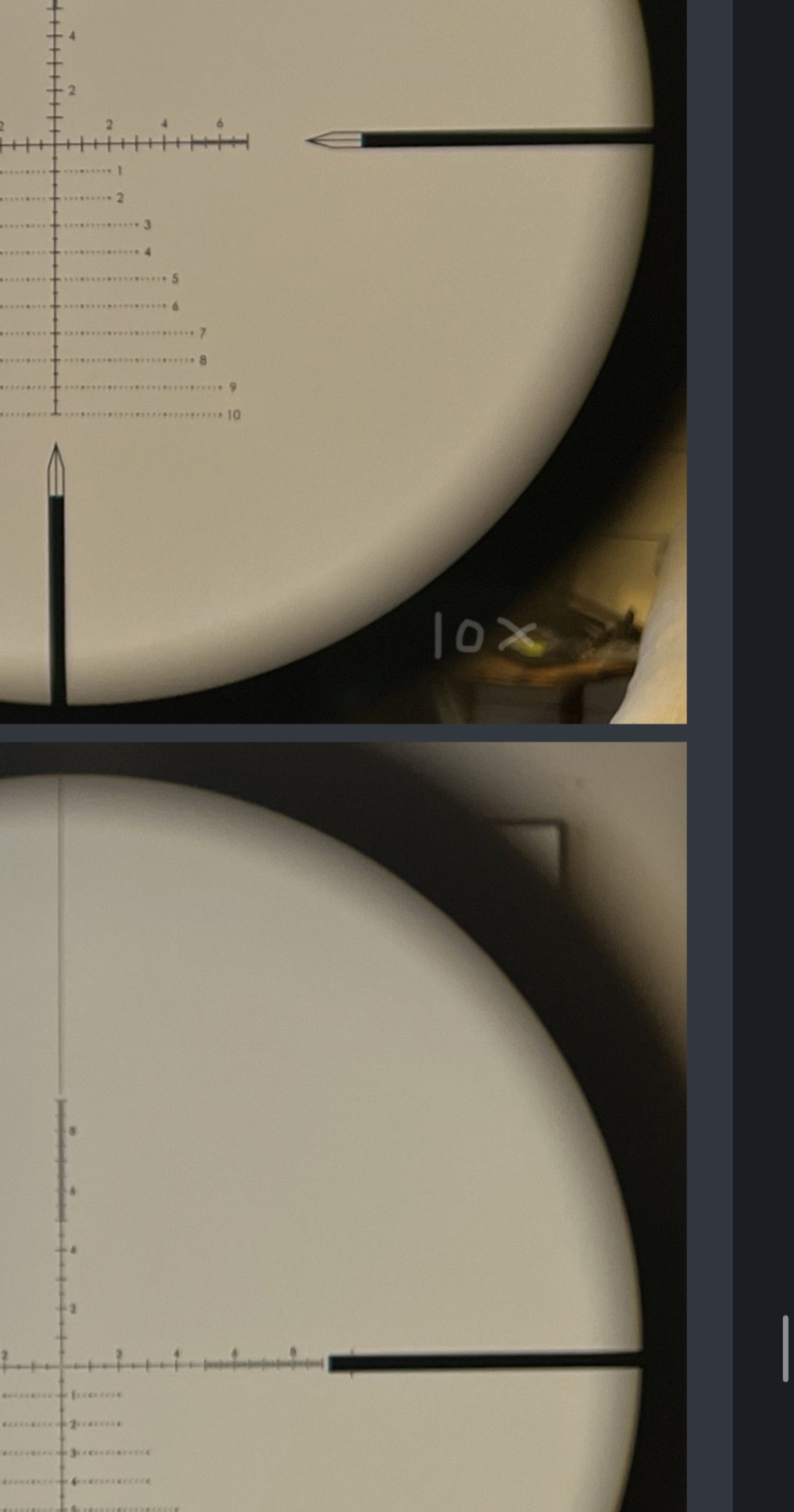

The higher the maximum magnification, the more the reticle "shrinks" as magnification is reduced.
Let’s take two scopes with the same crosshair thickness (say, 0.03 mils):
- 3-15x
- 4.5-27x
Are you saying that at the same magnification (10x) that the 4.5-27x reticle will be smaller than the 3-15x? As in the distance between mrads will be shorter?
Because if that’s what you are saying, I believe you are wrong.
One of these scopes has a much higher top-end magnification than the other. Can you guess which one?
Both of these scopes are at 10x. One has a slightly thicker recticle ~0.034 vs 0.03, but don’t let that distract you…of course a thicker reticle will appear thicker/bolder at the same mag. And one is slightly more out of focus. No big deal.
Don’t make me break out photoshop to prove that the distance between mrads is the same lol.
My bet is there might be small opto-mechanical or perception-based differences between the scopes I listed at the top of this post, but in general, the mrads are going to measure out the same at a given mag across scopes.
@koshkin
Reactions: DM1975 and FuhQ
For a quick and dirty alignment, just zoom in and use the edge of your display, like this:
Mind you that the camera wasn’t perfectly square to the reticle. There is some skewing, especially on the right side, as I was handholding the phone. And not everything is square. But I think you get the idea.

I have a vortex viper pst 6-24 erb-2c on my rimfire gun. Good enough for local competitions. Not ideal if you need to shoot closer than 50y, but that was never a problem when I was shooting competitively.
That's what I'm saying. I'll either verify the statement with photos - or recant it if I'm wrong. I'm basing the statement on my perceived differences between the reticles of a gen-3 Razor 6-36x56 and a ZCO 527 (MPCT2).
I have a match tomorrow plus other obligations so it may well be Monday before I get back to this... but now you have me curious as to whether I'm representing my perceptions correctly.
Ok. Of course you’ll run into small problems aligning the magnification between the scopes in question…I don’t know how to set two different scopes (different mags and brands) exactly to the same mag. Perhaps one needs fancy tools, or fancy knowledge. Or both.
