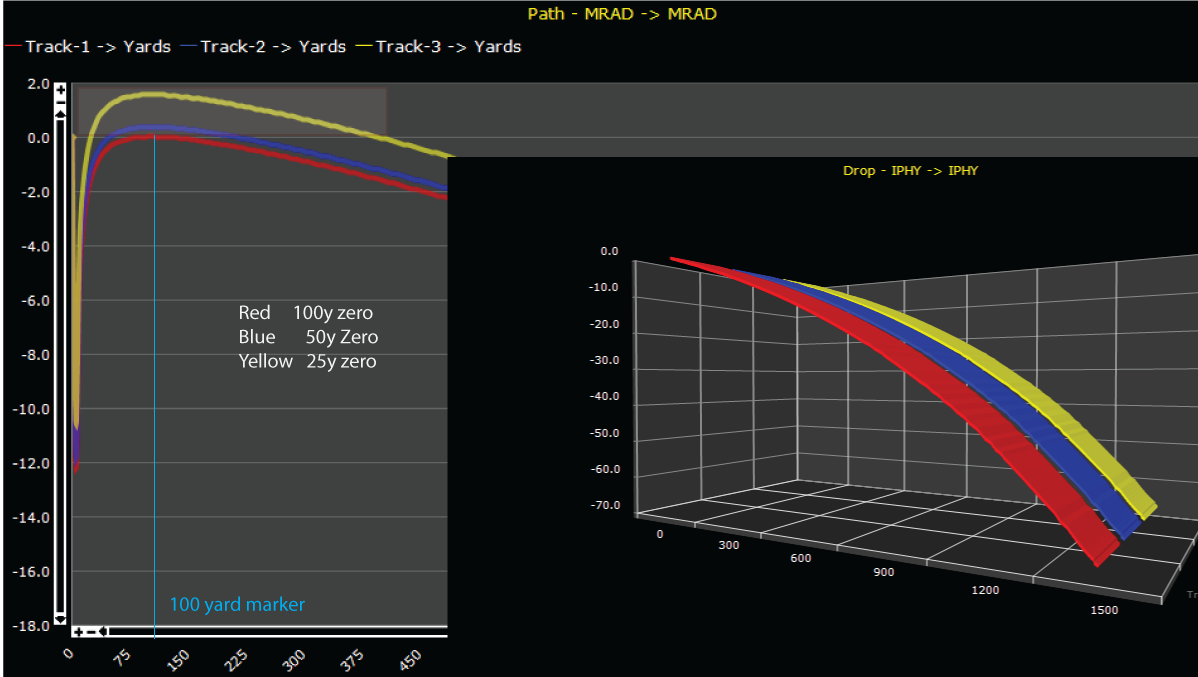

Here is a quick printout I ran for you from ColdBore, all the same except for the near zero. Hope this makes it easier to understand, why the 100 zero is better and doesn't end up higher at 200.
PATH:
Red is 100y, Blue is 50 and yellow is 25y. The light blue vertical line is the 100y crossing. For all practical purposes, the 100 zero's near and far are the same.
DROP:
Notice the the "Drop" is the decay of the bullet that takes place the minute the bullet leaves the barrel. This happens regardless of the angle of the barrel for the zero set.
