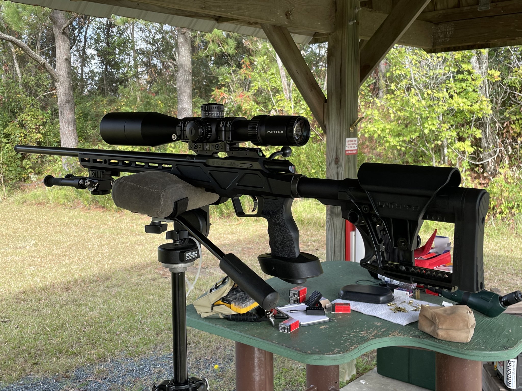

In my opinion the absolute best buy in a scope today is the Vortex Strike Eagle 5-25X56. I personally prefer the reticle in MOA, which has 32MOA tick marks above center, and 36MOA below. That makes for a whole lot of hold over if I’m on a clock and have no time to dial the turret.
As for rails, generally it’s best to go close to half your scope’s possible adjustment range in rail tilt (SE has 110 MOA of adjustment, a 50MOA allows dialing a 50yard zero easy).
Reactions: camocorvette
Unless your barrel is severely misaligned with regards to the receiver rail, most any scope will adjust up the 7” or so for a 100yd hit with an initial 50yd zero.
If you take to shooting either tiny targets inside of 100y, or steel out to 500yds, I can’t recommend a first focal plane (FFP) scope strongly enough. This means that no matter what magnification you choose, the reticle and target will always be the same relationship of size. People get hung up on Mils vs MOA turrets and reticles, I say pic a reticle you like, and just make sure the turrets use the same values.
As for rails, generally it’s best to go close to half your scope’s possible adjustment range in rail tilt (SE has 110 MOA of adjustment, a 50MOA allows dialing a 50yard zero easy).View attachment 8170275
