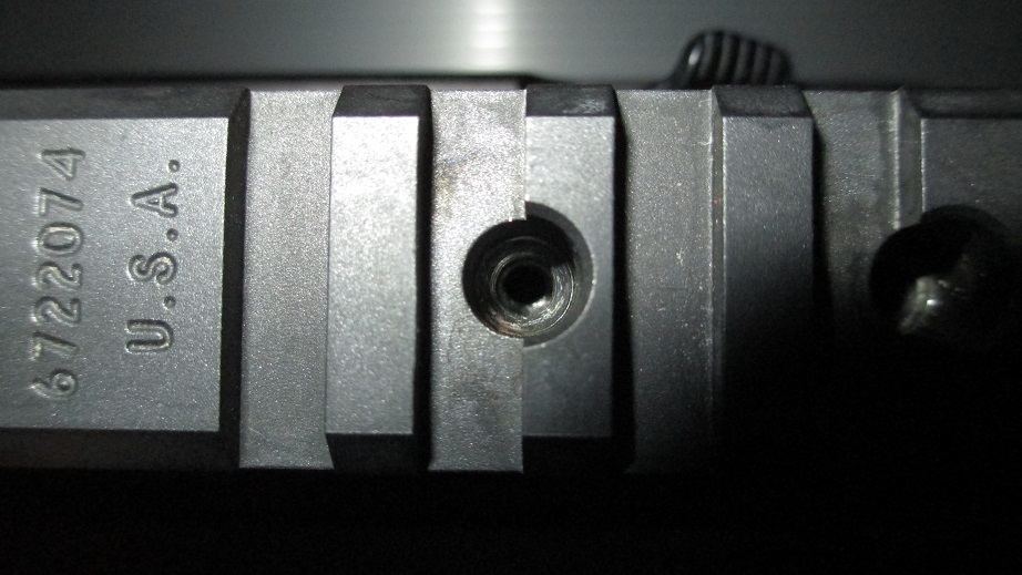

So I'm bedding my new Farrell G force scope base to my Savage 110FP using Devcon, and I've run into an issue. After the bedding cures I pop it loose and clean off the rifle and base of all the release agent (kiwi shoe polish) and play-doh. I go to mount the base and after it's torqued I look at the rear of the base and there's a gap on the right side. it's not a big gap it's just enough to slip a piece of paper underneath, it slides all the way to the mounting screws, but it's enough to bother me so I decide to redo the bedding. well this time I paid close attention to how much release agent I put on the receiver, 24 hours later and the same damn thing happens, just enough gap to slip a piece of paper under the right side. so before I redo it again expecting a different result (I know insanity) does anyone have suggestions as to why this is happening? I've bedded 2 bases before and didn't have any issues, I can post pictures if need be.
When you apply torque could that be bending something? Given any thought to lightly snugging down all four screws before you start to apply torque? Any chance that after you remove the shoe polish, the base is in a different place - shifted forward or to one side? Any chance you used too much shoe polish? Could the base have a twist in it? I use the commercial release compound from Brownells. After I do my bases, no base metal touches receiver metal - there is a thin but not zero coating of bedding compound between the base and the receiver.
Whole point to bedding a base is to do it tension free. I'd bet you aare snuggin up the "loose" end of the base too much. Sort out which side is higher. Front/rear? Then only snug up the tight side so that bedding actually gets to fill the voids on that bad end. This will solve the mating issue instead of being squished out.

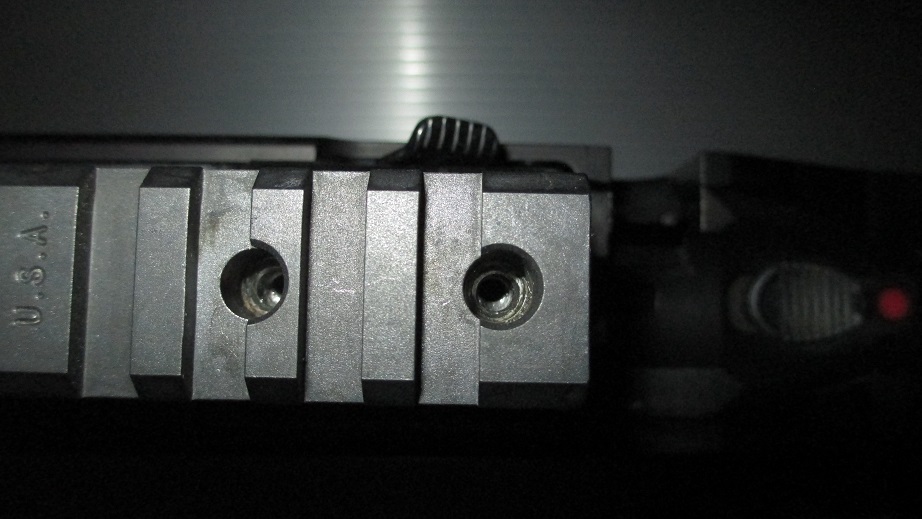

I did the rear of the base. I plugged the rear holes in the base and receiver and just snugged the front 2 base screws. I figured out the issue anyways, if I snug the front base screws and look through the rear base holes they are off to the left side of the receiver threads. I have to start them all at the same to get them to thread in and I guess it's pulling the rear of the base to the right. here are a couple pictures

Your base holes were drilled off center and arn't lined up. You will need to have them drilled and tapped to 8/40 and centered. A smith should do it for 75$ or so. Right now your scope will be pointing way off to one side and you probably wont have enough windage in your scope.
Yeah, the only problem is there are no smiths around here(that I know of) that do this type of work.
Out of all the actions that I've ever performed a scope base hole enlargement to, the 1903 SpgFld has been by far the most delicate/challenging to date.
Reason is they are hard as wood pecker lips. The steel is just hard/tough shit. No other way to describe it.
That said, the owner of this particular action said it best I think, "after watching this take place, I wanted to go home and throw rocks at my mill."
Right tools for the job make this stuff a whole lot simpler. We have those tools, so I'm confident we can tune your Savage up for you.

B/A arrived this morning. Problem solved. Base holes on the receiver were out a smidge, but the bigger issue was in the base. A little machine work, some blasting, and a quick dunk in the park tank has it all back together good as new.
Leaves in the am, thanks Steve.

Thanks Chad, I never would have guessed the dang base I paid so much for would have been an issue, but like you said on the phone Savage likes to change stuff and not let anyone know about it. I appreciate you getting it all straightened out for me and the lightning fast turnaround, you have earned a customer for life.
