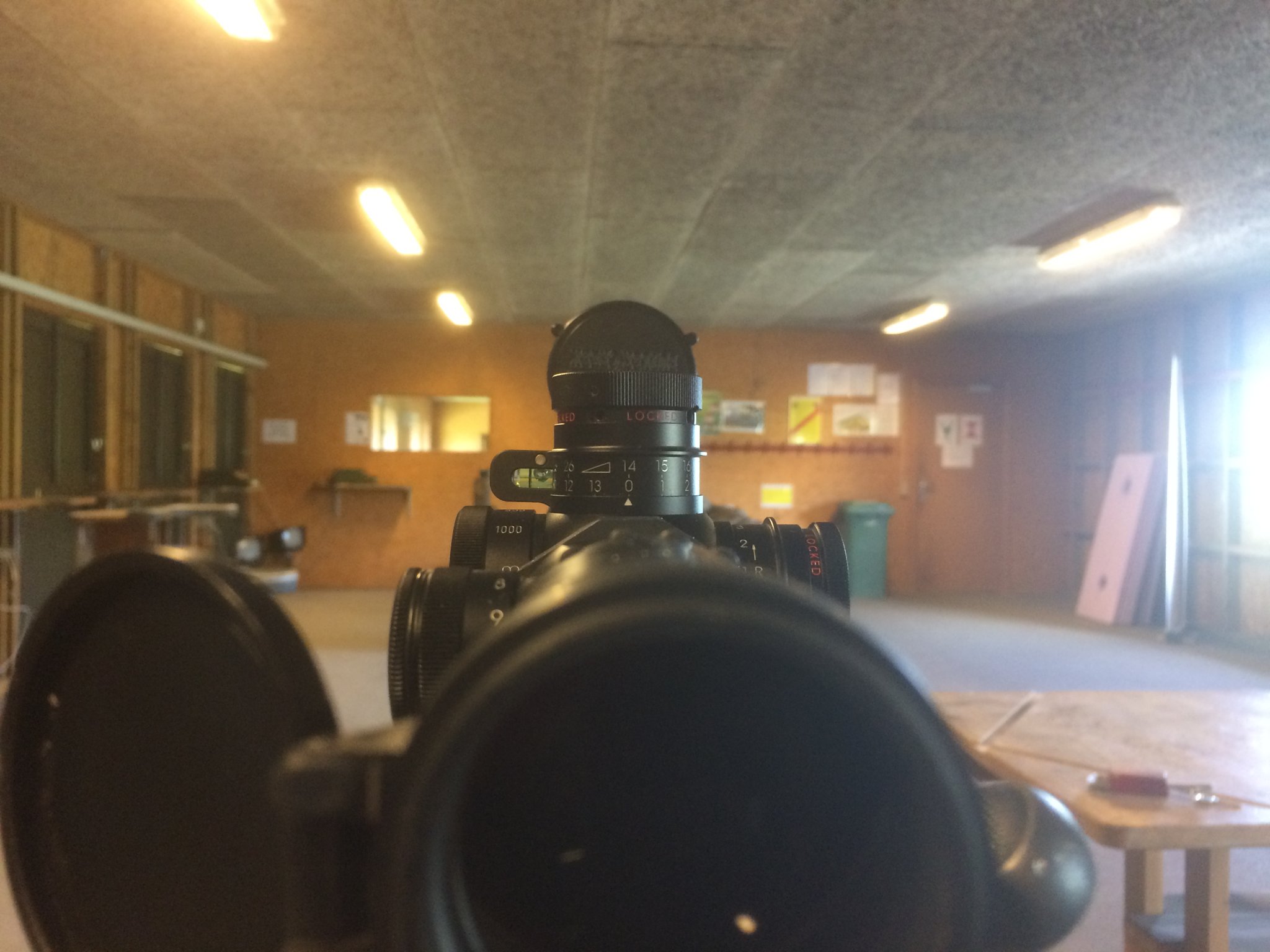

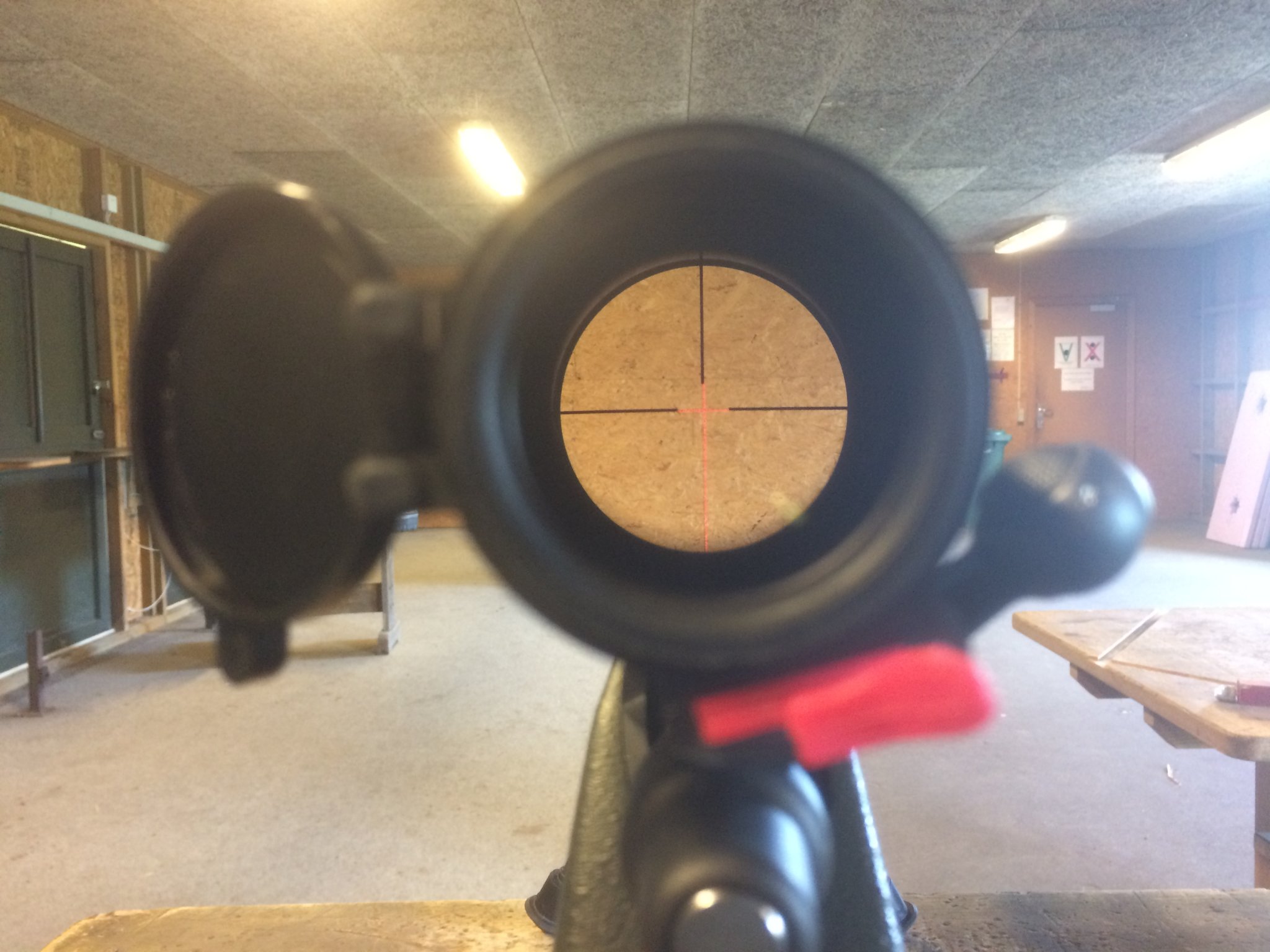

I (1) use Wheeler Engineering's leveling system to get the scope body level with the rifle, (2) then check the reticle with a plumb bob, and then (3) use a home made poster to do a turret tracking test. Maybe I've gotten lucky, because I've been beginning to wonder if the plumb test was just me being overly-cautious.

1. How are you guys leveling your scopes, plumb and a dead level? Or just using a level, I felt I had pretty good redundancy to get everything as perfect as I can. I've been doing this a while so I have a pretty good method, I think.
Step 1: Hang a plumb bob, level the reticle to plumb bob, attach bubble level to scope.
Step 2: Check for a canted reticle by running the turret up and down when indexed against plumb line. (scope held in fixture, rifle in sturdy tripod, whatever to hold it stationary. Alternate option is to shoot a tall target test). If the tracking of the reticle follows the plumb line you do NOT have a canted reticle.
IMO it doesn't matter what the outside of the turrets line up at. Only thing that matters is that 1 and 2 above match. If they do, then....
Step 3: Mount scope on rifle in a position that matches shooter NPA.
I’ve spent lots a time dicking around leveling scopes and finally broke down for a Shpur mount. I’m never going to mount with rings again. One piece mount with a bubble in the mount and a mechanical leveling device is so easy and reliable.
Unless your scope housing doesn't match up with your reticle... then the Spur and all the wedges and tools do you no good.
And if you want to match your scope alignment to your shooter NPA that also does you no good.

It matters where the turrets line up. The erector assembly moves the etched reticle up and down PROVIDED the assembly is plumb with gravity.
If you plumb the reticle with gravity and the elevation/windage assembly is canted, guess what, when you dial either you get both.
