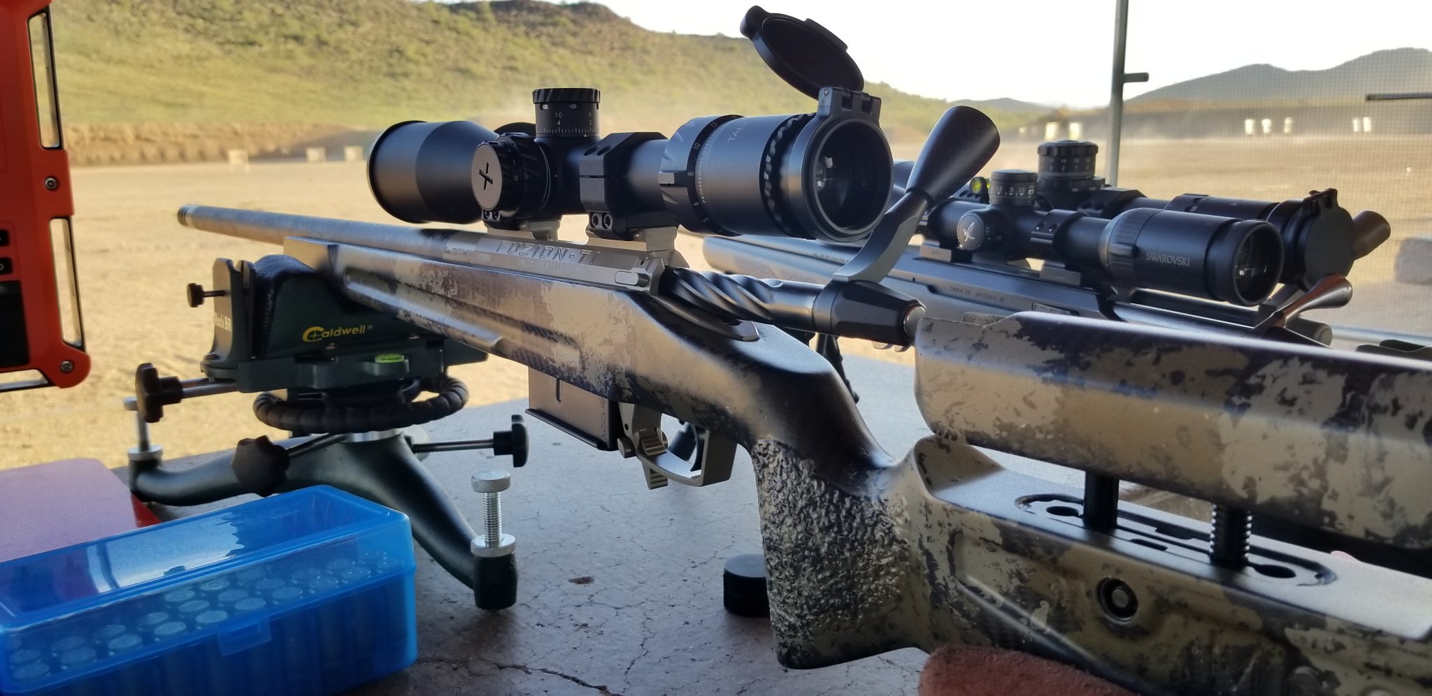

I put the MK5 3.6-18 on my FIX and for my needs it’s a perfect package. Balances really well, and complements the rifle really well. I’m not one to be distracted by CA but it’s there if I look for it on 18x

A buddy of mine put the SS 3-15x42 on this 6.5CM Fix and it has been absolutely rock solid so far (in the center of the picture below):
ILya
Thanks for the pics, that's awesome. I didn't even think about it before starting this thread but the TT scope sounds like a good call from what everyone's saying.
