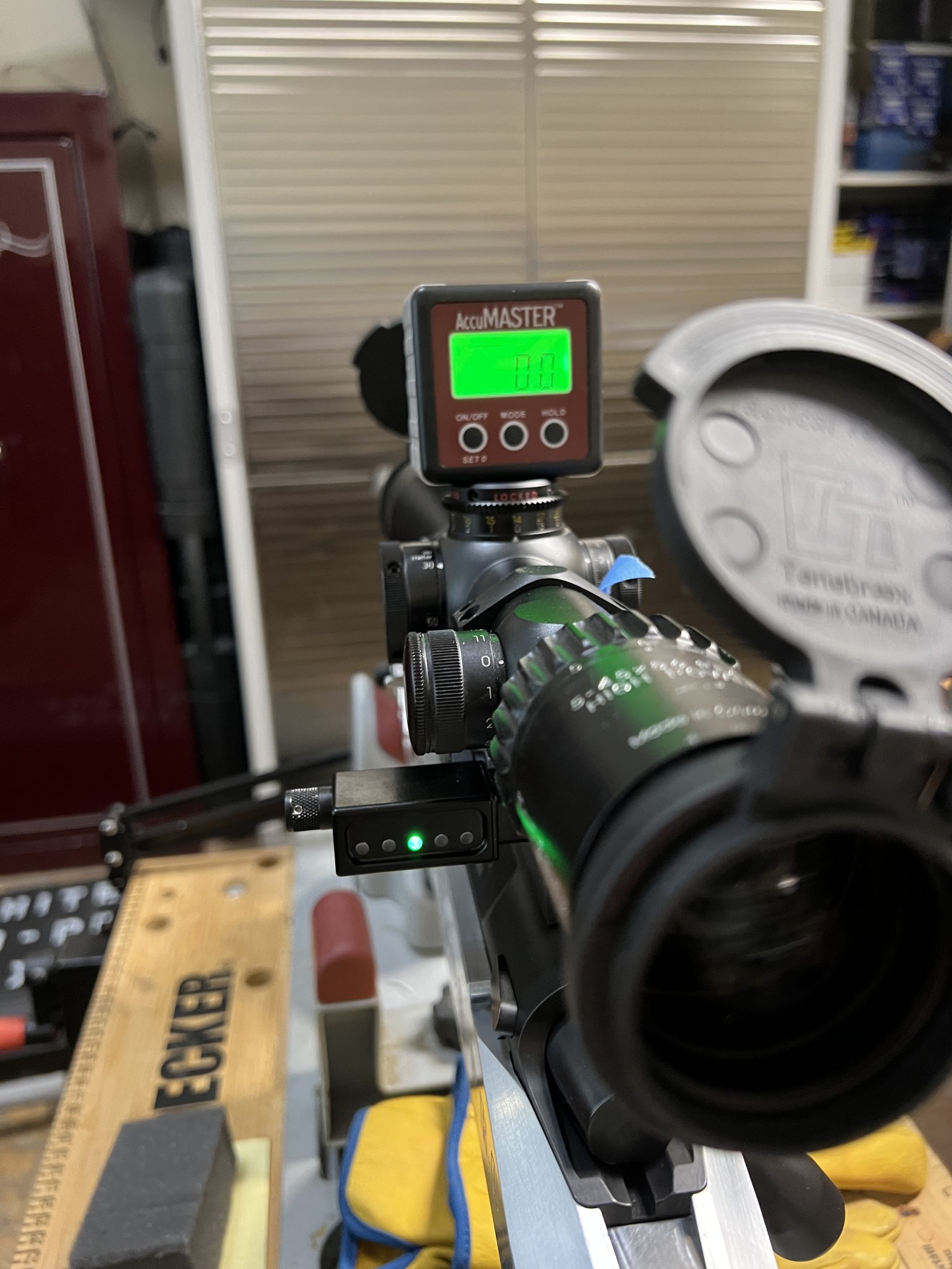

Buy a set of the Fix-It-Sticks levels. Mount one on your pic rail under your scope, and place the other one long-ways on your pic rail, and somewhat level your rifle side-to-side & front-to-back (doesn’t have to be perfect). Then remove the small level, mount your rings and scope, and put the other level on your turret. Make the 2 levels match each other, and not necessarily level to the ground. Torque to specs, remove levels, put them back in the bag until you need them again. 👍🏼

Use a combination of everything mentioned here.
Arisaka mini lever can be useless depending on the mount design when using unimounts. Mount can be too low or the area under the saddle isn’t flat enough (raised ridge feature down middle of mount used to be fairly popular).
Starrett mini levels are indeed garbage, I use a Stabila. The digital angle gauges can be a good alternative.
I use reflective orange guy-lining for my plumb bob line.
Badger Dead Level is in fact too light. Also check yours to make sure the base and rail are actually level to each other.
Reactions: Holliday
I like my scopes level, but keep it simple. I mount the rifle receiver in the bench vise with rubber/silicone jaws and adjust so the top of the receiver is level. Doesn't work with round receivers and old style mounts, but is easy for anything with a flat top or a rail.
Then just mount the scope and use the same bubble level (in the same orientation, for consistency) on the scope's top turret to mount it level. If I'm mounting a bubble level to the scope, that gets mounted at this time as well of course.
