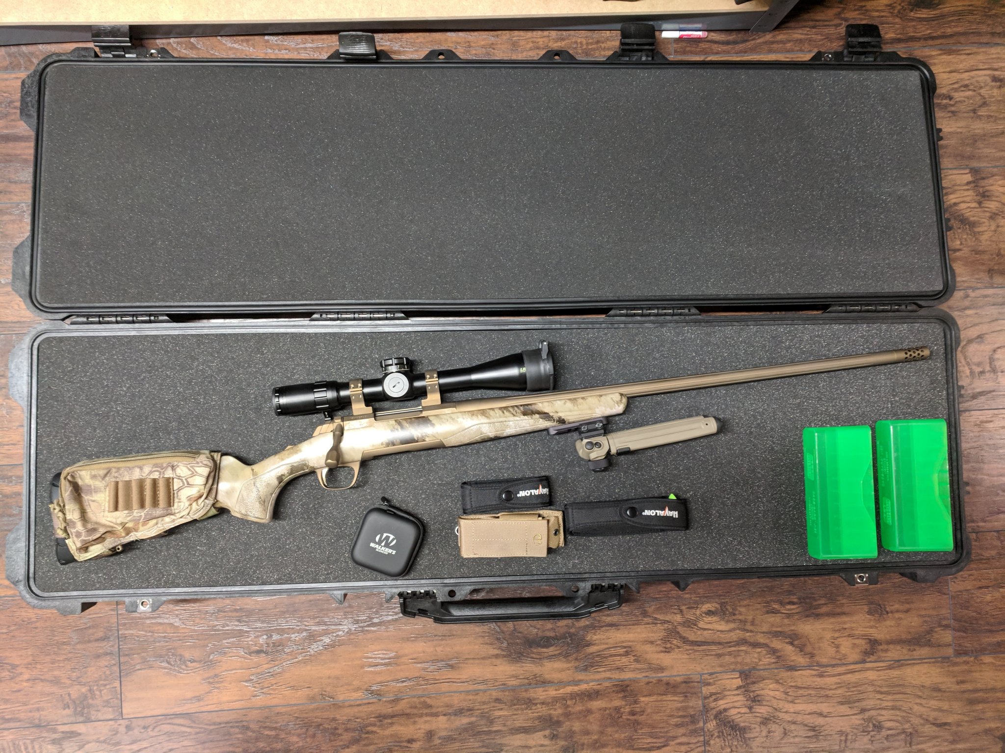

The rifle is a Browning X-Bolt Hells Canyon LR in 270WSM. I opted for Talley Lightweight Scope Mounts to eliminate having a rail and because they matched the Burnt Bronze Cerakote. I quickly mounted my LRTS for a hunt, but was not confident that the scope was mounted as well as it should be. I struggled to find an area on the action where I could place a level, so I used the bottom half of the rings as my reference. The problem was the rings were far from level. The front and rear were off by 3-4* L to R and placing the level inline with the bore, it just teetered to one side or the other. I used a plumb bob for the reticle, but had no verification that the action was truly level.
I think the issue is in one of two places, the mounting holes for the rings, or the rings themselves. What I don't want to do is buy a set of Hawkins Hybrids only to find out its the mounting holes, but if there is a way I can level the action otherwise, do the Talley's really need to be level?
Long winded I know, but I'm having trouble coming up with a plan to correct the issue. I appreciate your feedback.
