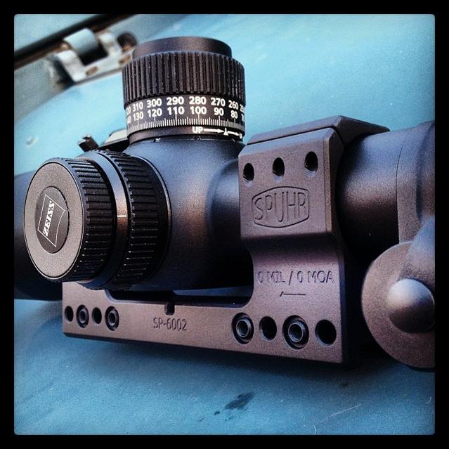

Here is finally one of the 3 models of 36mm mounts we make.
All 38mm/1,5" high. (The can't be made much lower as the battery housing builds down considerably)
Comes in 0 and 16mil/60moa. And in cantilever 0 mil.
Håkan
It looks just like the 34mm & 35mm mount with the exception of the integral level. Since the big Henny battery compartment would block the view of the level Spuhr left it out and charged $100.00 MORE for the mount. Seemed kinda backasswards to me. Leave a part out of the construction of a particular mount that is integral to the other mounts should drop the price of the 36mm mount, not increase it $100.00.
Surefire, I know the mount you talk of, but I have no idea either. I ultimately went with the Spuhr and it is great. The reason the mount is more expensive than the others is probably because they have to make a special run for the 36mm, as far as I know the Hennie is the only one with a 36mm tube. And smaller quantities usually make the price go up. It is a shame it does not have an integral level in a different position, but to be honest I wouldn't know where to put it either because of the battery compartment of the 3.5-26x56.
