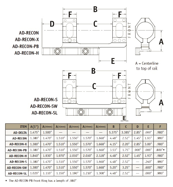

I recently picked up a Vortex Razor HD 4.5-27x56 but need help picking a mount. It will be going onto a KAC SR25. My question is: What 34mm mount will work correctly on a flat top rail allowing enough space for the objective lens size? I am also looking for QD and am a fan of Larue and ADM stuff.
Consider a BoBro QD 34mm 1 piece mount. I have 4 Nightforce 3-15x56 Zerostops and 2 5.5-25x56 ATACH-R Zerostops mounted on my AR 10 patforms! couldn't be happier!
My razor has an OD of 2.56 which means you need a minimum of 1.28 to clear the rail. ADM has good drawings on their site so you can see the height over centerline with their various options.
