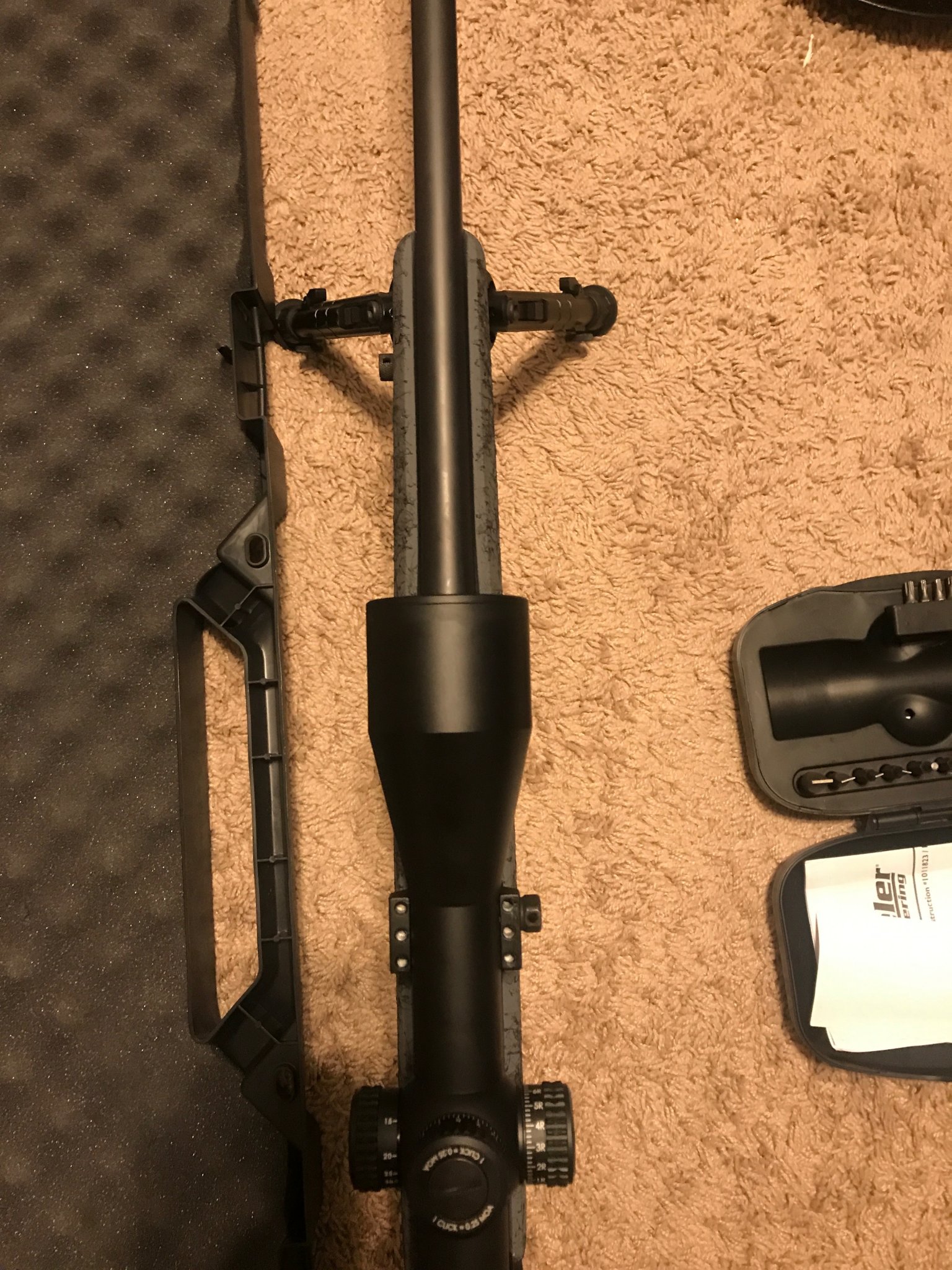

Any thoughts on whether this is a problem? Is it a problem which is more than a cosmetic one? I've had this rifle (A HOWA HS Precision in 308) for a couple of years and just noticed that my scope appears to be aimed fairly significantly off to the left compared to my barrel. Taking off the scope it looks like the holes for the scope base screws are a bit to the left of the center of the receiver. Should I just contact HOWA and ask for a replacement?
We can't tell shit from your photo. You would have to hold the camera plumb and aligned perfectly with the bore centerline, and I know you can't do that free hand.
Did you have any trouble zeroing? Are you running our of elevation or windage adjustment? If no to both, move on.
Yeah. It's not perfect but you can see that the bell of the scope is skewed towards the left when sitting behind the rifle. It is tough to capture in photos it but it's pretty obvious in person.
No, I haven't had trouble zeroing or run out of elevation/windage. That said, I am wondering if you get any drift between POA and POI at different ranges if your barrel and scope aren't aligned. I guess it would depend on whether or not the optical element in your scope which has the reticle on it is offset from the centerline of the barrel or not. If it were you are only going to be "zeroed" in the horizontal plane at your zero. Also, I'm not sure how much error this might cause.
I guess I could just get a laser boresight and see if there is actually horizontal deviation between the center of the barrel and the reticle at different ranges. If not, you're right, it's just cosmetic and doesn't matter.

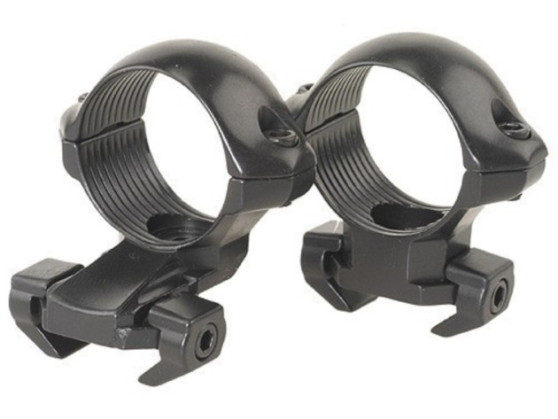

FWIW, it may be the rings causing the misalignment problem. I have a set of USA made Weaver rings that cause the exact same issues you seem to be having.
You can also use a level and straight edge to check screw hole alignment with the two bases mounted, or simply remove the bases and put the screws back in the holes and see if front and back screw heads line up when you look down the top of the reciever.
Good point. Another easy way to test would be rotating the rings 180 degrees. One would assume that should skew the scope in the other direction if the rings are the cause. I think I'll give that a shot.

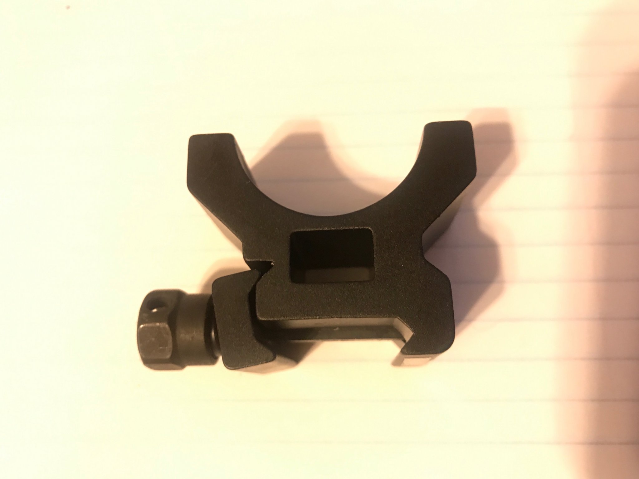

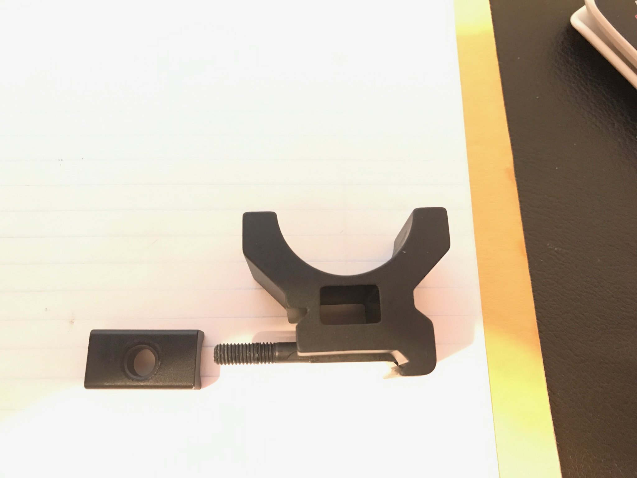

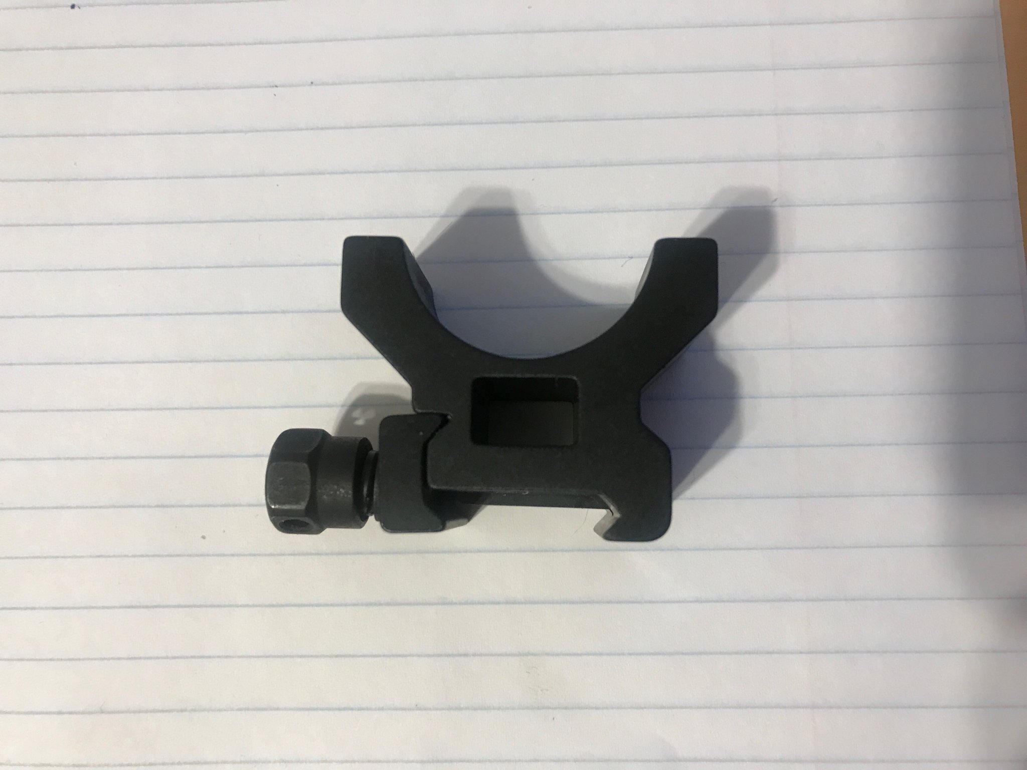

I figured it out! It turns out that for whatever reason (It's probably my own fault, if I'm being honest.), the claw mounts on both my scope rings were rotated 180 degrees (see below). I'm surprised it retained zero. Let that be a lesson to the kids out there...don't do stupid things.
I guess because the claw couldn't fully close the scope rings weren't quite centered above the scope base which was causing the offset I saw. Phew. I feel better now.
ROTATED 180 DEGREES
CORRECT ROTATION
SCOPE OVERHEAD SHOT
Glad you figured that out without spending a bunch of money
Same here. That's a bit embarrassing but in fairness to me those claws that hold the scope rings to the rail are symmetrical so it was very tough to tell there was anything wrong there. There is actually a very slightly off-center hole in the claw that the screw goes through which is why the orientation of the claw matters. In one orientation the claw can fully recess into the groove in the scope ring mount and fully close, in the other it can't. It will still hold your scope in place and retain zero though apparently.
Good to learn this. I assumed the claws were symmetrical or so obvious that I never considered there was a middle option.
Here is hoping some factory reps are reading this and are looking to make sure their rings either don't cause this, or mark their rings so it is clear there is a correct way to install them.

Yeah. That would have been helpful. I assume there's a reasonable explanation for the off-center hole. Likely to allow the manufacturer to standardize on parts or tooling. It is usually the case that design quirks like this are the result of cost saving measures not a design improvement that hadn't been considered.
Another possibility is that moving the notch down on the scope ring puts it too close to the corner of the square co-witness cutout, which is a stress accumulation point. Then they'd have no choice but to have the off-center hole.
Just looked at a few of my rings:
Badger rings: Different sized claws. If not installed correctly they would look noticeably off.
Leupold: QDW are noticeably offset, more so than the Mikehill's rings. But only way to get the claw to spin would be to remove the cross bar/screw. Plus if reversed the 'bottom' of the claw looks like it would not clear the base of the screw, and the 'top' not fit in the cutout for the claw.
No-name cheap .22 rings I bought when I was a broke college kid: Why am I even mentioning I own these? Other than they worked when I needed them to and they are still snug on the Sears Model 1 .22 all these decades later. But without removing them the hole in the claw looks to be centered.
