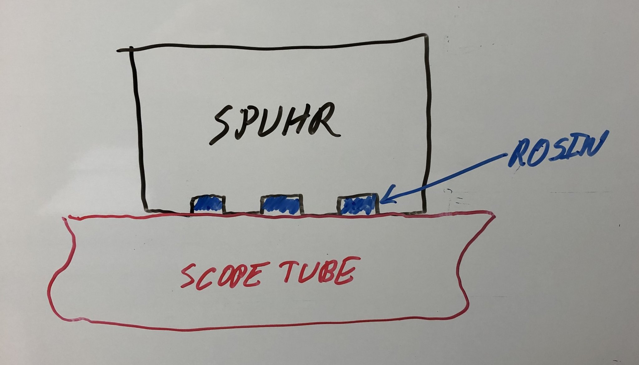

My Spuhr 5616 recommended rosin and 25 lb-in torque. I apply the rosin to fill in the gaps and leave a light dusting on the flats. You wouldn't want a build up on the flats since rosin is a compressible material. The rosin in the gaps will, in theory, spread the clamping force more evenly and not just to the flats. The only thing that you brought up that I wonder about is if there is too much rosin on the flats or if the rosin in the grooves was higher than the flats.
Edit: I have 1,500+ rounds through my SR-25 setup. No slips, no Loctite, no loosening of screws.
