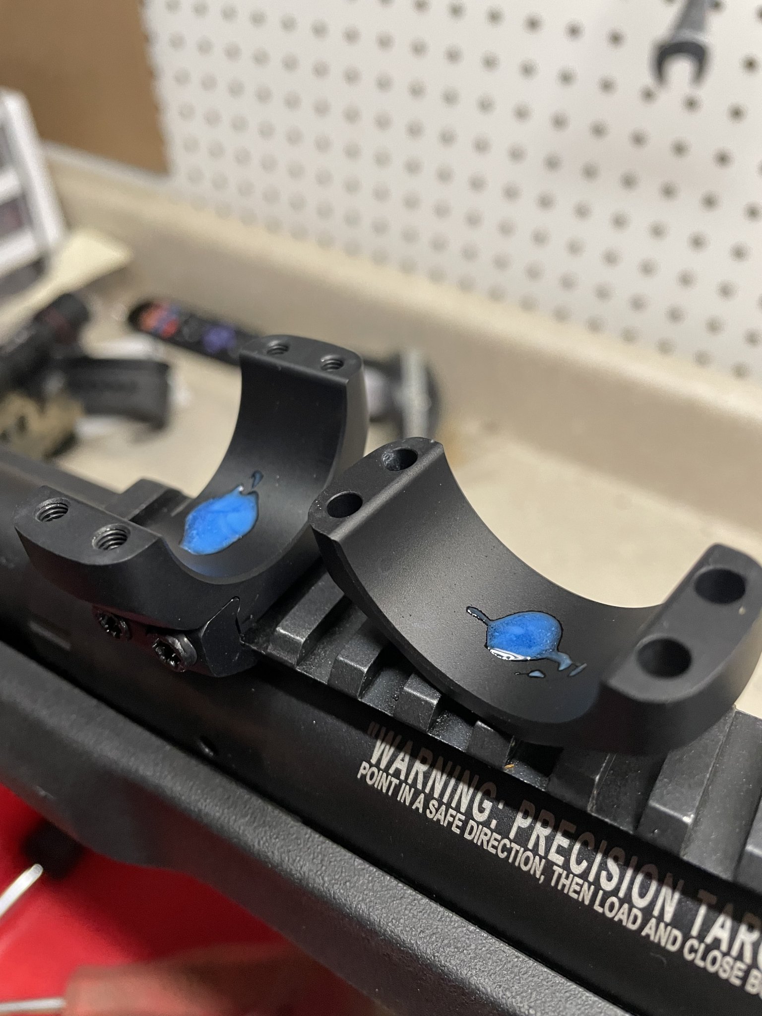

Blue loctite, degrease scope tube and rings. I started doing this with my heavy magnums, now I just do it to all my scopes. Comes off with a little effort and rubbing alcohol.
Good overall plan but there's a couple dozen Loctite products. Pretty sure the best is 620, retaining compound. For holding things like bearings in holes about the size of bearings so... same thing.
I have used this (since I have it... there may be another that's better) a couple times on such. Seems to work.
