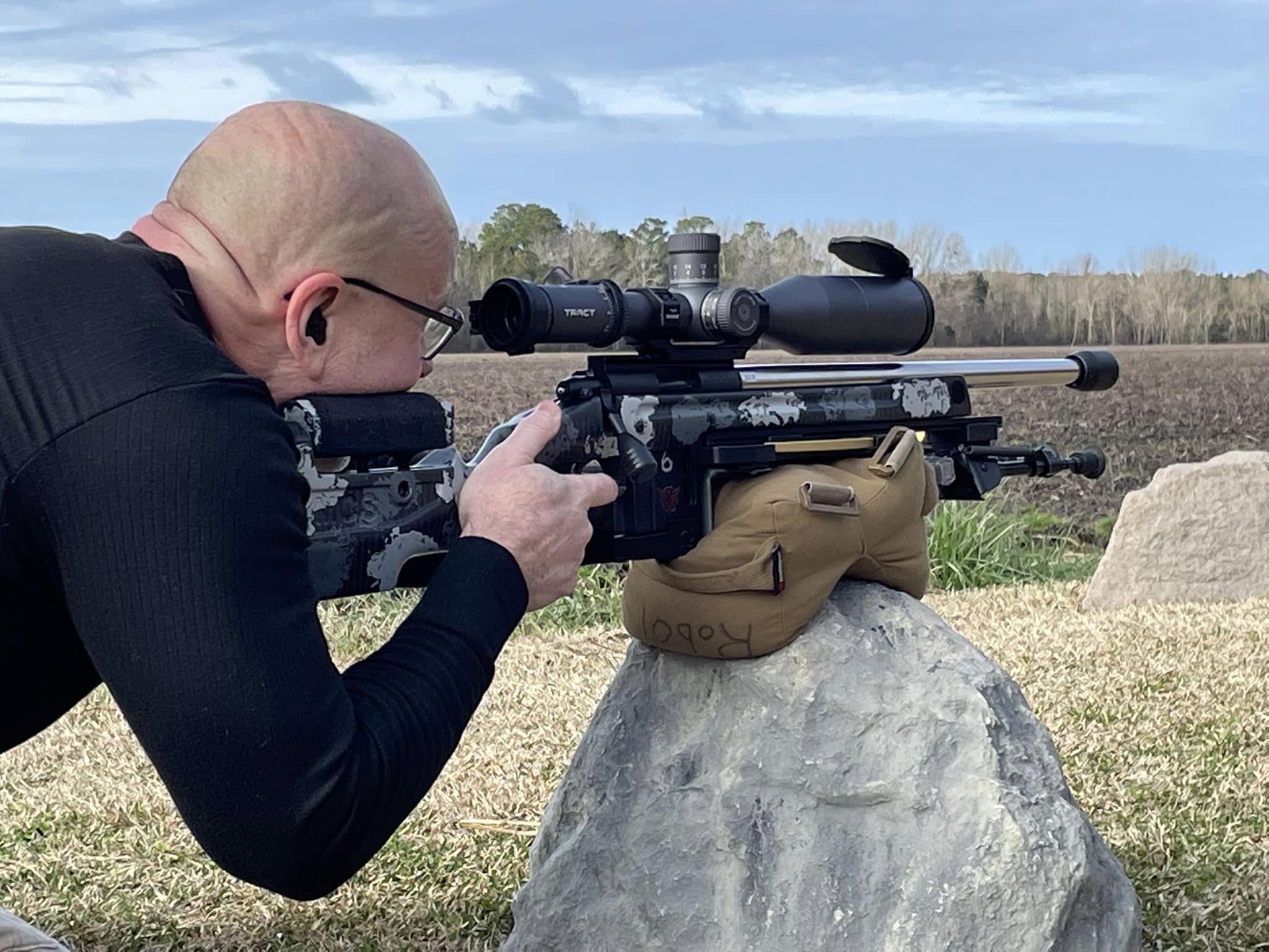

The Tract ELR are mode scopes in that price range. I had a 4.5-30 and have a 4-25 now. If you or anyone in the family is LE/Mil/Vet you can get better pricing direct from Tract.

In went with the TRACT 4.5-30x56 (MRAD)
You will like it. The knobs unlocking take a little to get used to but it has really good glass and an excellent reticle. I had mine on my Vudoo and it worked great. I put it in a Warne mount but any good set of 34mm rings or mount will work.
