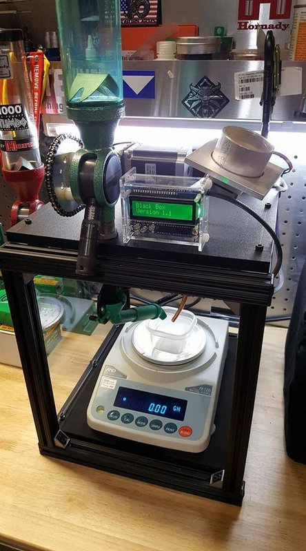

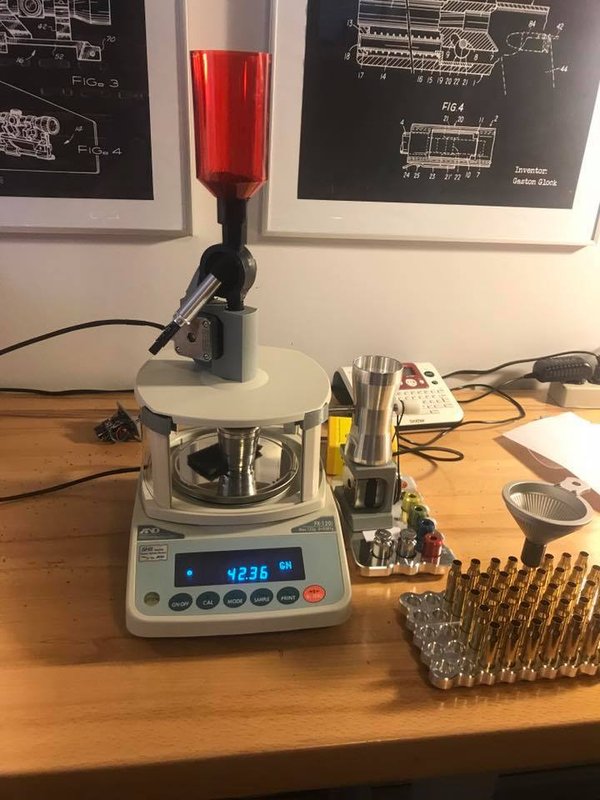

Lol, I'm taking the path of least resistance, whether 2-3 chargemasters, or one of these newer systems utilizing lab grade scales, no bending over or sitting so I can see the needle on a level plane.
I had one of the first auto tricklers to come off the line, even upgraded to newer model, feeding the scale was a giant pain in the ass, sold it, now we have the refined edition, still not my cup of tea.
Someone else looks like they are onto something good with the 2nd pic, no clue if or when it will be produced.
and i thought there was a lot going on with my set up LOL!!
That's getting pretty high tech! Almost makes want one, lol.
