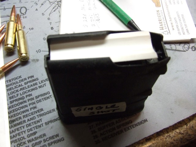

I found a little trick that you can use for single loads and your pmag 10 magazines.
What's the bobsled ?
I just meant single loading with the stock pmags is a pain, unless there is some trick I'm unaware of ?

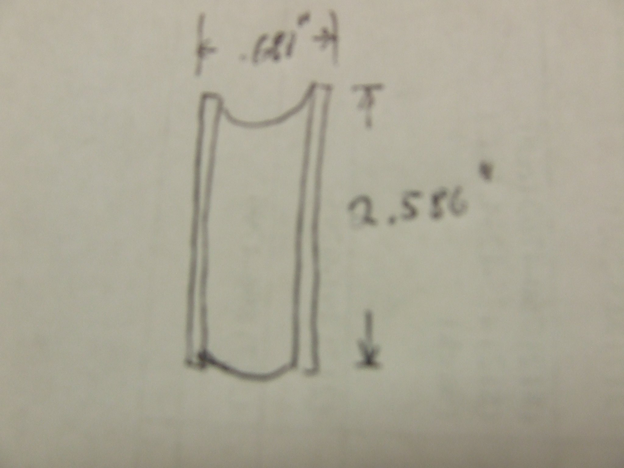

Here is what I do. It centers the round perfectly and it slips right into your existing Pmag 10 round magazine. When your done, pull it out and go back to loading your mag. Took me all of 20 minutes to make. 3/4" PVC pipe
Reactions: Pilotscrappy
Here is what I did. It centers the round perfectly and when done slip it out of your pmag. Took all of 20 minutes to make. Hard to read the dimensions. It's .681" in diameter and 2.586" long.
