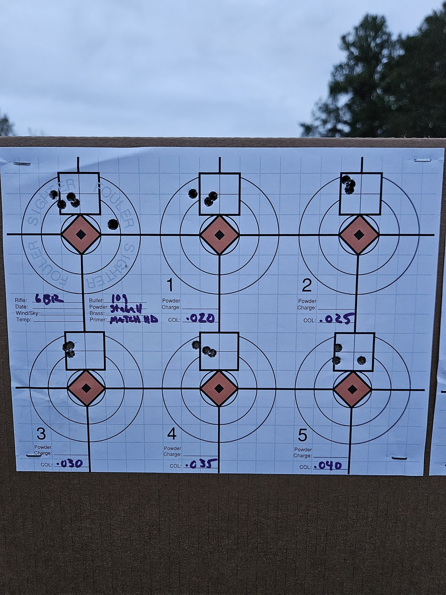

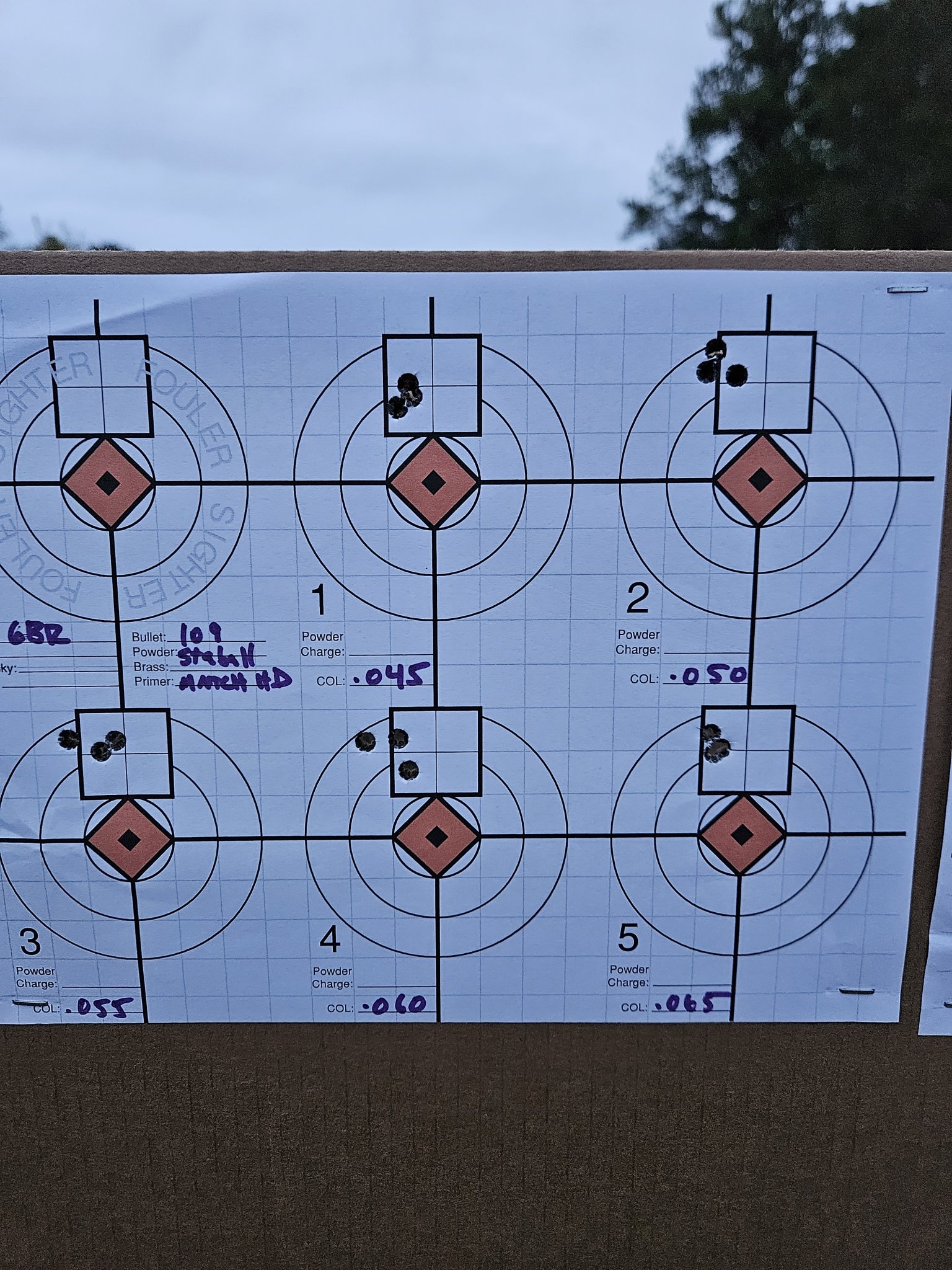

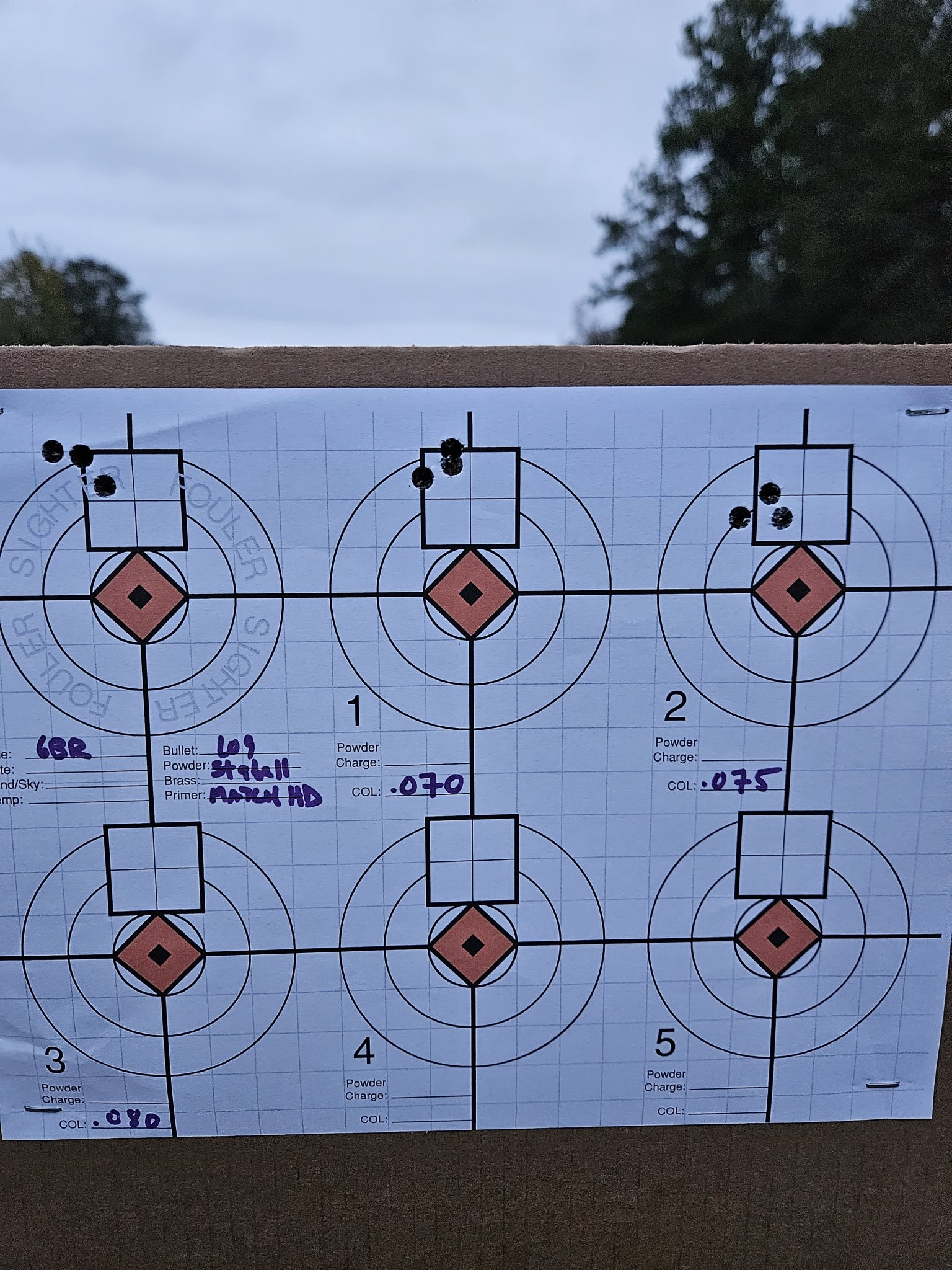

I am trying a new powder for my 6BR. It has always shot great at 2810 fps with Vargrt and 109s jumping 0.020". I was able to get the same speed and am now trying to find the right seating depth. My shooting buddy and I disagree.
I think 0.025" and he thinks 0.050". Opinions?
I say .025”. Less vertical as the throat grows .010”
Both look good honestly but closer to the lands leaves more room for throat erosion later

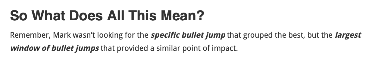

Mark Gordon has a great article on this. All this old man BS about jamming into the lands or right off the lands is just that. They proved the more jump the better the gun shot.

The conclusion to Mark’s test wasn’t that the gun shot better with a farther jump. It wasn’t that the tune on the bleeding edge, and was less susceptible to going out of tune. It showed to be less sensitive to throat migration is all. They did measure smaller groups with smaller jumps.
That's definitely *not* what they proved. They showed that the rifle shot acceptable for PRS longer with the jumps. Not that the seating depths were better groups in general.
Jamming and/or being very close to lands still produces better results (F class and BR) group wise, but *may* need more attention.
Larger jumps perform acceptable for PRS and retain that acceptability through more throat erosion. Which is what you want when shooting 200+ rounds in a weekend.
This would indicate picking .050". POI is similar to 0.065".

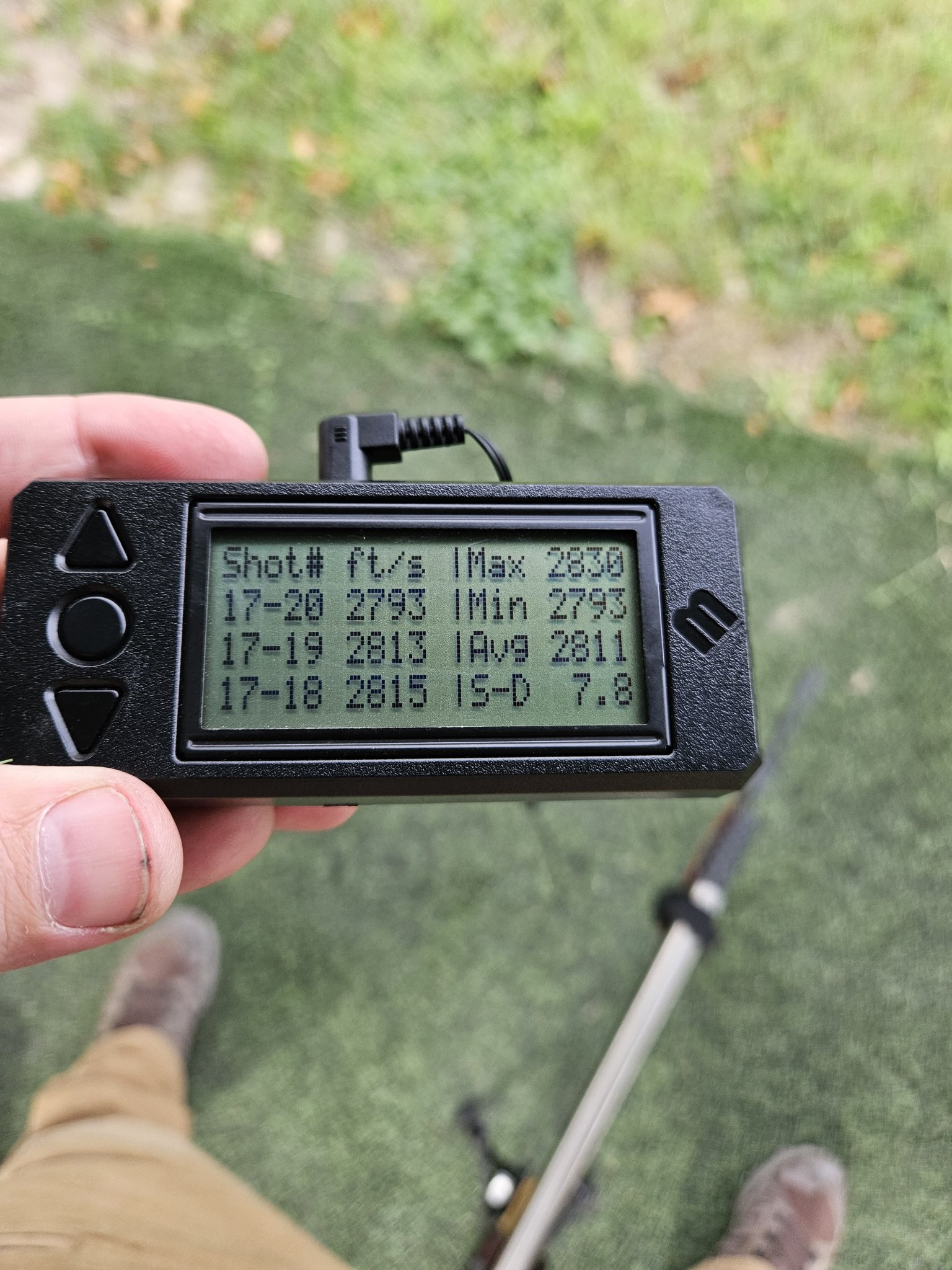

Should be noted that I'm likely not going to have the 'best' groups because Im trying to not use Varget for speed purposes. Im trying to load on my 750 exclusively using the powder drop and ball powder.
Not a huge sample but think its possible.

Your POI on .025, .030, .035 is very close.
Also, if that's 20shots with 7.8sd, then yea, you're fine on that front. You should have an SD of 11 (at max) with that sample if things continue.
