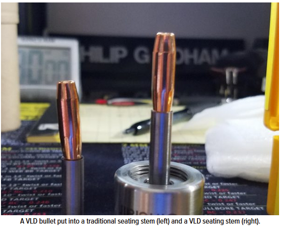

All you need to do is pull the stem from your die and check the fit.
More than likely my money is on the tip bottoming out in the stem.

Im using the Redding micrometer seater the VLD stem fits the 135 A tip really well. Very low runnout. Almost none, maybe 0.0005. The standard stem that comes with the die didnt fit them well. So no, get the VLD stem and youll be good.
Sorry if this is a stupid question but how do you determine whether they fit well or not. I also have the Redding competition dies and haven’t noticed any problems with the 147 eld-m
Initial test for me is nothing scientific. Take the stem out of the die, put a bullet into it, see how much movement there is side to side. Rinse and repeat with a couple different makes/models of bullets and youll feel a difference. Also can check a circular mark on the top part of the bullet after loading. Relative to neck tension but usually means the stem is contacting the ogive mostly or competely with the outer rim of the stem, not the bearing surface. Measuring with a concentricity gauge after loading would give you a more quantitative answer. How much all that matters is still up for debate.
I'm running the Redding with the VLD stem. I have no issues with the 135 A-tip. I did chuck up on bullet in the drill and used a little polish compound to clean the edge. I was seeing a slight ring on them but not on the 140 ELDM. That took care of the ring issue. It seemed to have a slight sharp edge. I have virtually no runout either.

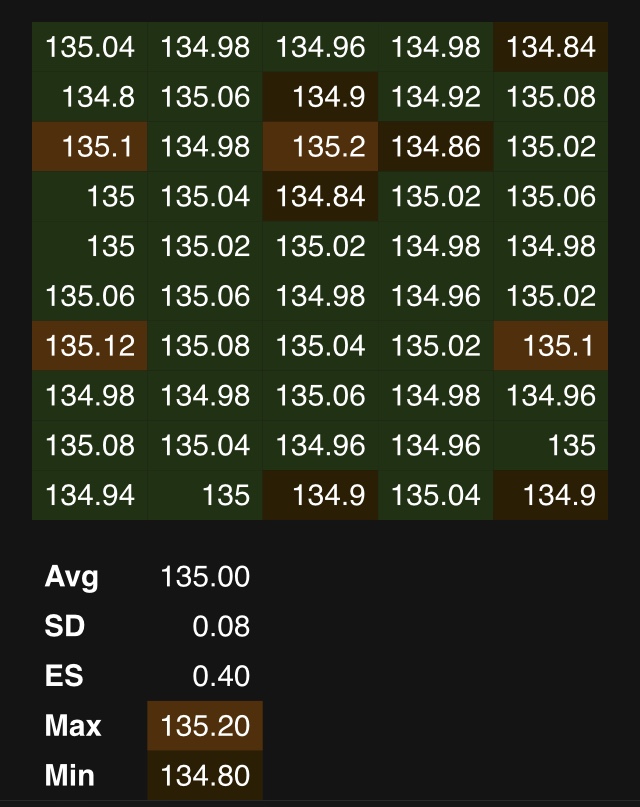

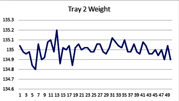

Might be of interest:
Tray 1, measured as it was packed:

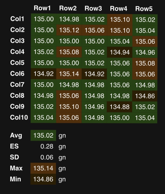

Tray 2:
Tray 2, assuming bullets are packed in rows of 5, left to right, total of 10 rows per tray.
Weight is pretty consistent. Combined data set (100 bullets) have ES of 0.40 gn and SD of 0.07 gn. Good SD but less than ideal ES makes it worth sorting them, i think.

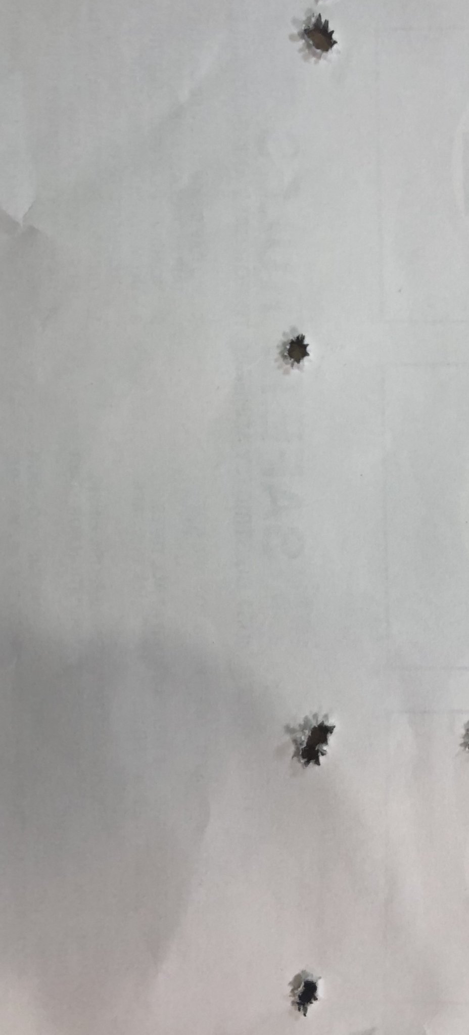

Rushed to the range after work, and could only shoot 4 “groups” with the 135 Atips (weight sorted) before the range closed. Results were frankly astonishing. Just doing a rough ladder/pressure test in increments of 0.3 gn of RL-16 at book COAL to see where the ES is low and the MV curve is flat, using two rounds per powder charge. The “group” size measurement was a bonus and these results may not repeat in future:
One “group” was 0.4” (not shown) with an ES of 56 fps.... me thinks me did not trickle it up. User error, as the tech support guy would say.
I realize that two shot groups are meaningless, so will repeat for a narrow range where the speed curve goes flat. Hope to find a nice wide node slightly over 2800 fps. Not chasing high speed.
Will complete tomorrow, MV is still slow, and of course zero pressure signs so far.
What speed are you guys getting?
BTW : The back of the target shows the two shot ovals better:
Interesting to see the orientation of the oval change with powder charge. Sometimes you see a trend there during load development. [Btw: Tuner was not adjusted yet. Might not be needed this time. Same setting as i got with 144 Bergers.]

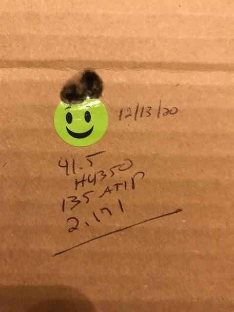

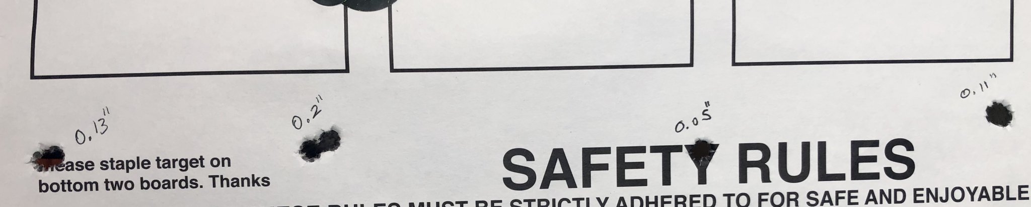

I managed to develop two 135 Atip loads that worked well: One with a small jump with a COAL of 2.950” that is strictly single feed, so way longer than the AW mag i use.
The second load is almost as accurate with a very long jump, and a COAL of 2.810 which fits in my magazine. [Don’t have my notebook close by, so can’t check exact numbers.]
Don’t be scared of jumping these bullets, they still shoot well with massive jump.
I know people hate weight sorting bullets, same for me. So just saying: Best group size for me prior to weight sorting was around 0.35”. Post weight sorting it was at about 0.1” to 0.15. At least on that particular day. [Maybe i had a less than perfect batch of bullets that benefited from sorting. Maybe your batch is better.]
And i have to add: I have no guarantees that my 0.15” groups will repeat. Have not been able to get more of these bullets because of the shortage. Might have been a fluke, but i hope not!]
