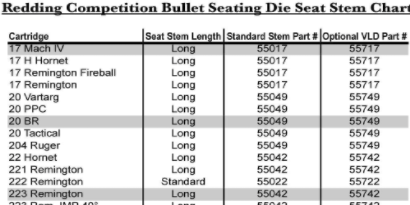

Do I need the long or the standard VLD seating stem? thanks!
A redding 223 comp seater would need the long stem
http://www.redding-reloading.com/images/charts2016/Redding_Competition-03-2018.pdf
