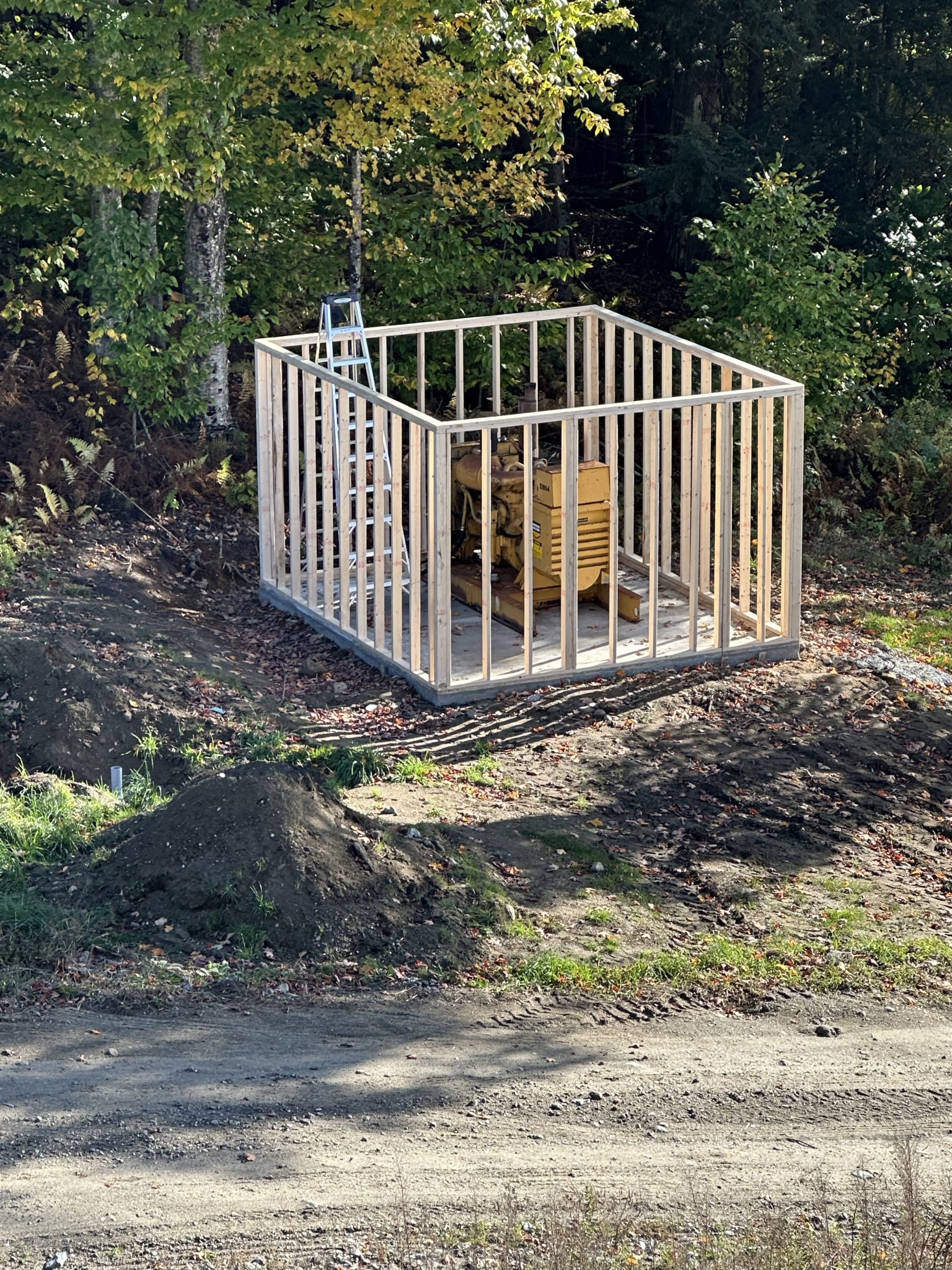

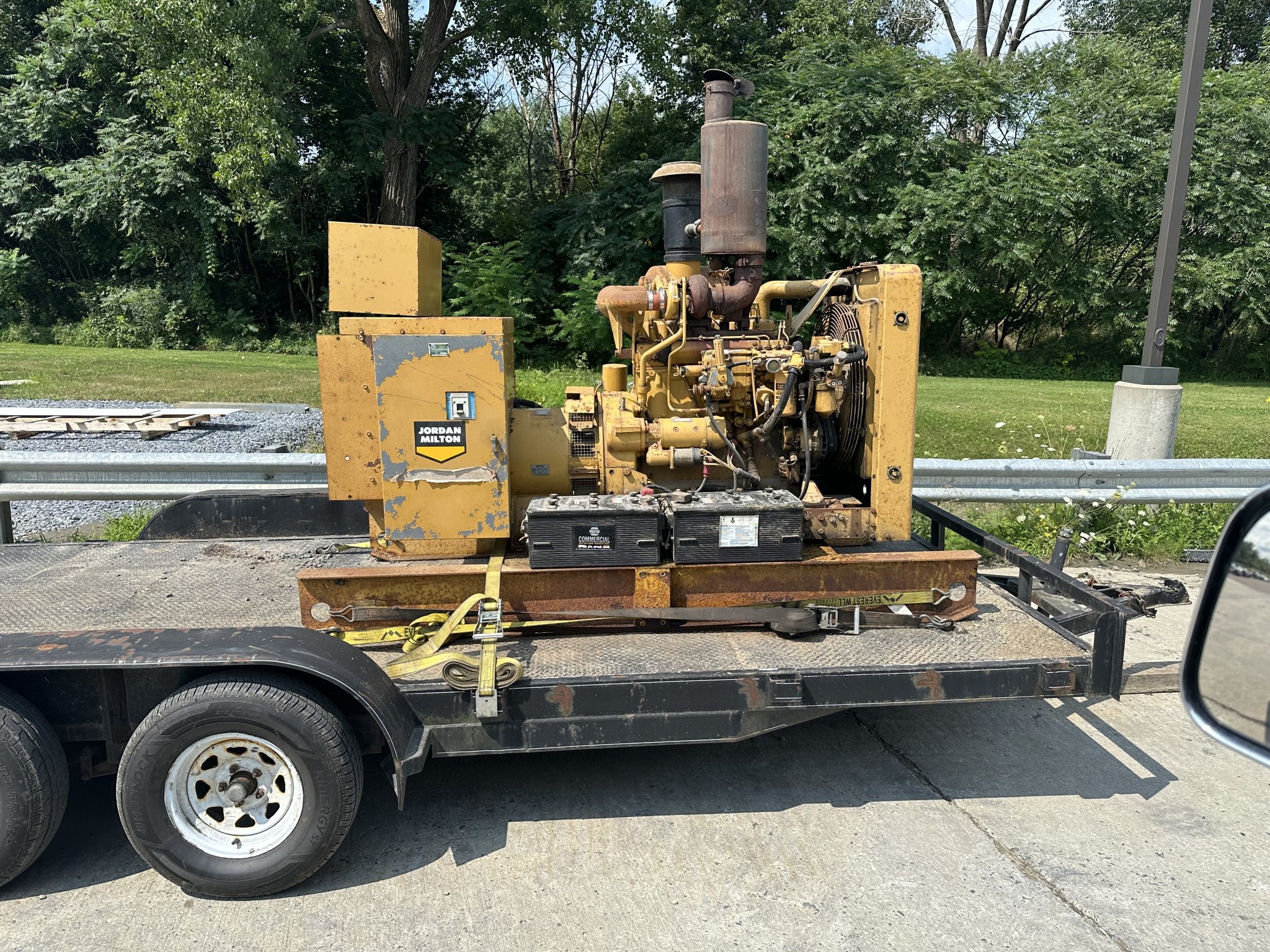

Go big or go home… pouring the foundation for this genset on Monday. Full size CAT turbo diesel with 240v single phase wiring.
It will power the Schloss and all the workshops with no issues!!!
I looked into the Kohler and similar and those are ok for single home use. But to do an entire farm, machine shop, outbuildings… when I already have diesel stores on site…. No brainer.
Also it predates computers. Is all analog. Going with manual transfer switch. It’s going to work when I want it to.

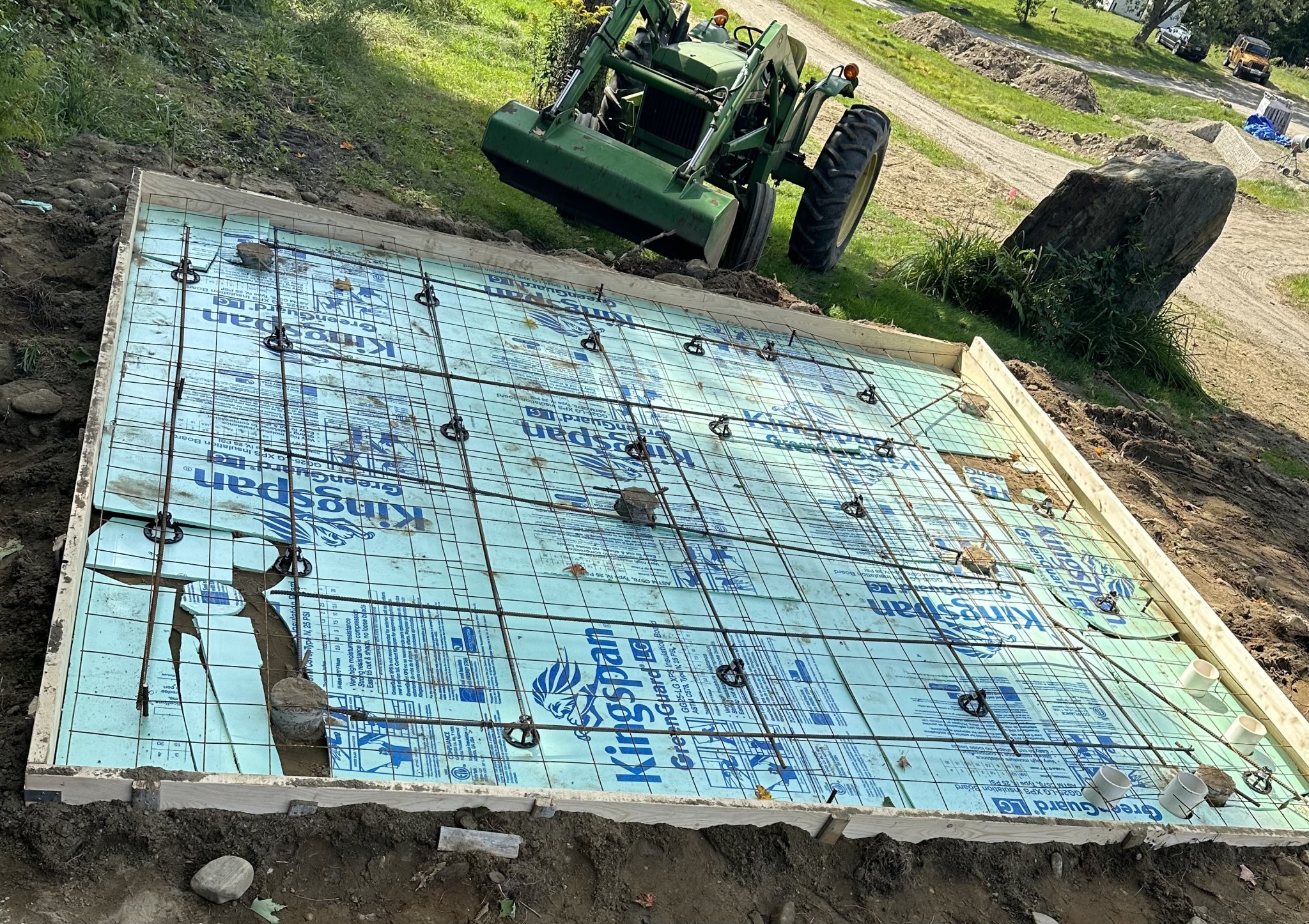

Why are you using house wrap for the 'crete ?
You know that will cause the 'crete to hold in moisture and you'll have mold/mildew issues, right ?
I'd suggest 2-3 inches of either gravel or sand under the 'crete and nothing else sceptin the fore mentioned rebar/mesh.
You'll probably want it thicker then the 3 inches max it looks like you're formed up for, I would go minimum 4 inches and pref 5-6 if you're going to have a genset mounted with redheads vibrating for however many years.

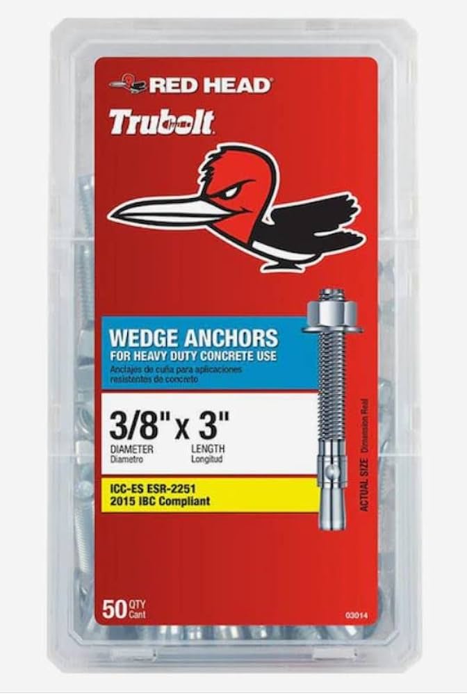

Make sure to have some heavy ass duty rubber or urethane pads under the genset, they make em just for that.

Tell us more about these "vibrating redheads"...:unsure:

That’s not house wrap it is insulating foam. And the slab is formed up for 6” with sloping edges for more than 7” at the form….
I might not be getting points for style…. But I’ve managed ti muddle my way through a few
Projects over the years.
Thanks for the input though.

The install continues… Home Depot idiots screwed up the shed kit so bad I just banged out my own stick-built framing on Saturday and erected the walls Sunday morning. %*€¥ Home Depot.
I’ll do roof trusses and get them up this weekend maybe even roof and some wall sheathing.
Trying to get it all connected before winter! If not… in the spring!
PS. Other than help carrying the walls from my garage to the slab… this was working alone… and started wtlh trip to lumber yard at 0700 Saturday. After telling Home Depot cancel my order and refund my (damaged) shed kit Friday at 4. Old guys get stuff done!!!
What are your plans for the cooling intake and exhaust air?
You will want the radiator exhaust air to be ducted so that 100% of the air that passes through the radiator gets pushed out, while it sucks in clean fresh air
No doors? Windows? Ventilation?
