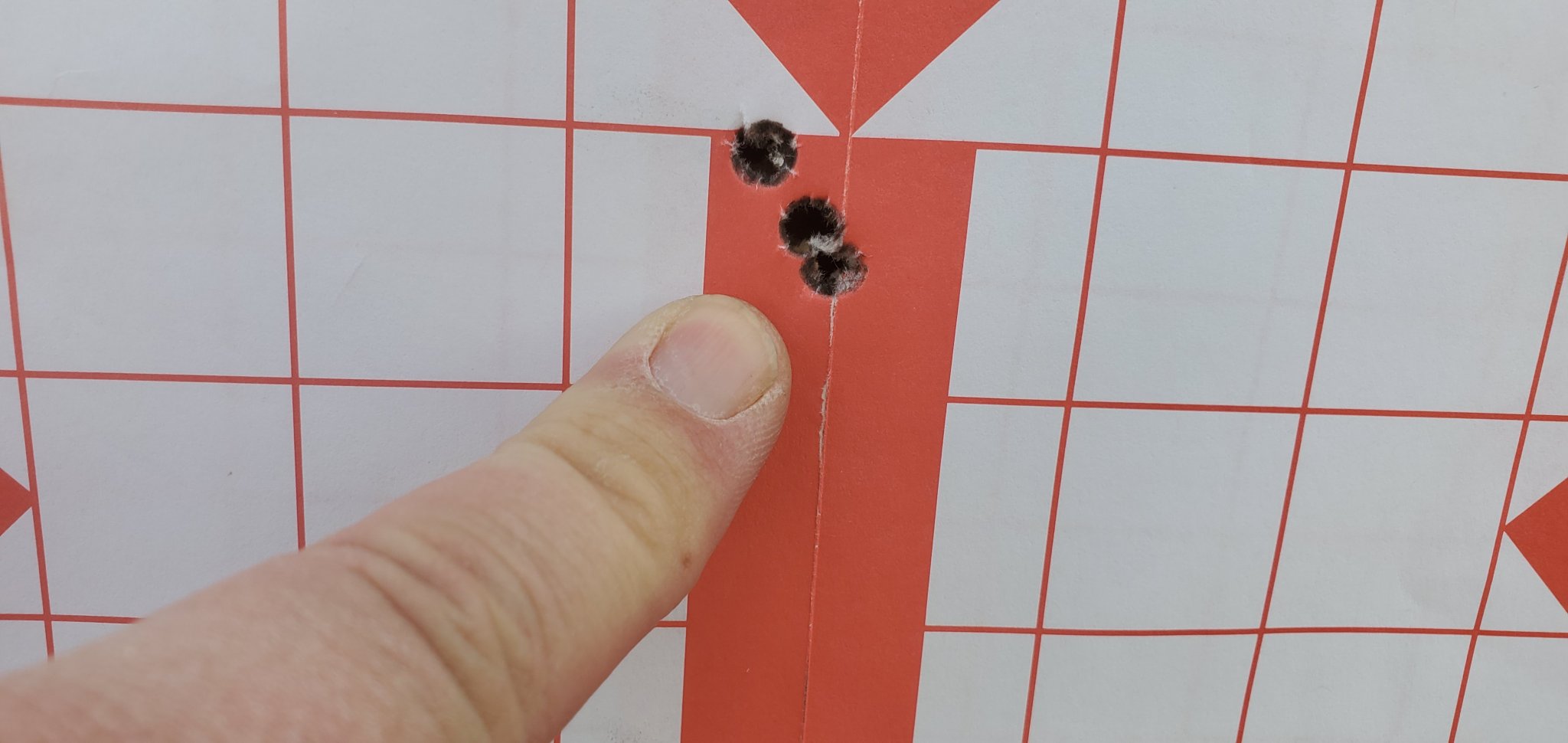

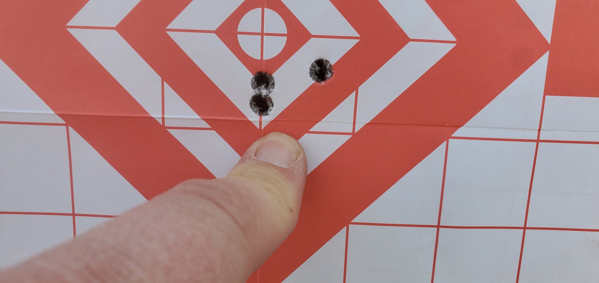

Hopefully it repeats. On my 300WM I finally found a load that shot .36 moa on a ladder test. Loaded up 20 and it would consistently have a flier(s) 1”-1.25” up and left. It may be about to go back to Seekins for the 2nd time.
Swapped scopes and bought some FGMM to test a final time before going back again.

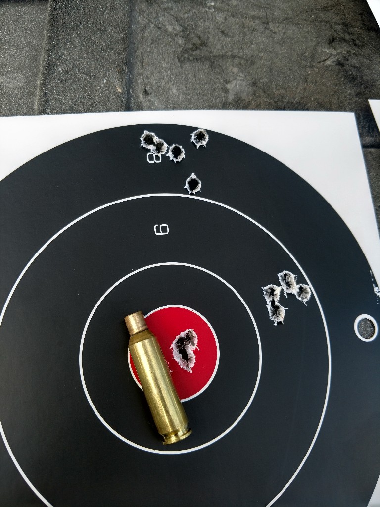

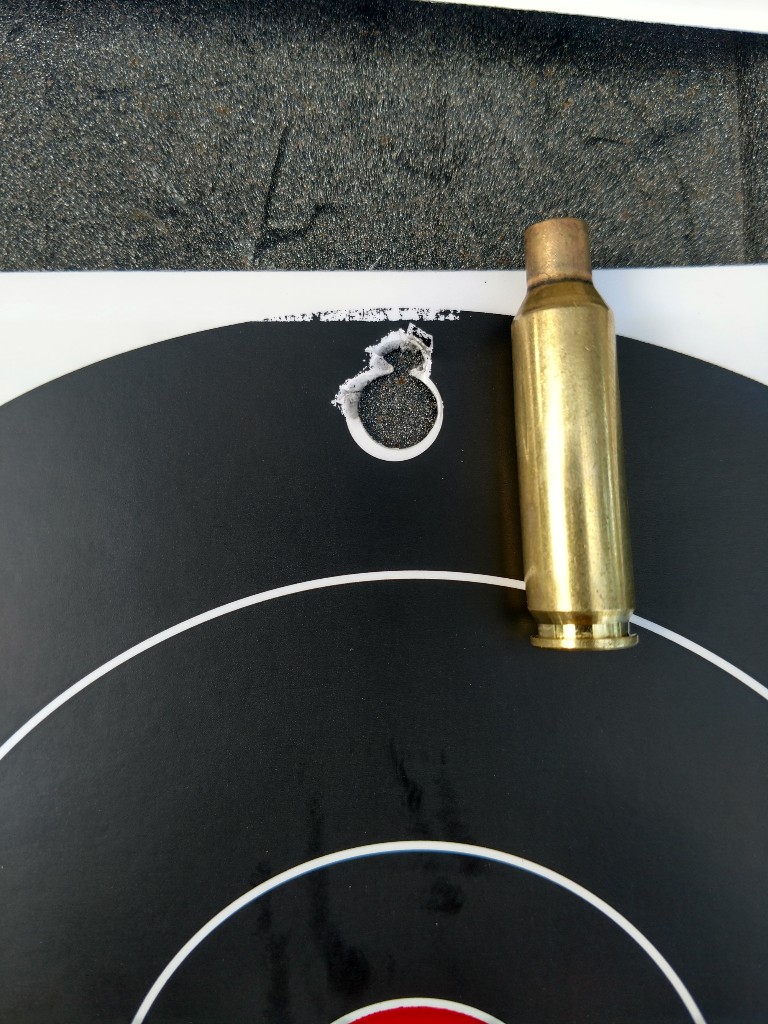

Looks like my PH1 is going back for the second time.
Results with 190g FGMM:

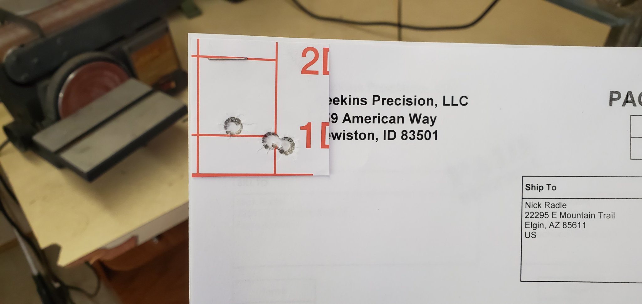

I sent mine back for extremely poor accuracy(1.5MOA). They said there was an issue with the barrel so they re-barreled it. They sent a sample of the groups it shot. It was sub-moa but not what I would call impressive. When I inquired about how they test rifles they did say that it's just outside, on bags, fired by a human. So the group really didn't mean anything.
I took it out with Hornady 143ELDx match ammo and was still not shooting much better than MOA, if better at all.
Then I took it out again with 147ELDm match ammo and got better results. three 3-round groups all under MOA, one close to half. And this was done on a sunny afternoon with the sun in my face, wind, and a big mexican lunch and a few beers in me. I'm going to try to get out again in better conditions, but I am satisfied with the results.

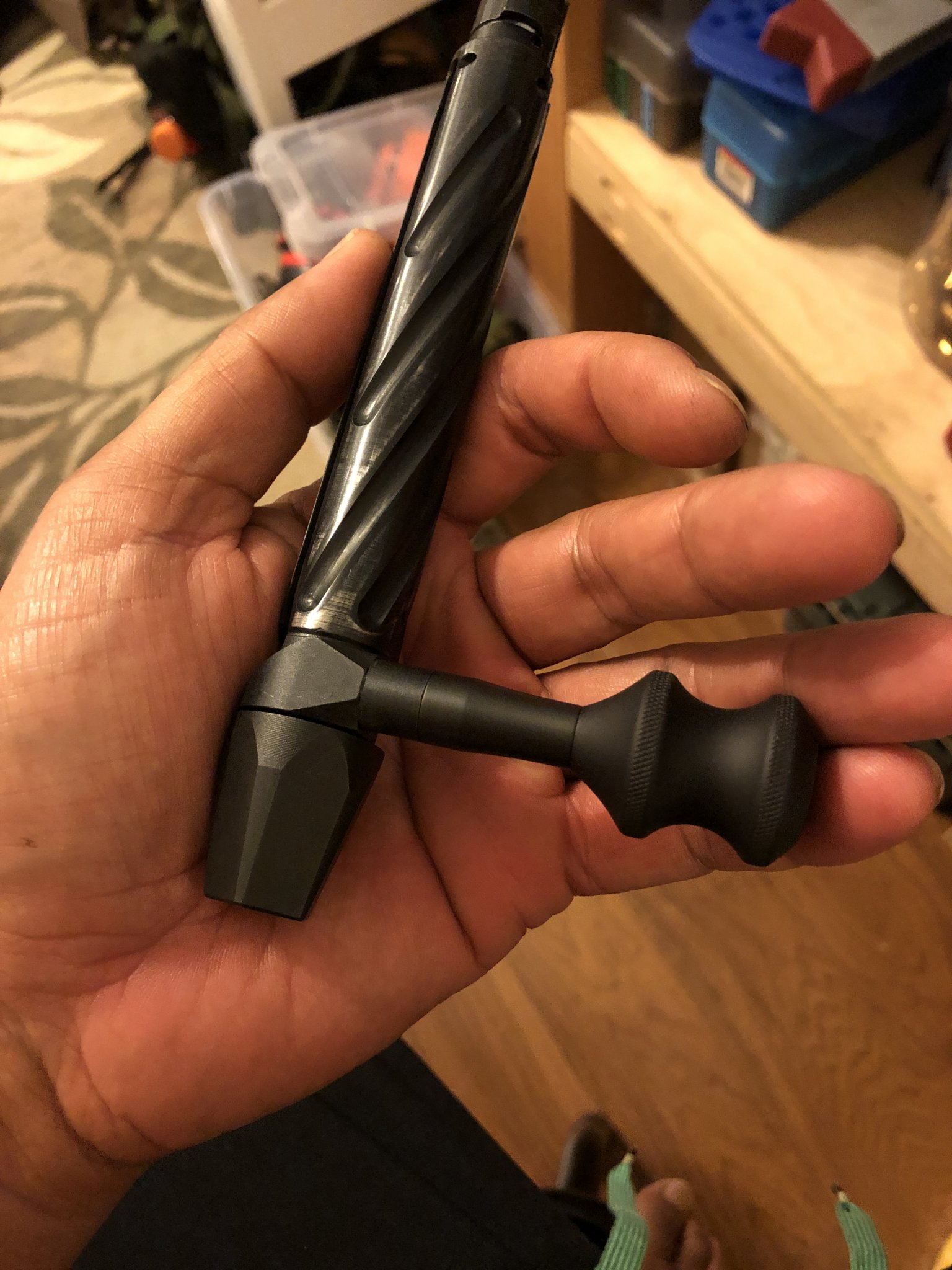

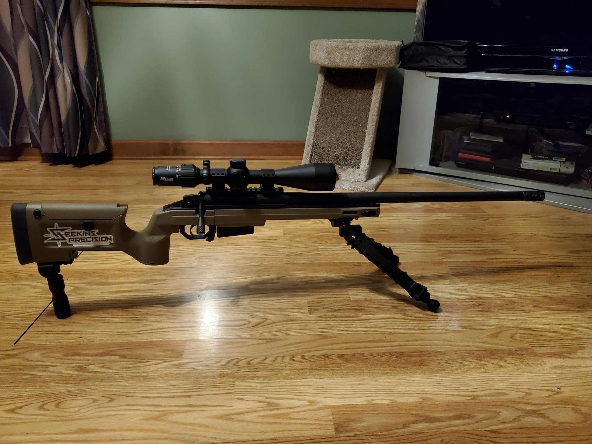

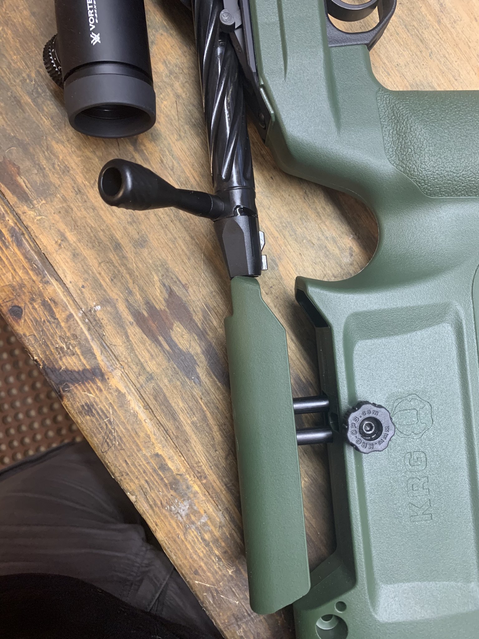

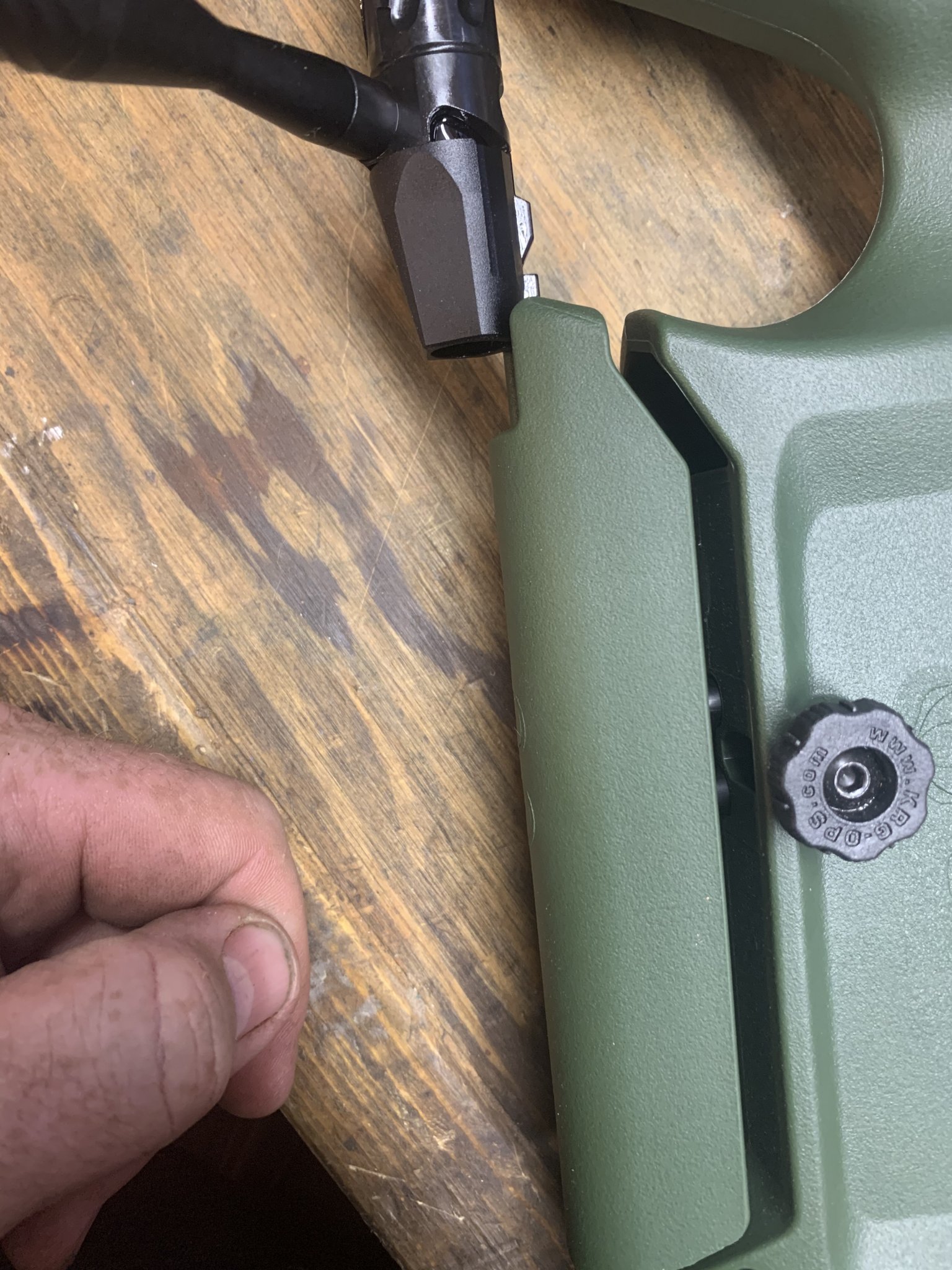

I received my bolt extension from @Mississippi327. Took a little bit of heat and a pliers to get the old one off. Cleaned up the red loctite and then secured the new extension and knob. It’s perfect. The added length really gives it a better feel cycling and the two tone look rocks.
Thanks again! View attachment 7019518
How hard and how much heat did you have to use to remove the bolt Handle? Did you end up damaging the orginal bolt with pliers to get off.

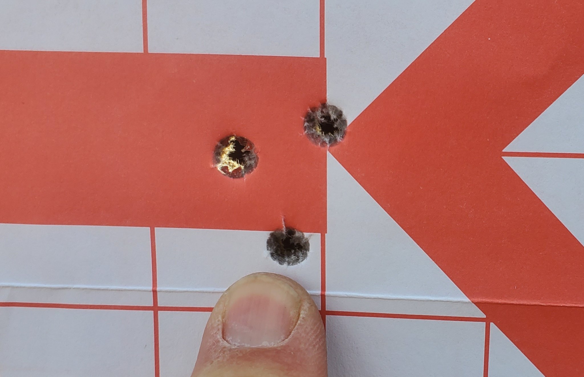

Ok shoot it today, rainy range day but I manage to Zero the scope. Those are my last 3 shots on the target, rain was coming down pretty hard.
What you guys think.
No break in just took out of the box and went to shoot. I ruin my chronograph it got soak. Lol I'm probably get a lab radar.
100 yard zero
Hornady 143 eldx hunter
Bypod shoot and monopod.
Sig sauer 6.5X20x52mm BDX System
Bypod is Accutec-tac
Reactions: Genin and TheChief
Not very much torque really but having the bolt held secure is the key. I used a v block and a leather liner to hold the bolt. Then heat with torch until hot, around 500 degrees or so to break down threadlocker. As it gets hot then start slowly apply torque. Again not much torque really just waiting for the bond to release. Once it does you’ll feel it and it will start to loosen. Wasn’t too bad again just make sure you’re holding the bolt securing it so it won’t spin.
Reactions: scale
Thanks I did pretty much the same stayed under 400 degrees so not to alter the finish on the bolt. I held the bolt with thick rubber from my dive belt in a vise and used leather on the knob with a plier. once the loctite broke down the knob was easy to come off. I replaced the shank part with one from area 419 and their bolt too. gave the prefect amount of extension about .25" longer than the seeking on.
@scale which adapter did you order from Area 419? The only ones I see are for either a Bighorn or Defiance.
