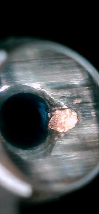

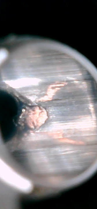

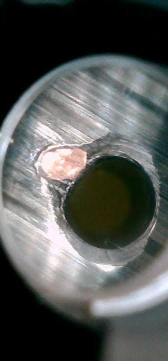

It was a exceptional shooter, consistently printing at .3-5 but it developed a catastrophic Burr at the gasport that was just stripping the copper jackets. I had it examined by cradock and a third party and both said that it was unrepairable so Craddock refunded me and that's right as the barrel supply line dried up so I never got a new one from Craddock, it had nothing to do with the barrel work just shit luck. I currently have two 6.5CM Bartlein being spun up by CLE one for the Seekins and the other for a Brand New LaRue OBR project.

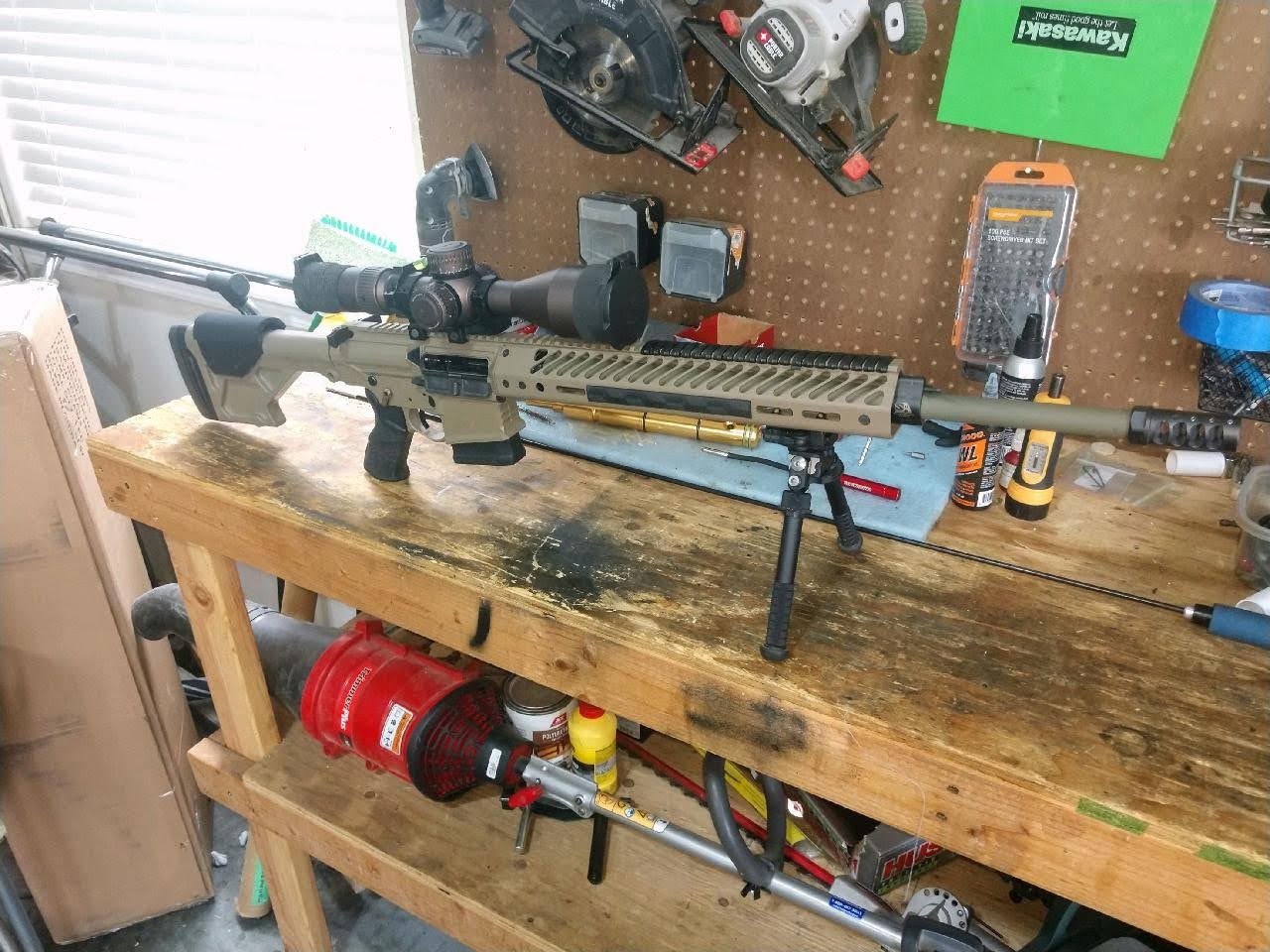

View attachment 7878291View attachment 7878292
I have cleaning patches getting resistance at the gas block area and I wonder if I have this to look forward too. The barrel is none of the ones mentioned in this thread

What scope it that, that is a nice view.

How many rounds down the pipe? Ive had a couple do that, and the burr at the gas port was gone after the first trip to the range.
0 so far. Got called out to work but I hope to put some through it in the next few weeks. I was hoping it just needed some break in, so I’m glad to hear that was your end result

That's fairly minimal erosion. How many rounds on the barrel? How did it shoot after burr developed?
I just pulled my Bartlien after 2k+ rounds. It was still shooting but I ran out of bullets and switched to 6mm. My gas port erosion was more than double the diameter of gas port, but did not shave copper like that.
It was close to 200rds I think, it opened up over 2 MOA. But I didn't keep pumping rounds down it once I found issue, it was pretty clear the barrel was done.
