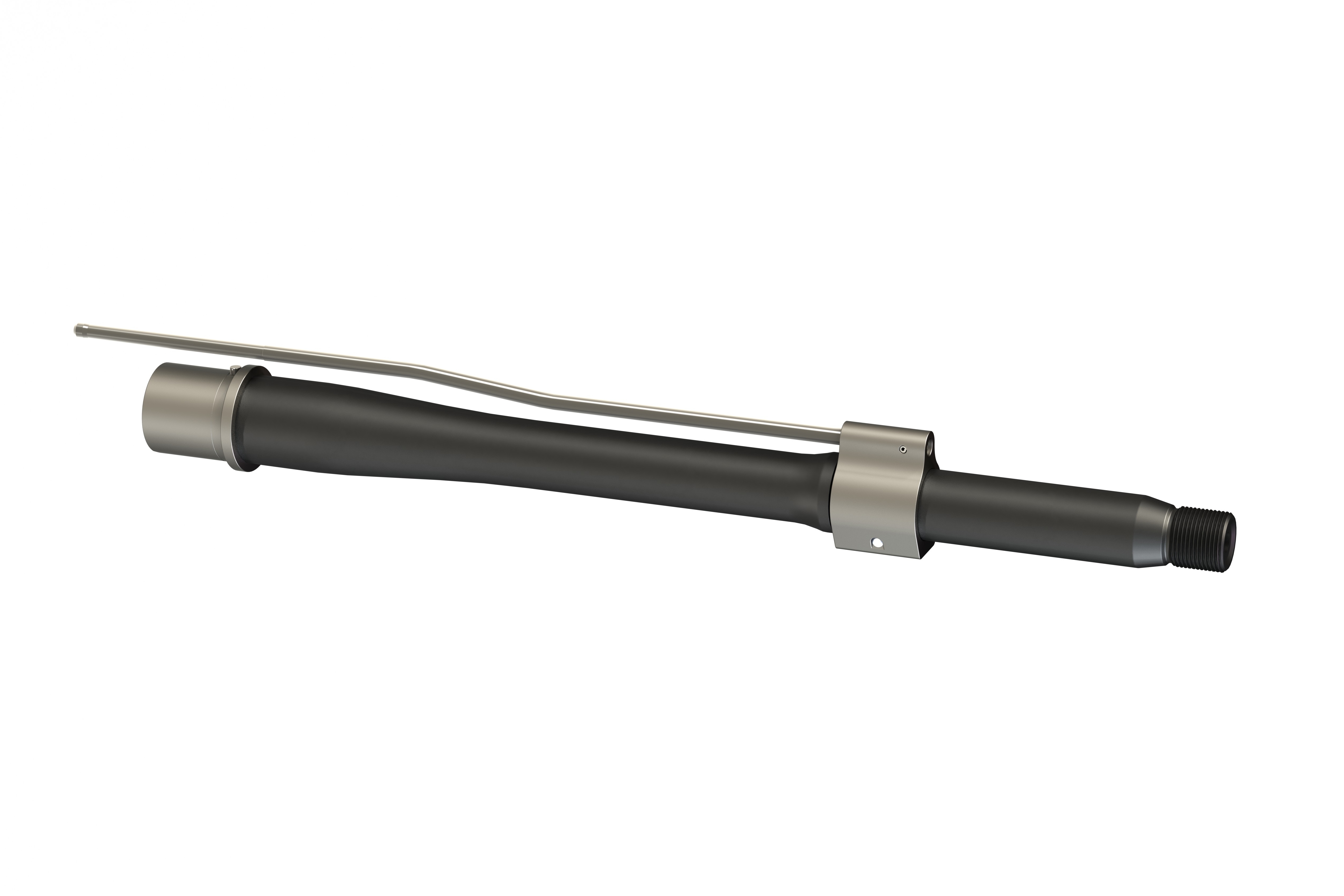

You didn't ask but I am going to say it: Buy a small gas port barrel. Black River Tactical sells 100% suppressed barrels but they cost a pretty penny.
And watch out, one of the suppressed 11.5" barrels comes with 5/8 threads:
I think Sionics also sells suppressor only barrels.
Actually have a Black River barreled 12.5" upper incoming. It is NOT a suppressor only barrel, but has a smaller port. I am going to try both an LMT e-carrier and the Bootleg adjustable BCG, see whats what. Its going to be my mini-recce but the only other suppressor I have is a 9.25" Ti monster... going to be a musket...
