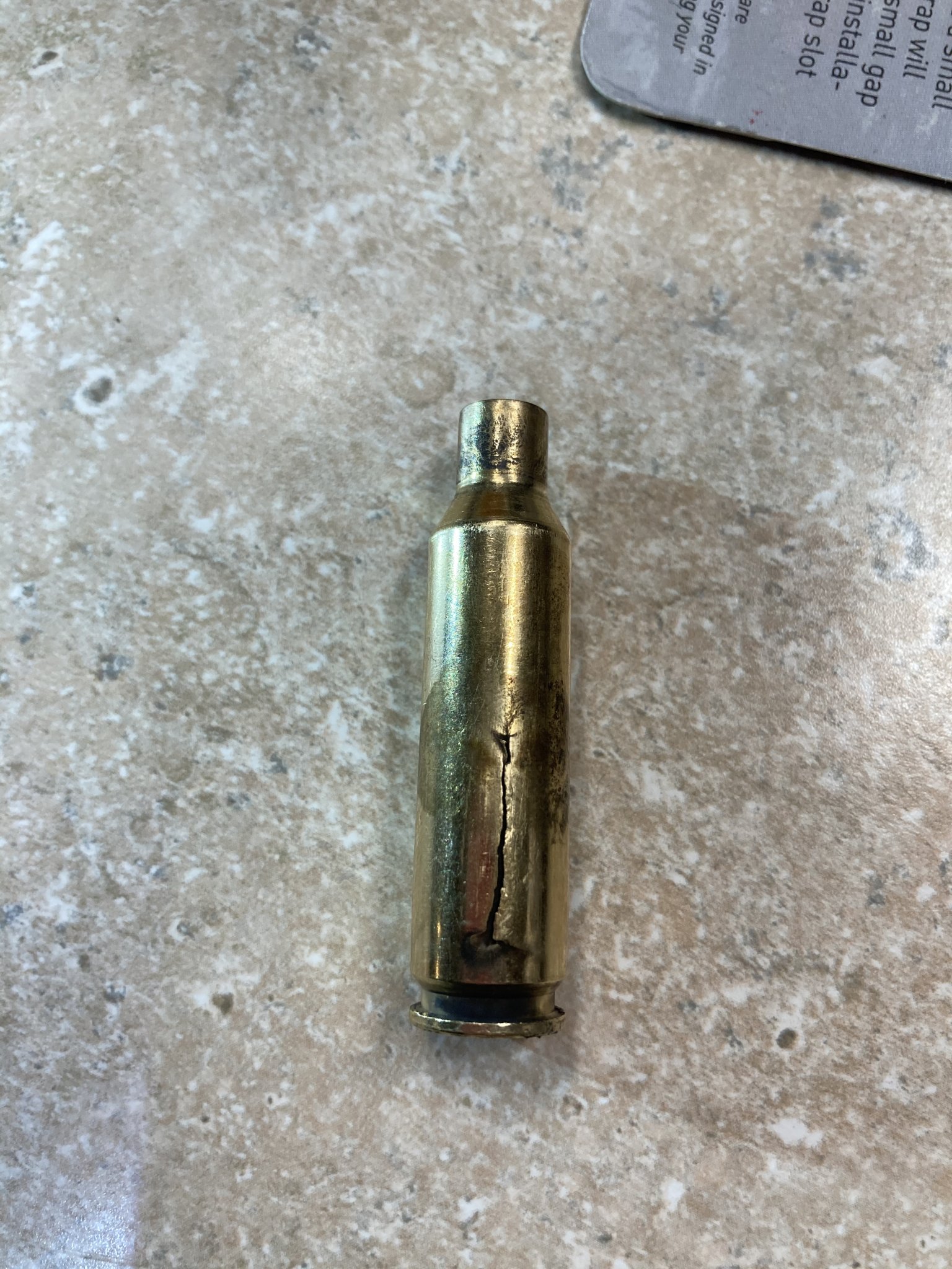

    Shot some S&B and American Gunner 6.5 CM today. The S&B is giving me pressure signs in my Savage 10/110 BA Stealth LH. Very Heavy bolt lift, flat primers. I had to really whack the handle on the last shot i took. Only ran 7 of the S&B. Brand new gun. Didn’t have any problems with the Hornady. Sucks because the S&B was shooting very well. No idea what to do with it.

    I bought (2) boxes of that S&B 6.5CM Ammo about a month ago at a local store. Shot 5 rds of it and as someone else stated above, sticky/heavy bolt lift, crappy accuracy, etc... it was a waste of $25 IMO. I’d stick to the Hornady American Gunner all day long!

    Pressure problems in a buddy's rifle. Lots of reviews on the interweb saying the same. Not saying yours will but.... where there's smoke, .... I just can't see shooting junk ammo, a guy would be $ ahead to "play" with a 223.
    I used it and I found out it is loaded on the hot side as in my savage 10 didn’t like it at all it didn’t want to extract and not accurate

    The S&B also produced flat primers and had very sticky and heavy bolt lift as well

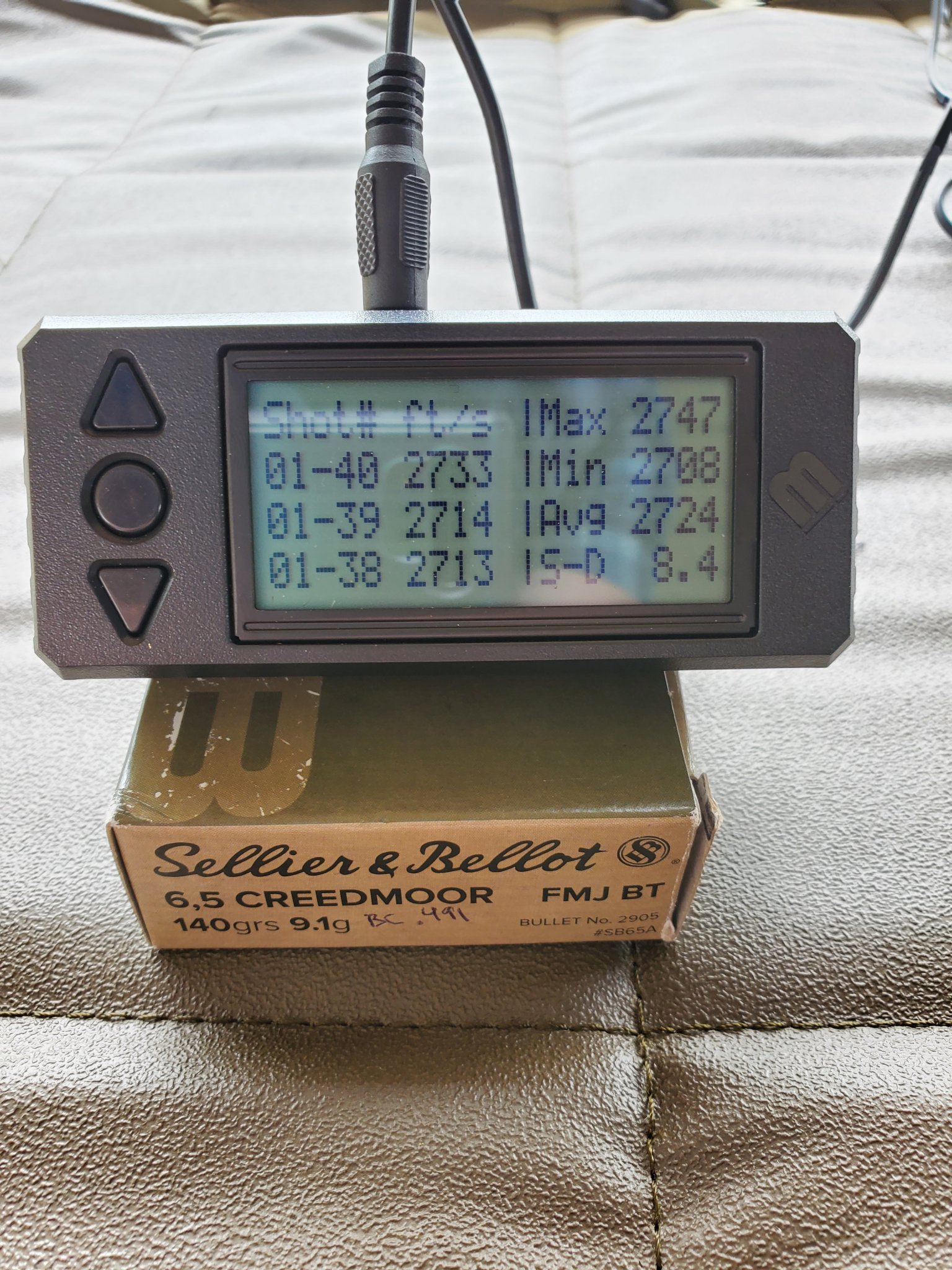

    My experience with the S&B 140 Boat Tail ammo out of my Cadex Gaurdian Lite 6.5CM, factory 24 inch barrel.
    2765
    2672
    2704
    2726
    2688
    2777
    2704
    2699
    2726
    2743
    Easily produced sub MOA 5 shot groups (some .5 and none above .87) from 100 to 500 meters 60 degree, 10mph wind, 880 feet above sea level, low humidity. Shot 100 rounds with an Atlas Bipod, rear monopod, MK5 3.5-18 T3 and SIlencerco Omega. Hornady ELD Match 147 was a bit slower but the better BC made POI very close past 300 meters. That was all half moa or better if I did my part.

    100fps velocity spreads doesn't inspire confidence, and will have major effects on accuracy at long range.
    For that reason the S&B ammo is a hard pass.
