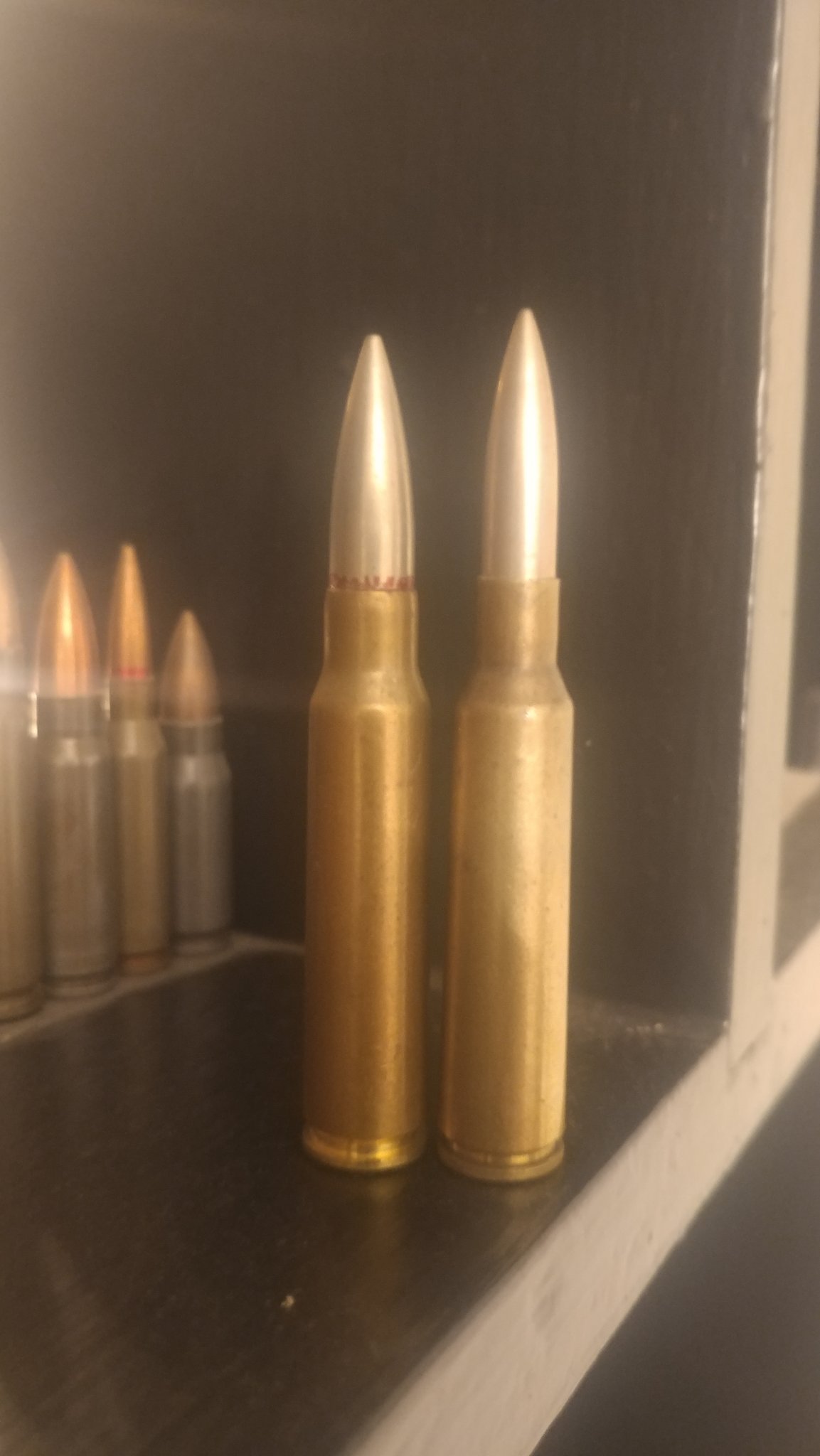

Now I'm curious. If I remember the next time I'm in the safe I'll see how well a mag holds 6.5x55. I think all the loaded and I've got is long AF OAL though. Might not fit.
Just tried a couple surplus 6.5x55 in my MAS 36 magazine, they just barely fit lengthwise. Boltface and extractor actually seem to work decent, maybe not in a semi auto though. If I remember I'll try some 6.5 in my bro's 49/56 mag tomorrow.
All my loaded ammo is too long so I took a fired case, pushed a 140 BTHP in by hand and loaded it into the 49/56 mag. It will feed, chamber, and eject.
