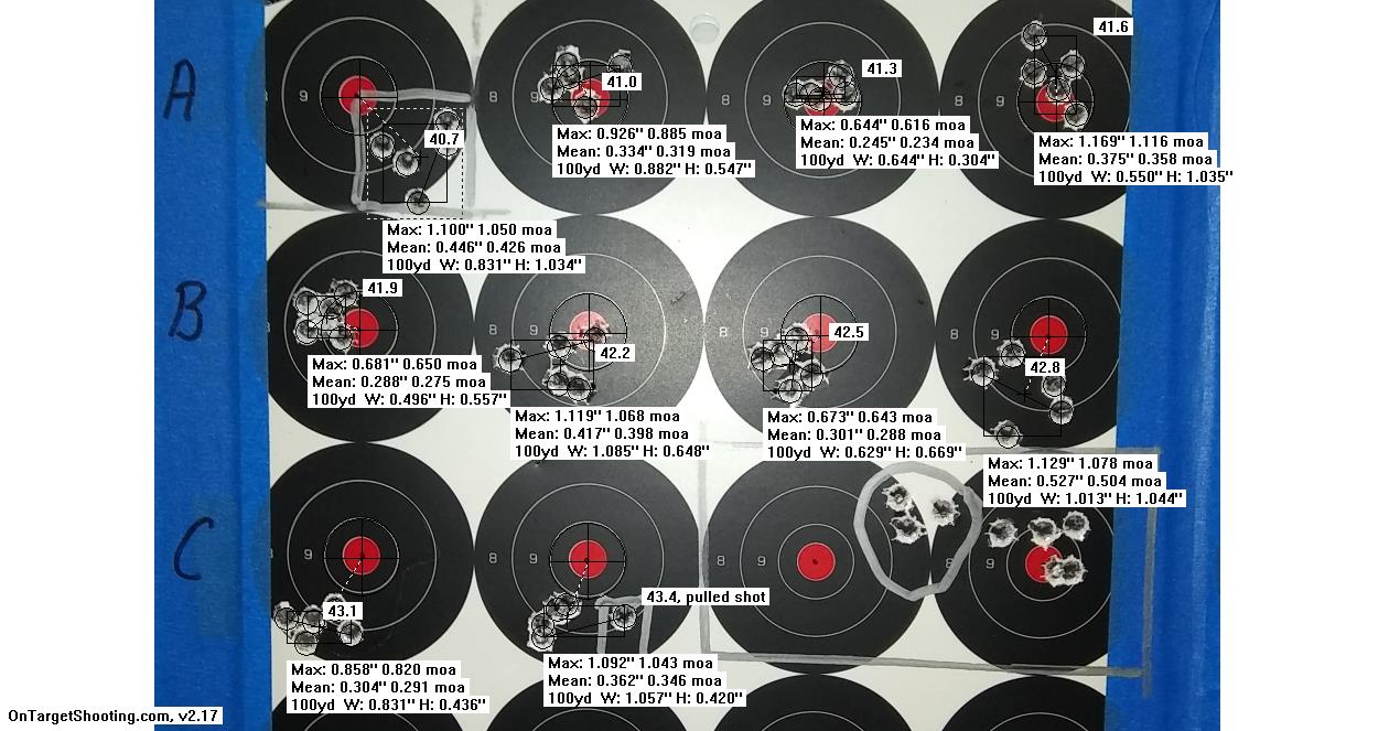

Lesson learned with the Lapua. I switched from a brand I thought would be a ‘win’ (but I won’t name it) due to what I considered surprising variances in both length and weight: Even once fired cases were 1.983” to 2.013”. I culled the sub 2”, and then only kept the brass that was within a 14 gr weight spread, netting 86 out of 200. Expensive education…. Yea, so I now have 202 Lapuas; OAL +/- .001”, weights within 2 gr. Coinciding with this, I started using Sierra 165 SPBT’s. New brass yielded occasional .8s, and once fired gave three .6s out of (10) 5 shot groups during OCW test. It could have been more if I wasn’t so damned incompetent-That’s the jpg. The PDF breaks down the poi shift between weights for node info. 1st time adding files, hope it works.
  • data eval.pdf
41.3 and tweak seating depth. You can see that both 41 and 41.6 have almost the exact same poi as 41.3 so that is a node. The next step is to adjust seating depth. I prefer small increases like .002" or .003". Load up maybe .015-.020" worth of movement (5-8 loads) and look for the smallest group.
