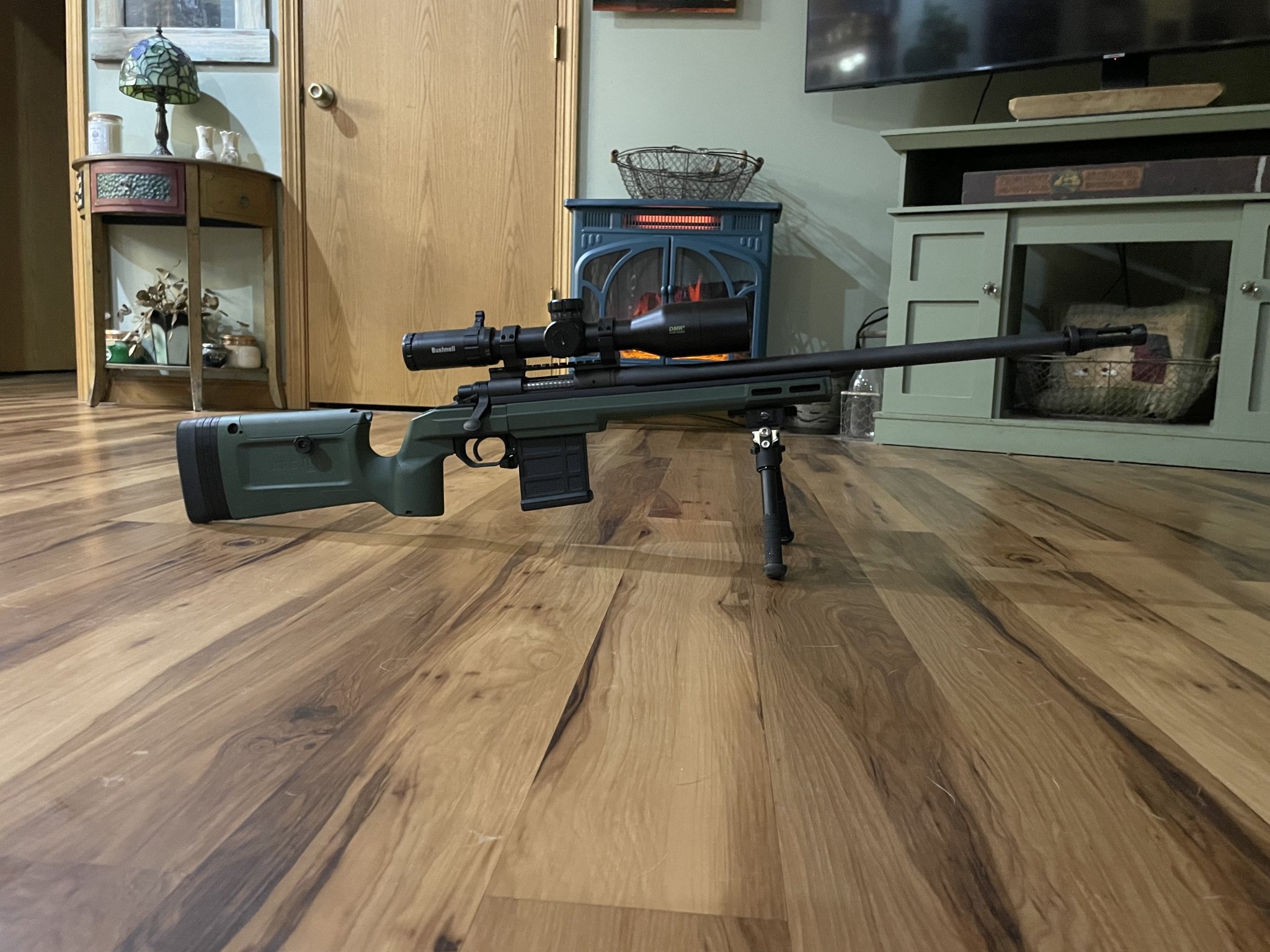

I have a 700 short action 308 in a krg bravo stock . It's about as easy as it get's . I picked up mag-pul AICS magazines at academy for around 35.00 . I think you will be happy with the chassis . I also used it on a 6.5 creedmoor Remington 700 that use the remage barrel nut no problem at all .
